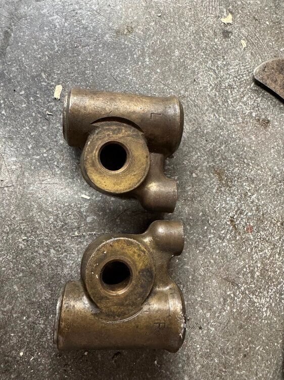

New approach:
with the new (used) vertical Link came a "funny" trunion, we discussed that in another thread.
Ist that the reason?
