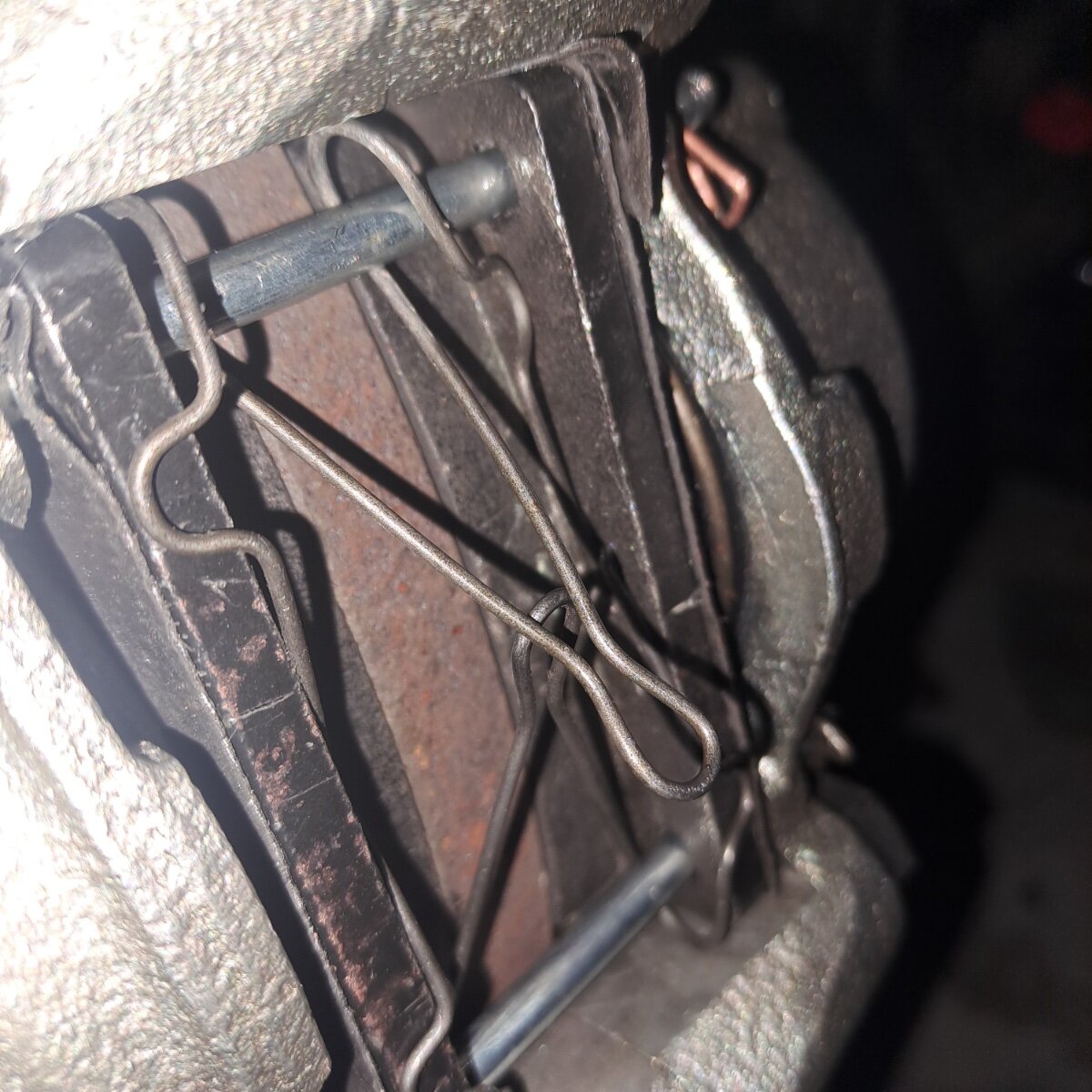

Casar66 Posted June 17, 2025 Author Report Posted June 17, 2025 Another Idea: Do any of you also have the late brake calipers with the 3/16" pins and possibly a detailed photo? Maybe the holes for the pins are too big for me? Quote
JohnC Posted June 18, 2025 Report Posted June 18, 2025 You may be onto something here. The holes in the calipers, the pins, and the holes in the pads should all be the same size. If not, there will be movement. Could you possibly have the wrong size pins for the calipers? Of course that would mean you have early (Imperial) 16PB calipers which have holes for 1/4” pins, but are using 3/16” pins suited for late (Metric) M16P calipers (and I note you imply you have M16P). Or that the pad holes are for early pins but you have late caliper and pins (the photo is too blurred to tell). Cheers, JC Quote

jerrytr5 Posted June 18, 2025 Report Posted June 18, 2025 18 hours ago, Casar66 said: But now I can always provoke it: I have to reverse first, not much, one meter is enough, then brake, then forward again and it clunks. Sounds like the pads are a very sloppy fit in the caliper. Your photo shows a very clean caliper. What it needs is a bit of corrosion & brake dust! Try jamming the pads in with small bits of wood (not on the road of course) & repeat the test. Jerry Quote

Casar66 Posted June 18, 2025 Author Report Posted June 18, 2025 3 hours ago, JohnC said: You may be onto something here. The holes in the calipers, the pins, and the holes in the pads should all be the same size. If not, there will be movement. Could you possibly have the wrong size pins for the calipers? Of course that would mean you have early (Imperial) 16PB calipers which have holes for 1/4” pins, but are using 3/16” pins suited for late (Metric) M16P calipers (and I note you imply you have M16P). Or that the pad holes are for early pins but you have late caliper and pins (the photo is too blurred to tell). Cheers, JC It should be all M16P stuff, the 3/16pin, the caliper and the pads. But I was wondering why is that much play nearly everywhere. The pins in the caliper are more or less loose, I can pull them out by Hand. Same with the pads, they are wider than the pins in any way. Yesterday I put some rubber hose from a fishtank over the pins so that there is no play with the pads. No change. Quote
