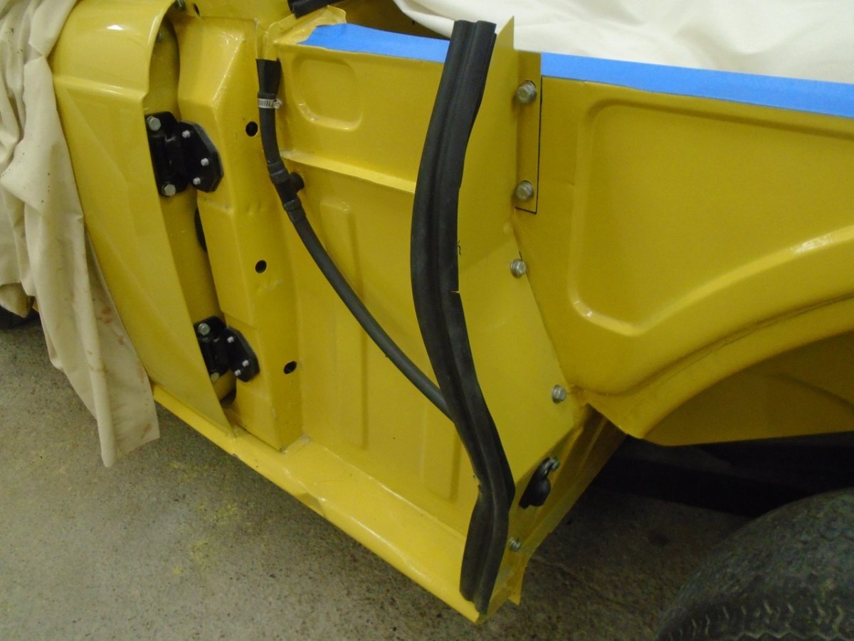

harlequin Posted July 15, 2025 Report Posted July 15, 2025 It sounds as if you have been extremely through in trying to track down your clunk but just as a thought have you looked behind the baffle plates behind the front wheels, the plates that close the void between inner and outer wings, maybe there is somthing like an old radio antenna or a spanner that has been forgotten about in there? George Quote
Casar66 Posted July 15, 2025 Author Report Posted July 15, 2025 No, I haven't. What is that baffle-plate and where to find it? would you please show me with a foto or an illustration from the catalogs of Moss or Rimmer? Many thanks Cas Quote
harlequin Posted July 15, 2025 Report Posted July 15, 2025 Here you go. It's the plate with the rubber seal around the edge and the drain pipe passing through it. The photo is copied from Ed Hollingsworth's excellent Bulfire website. (I hope you don't mind Ed) George Quote
Casar66 Posted July 15, 2025 Author Report Posted July 15, 2025 Thank you! I have never noticed that the panel is not welded to the body. Is it riveted? Quote
harlequin Posted July 15, 2025 Report Posted July 15, 2025 No not rivets its held inplace by the bolts you can see in Ed's photo, going from memory I believe they have a self tapping type thread that screws into thackeray washers. I remove the baffles every few years or so to squirt waxoyl in the voids. The plates are available in stainless if you find yours are tatty George Quote

stuart Posted July 15, 2025 Report Posted July 15, 2025 32 minutes ago, harlequin said: No not rivets its held inplace by the bolts you can see in Ed's photo, going from memory I believe they have a self tapping type thread that screws into thackeray washers. I remove the baffles every few years or so to squirt waxoyl in the voids. The plates are available in stainless if you find yours are tatty George No theyre bolted into captives welded on the outer edge of the kick panel, 1/4" UNF nuts. Stuart. Quote

harlequin Posted July 15, 2025 Report Posted July 15, 2025 58 minutes ago, Casar66 said: I will have a look tomorrow. I think, my ones are riveted by the former restoror 35 years ago. Good luck, I hope you don't find any nastiness in there after 35 years It may be worth fitting the plenum drain tube modification as shown in Ed's photo while you have the baffle plates off along with a good dose of waxoyl or similar G Quote
