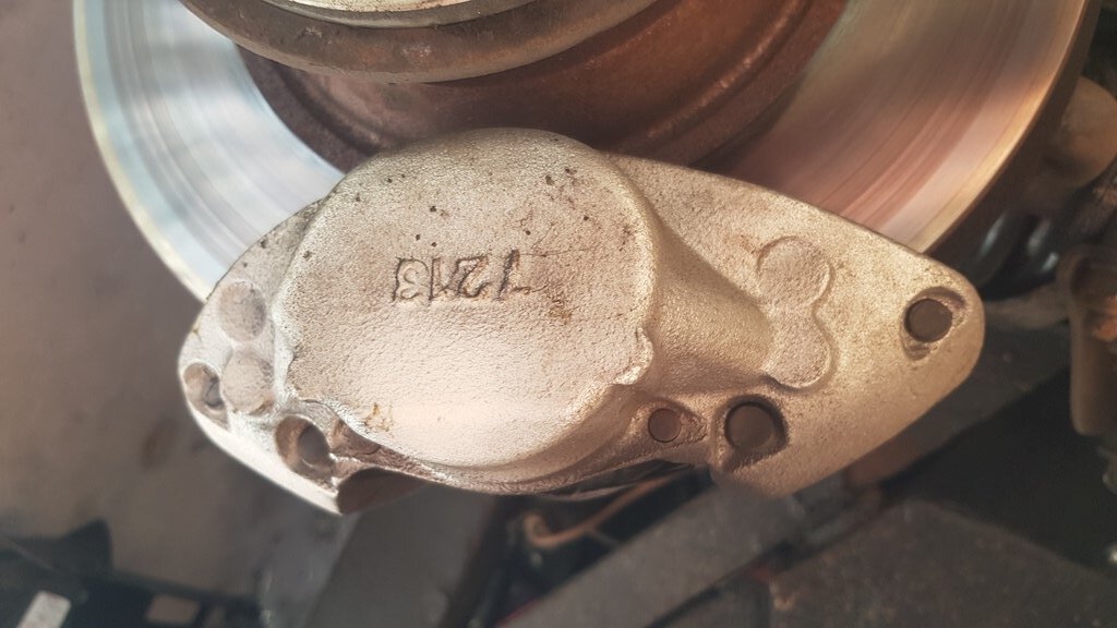

Besalu Posted September 6 Report Posted September 6 Yesterday i had a front brake disc seize while driving. Luckily i was very close to home and no damage done. So i have been looking at various threads about calipers and discs and i am thinking of having the calipers rebuilt. however it seems the calipers i have in there now are not original (not surprised tbh). Can anyone help identify these for me? Stamped number 7213 and on the reverse the numbers SD2213 151218 After reading Stuart's advice about keeping original calipers i was thinking of getting a quote from a company such as BiggRed. Has anyone used them or can anyone give me some alternative suggestions of companies that do this work? It seems the Hawk discs the best option? Thanks in advance for any help or guidance, Richard Quote
stuart Posted September 6 Report Posted September 6 Cheaper to buy a pair of new calipers from TR Shop, about £120 the pair Stuart Quote
BlueTR3A-5EKT Posted September 6 Report Posted September 6 Repro 16P calipers are even cheaper from MGOC. Also fits Ford and MGC https://www.mgocspares.co.uk/product/34284/m16-brake-caliper-lh-cast-steel Quote
Nigel C Posted September 6 Report Posted September 6 am I right in thinking you can use Ford Escort and just "tickle" the pin holes? Quote
BlueTR3A-5EKT Posted September 6 Report Posted September 6 Yes if the pads are for the later calipers using 3/16” pins. Quote
harrytr5 Posted September 6 Report Posted September 6 I much prefer original calipers fully rebuilt by past parts. Big Red do not do them any more. The repro calipers I found the difficult to bleed but found a way in the end. Give me original every day. Regards Harry Quote
