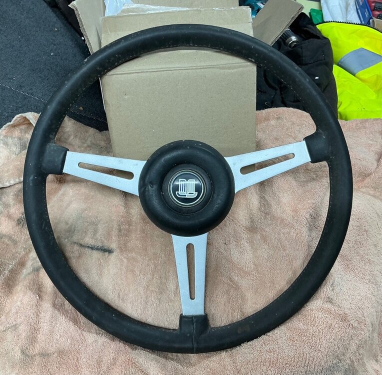

TR NIALL Posted July 11, 2025 Report Posted July 11, 2025 29 minutes ago, Macleesh said: Thanks Stuart So this would be correct? https://www.ebay.co.uk/itm/116148292121 The listing is a bit contradictory regarding chassis no.s Thanks Sean This is a 1971 and 15” original to TR6. Quote

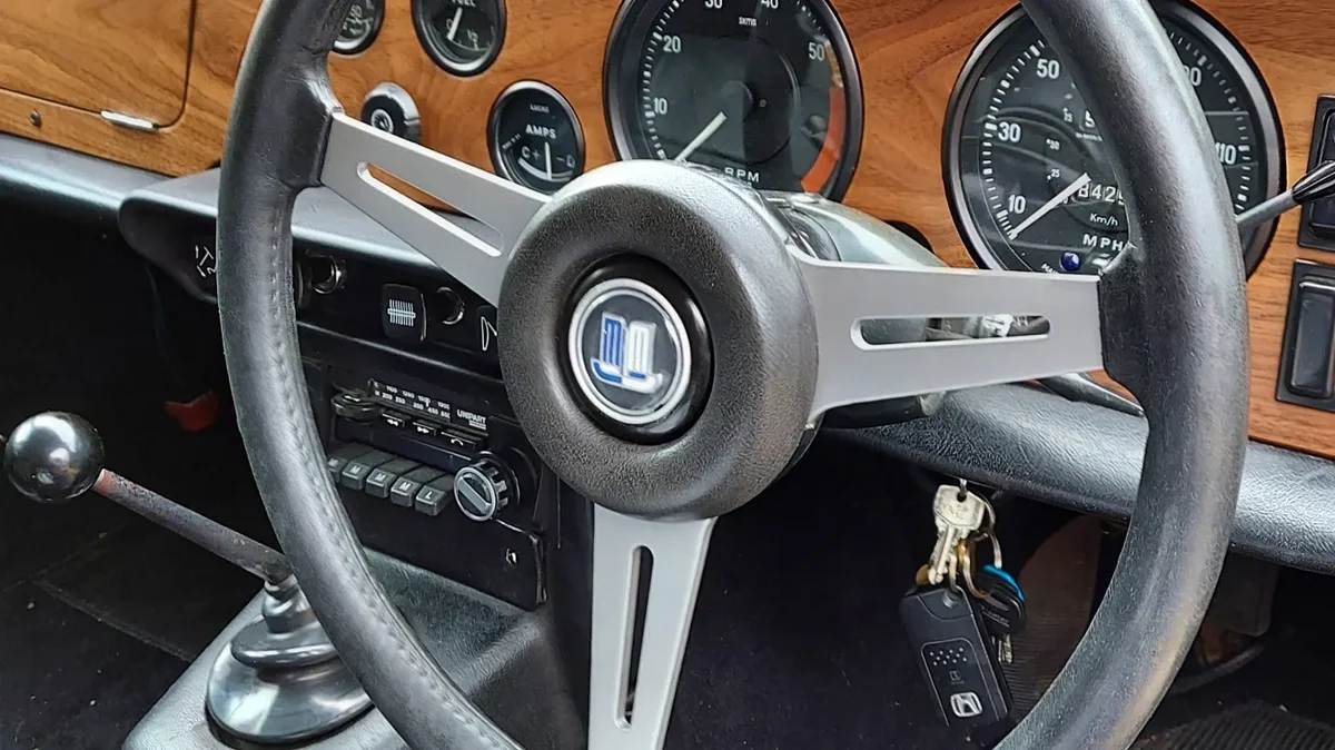

Waldi Posted July 11, 2025 Report Posted July 11, 2025 I have the same wheel as Niall above, with the “round” donut, both are correct for CP cars. The later (CR) cars had a different donut. Waldi Quote

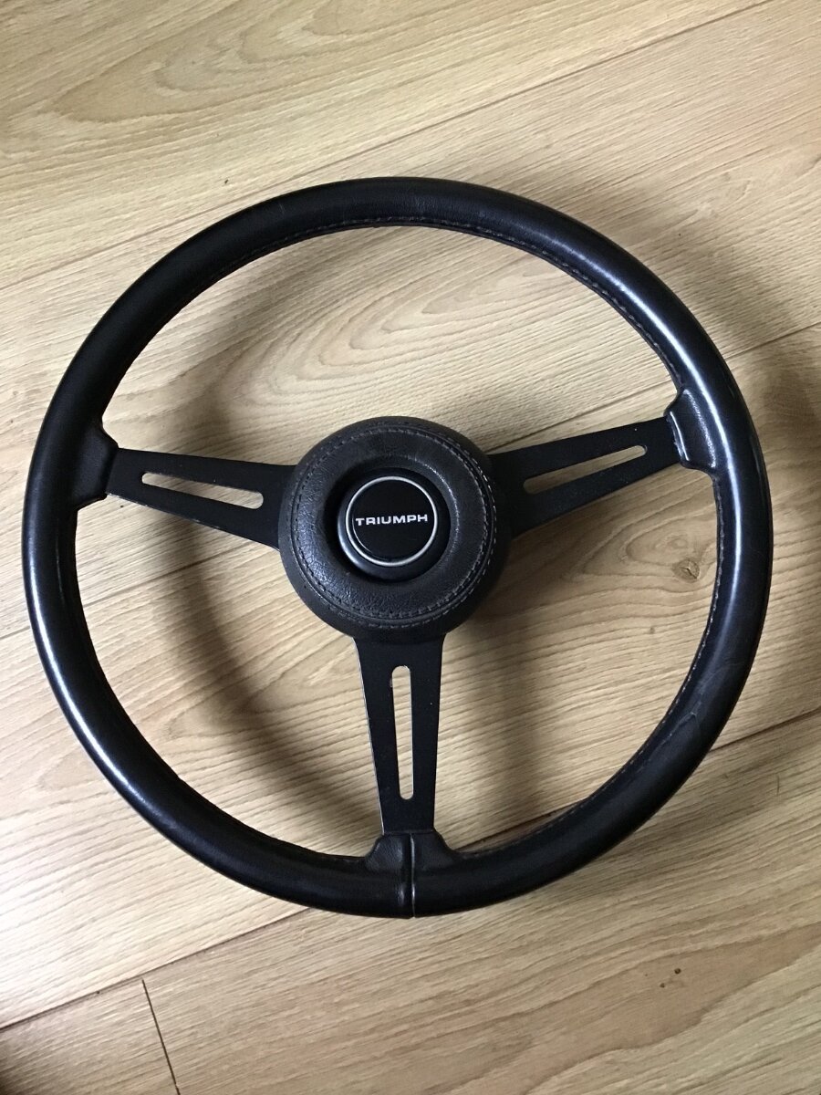

TR NIALL Posted July 11, 2025 Report Posted July 11, 2025 (edited) 1976 Original Spitfire 1500 this is 14.5” and feels slightly thicker on the Outer Rim you’ll also notice the difference on the Horn Centre. Edited July 11, 2025 by TR NIALL Quote

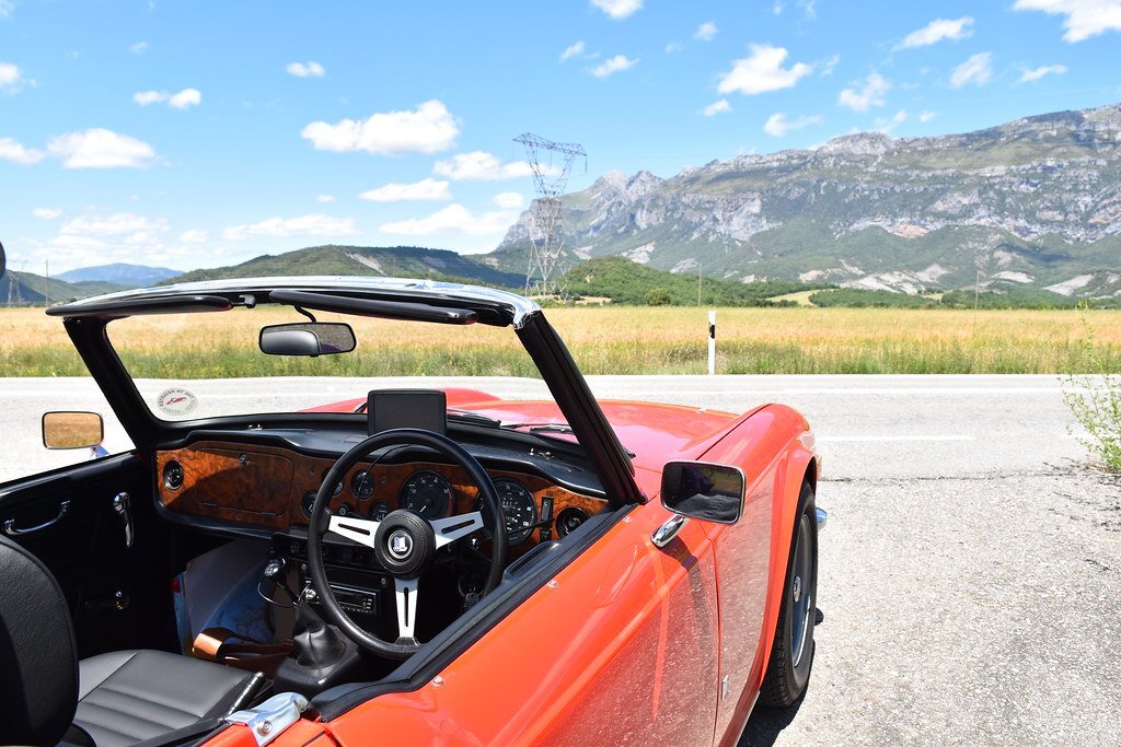

Andrew Smith Posted July 17, 2025 Report Posted July 17, 2025 (edited) On 7/11/2025 at 10:29 AM, Macleesh said: My car came with a Moto-Lita steering wheel but I'm not a fan and would like to source an original Triumph item but I'm not sure exactly what version that is, I've seen black and silver versions, and versions with holes and slots. Would someone be able to advise what version is correct for a 1970 CP51xxx car? Thanks Sean Unless you're into originality at all costs, buy the later 14.5" CR one as it's much nicer to drive with as it's thicker and softer padded than the 15" CP which is too thin and hard. Here's my 72 CP with the CR wheel fitted. Cheers, Andrew Edited July 17, 2025 by Andrew Smith Quote

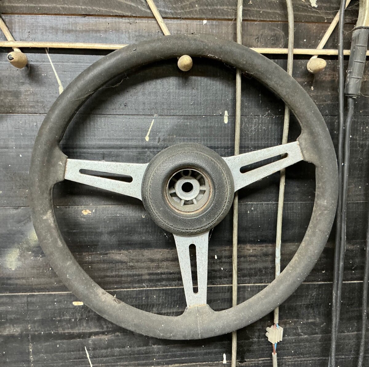

Jon C Posted July 22, 2025 Report Posted July 22, 2025 Hi I have this one, which came with my 1972 CP model. I actually swapped it for a Mota Lita, preferring a thicker rim. It appears to be 14.5” diameter, so not sure if this is the right wheel for my car, or even for a 1970 model. Can any one identify it for me? Has a previous owner painted the spokes? Many thanks. Jon Quote
Mk2 Chopper Posted July 22, 2025 Report Posted July 22, 2025 (edited) 3 hours ago, Jon C said: Hi I have this one, which came with my 1972 CP model. I actually swapped it for a Mota Lita, preferring a thicker rim. It appears to be 14.5” diameter, so not sure if this is the right wheel for my car, or even for a 1970 model. Can any one identify it for me? Has a previous owner painted the spokes? Many thanks. Jon That's the later wheel, CR version, it's probably been repainted. I know earlier 15" wheels came in black on US cars not sure if that applies to the CR version of a US car. I also fitted the later CR version in my 1970, but I put the early padding and horn push on it. Gareth Edited July 22, 2025 by Mk2 Chopper Quote
