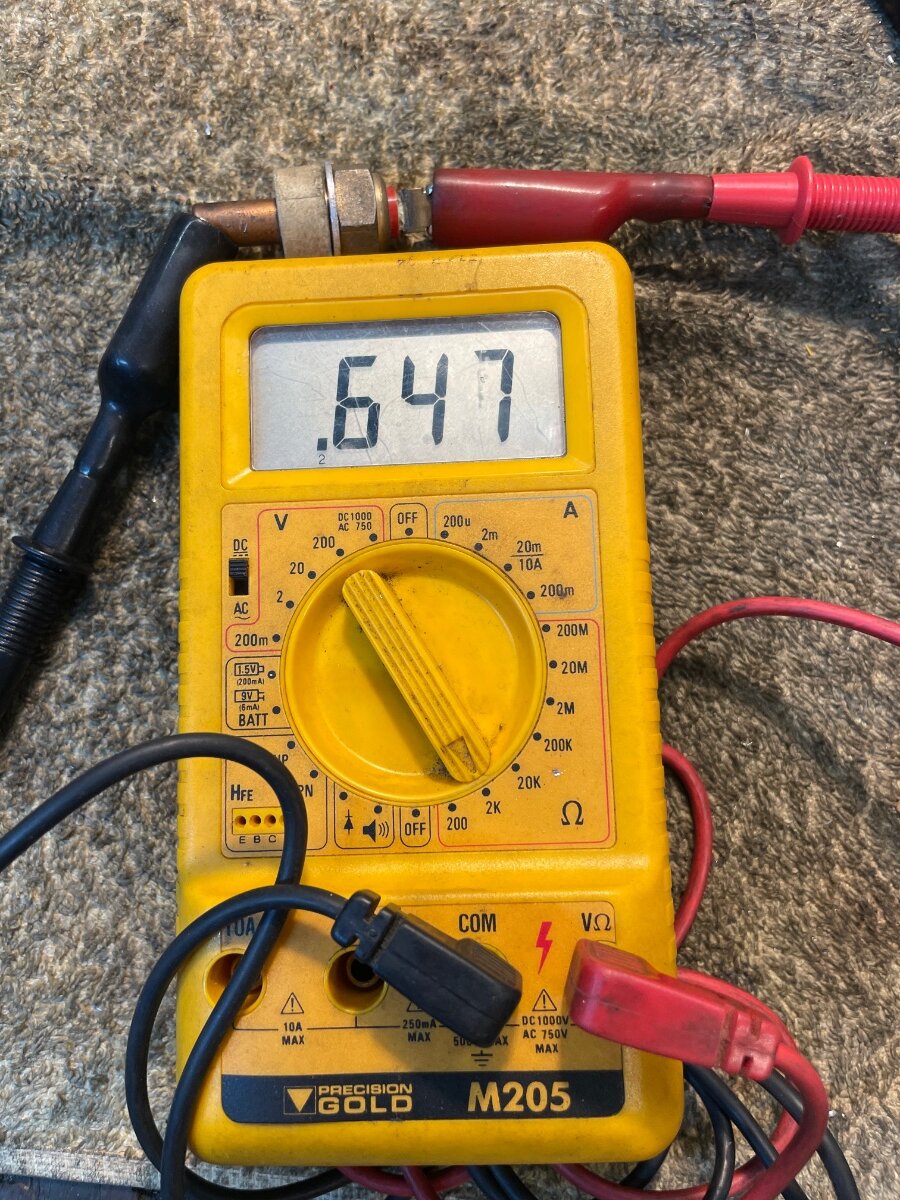

BlueTR3A-5EKT Posted August 9, 2025 Report Posted August 9, 2025 (edited) I have a what I believe to be a NOS Smiths sender unit for a TR4. it reads as follows at 28°c ambient in the garage. Edited August 9, 2025 by BlueTR3A-5EKT Quote

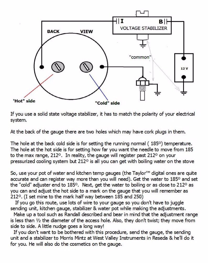

RobH Posted August 11, 2025 Report Posted August 11, 2025 (edited) Calibrating Smiths electric TR4 Temp gauge - by Peter Sherman ......... The two slotted adjusters don't turn like screws - they sort of slide sideways. Edited August 11, 2025 by RobH Quote
RogerH Posted August 11, 2025 Author Report Posted August 11, 2025 Thanks Rob That's tomorrow sorted Roger Quote
Lebro Posted August 11, 2025 Report Posted August 11, 2025 The adustment is not easy to do smoothly, the levers inside tend to be quite stiff, & want to move in jerks, the slots into which to insert the adjustment tool (usualy a screwdriver) are oval, rather than being slots, so not very friendly to use, however go slow & carefully & you should be ok. The third thing you can adjust is the angle of the needle by gently bending the base of it. Bob Quote
