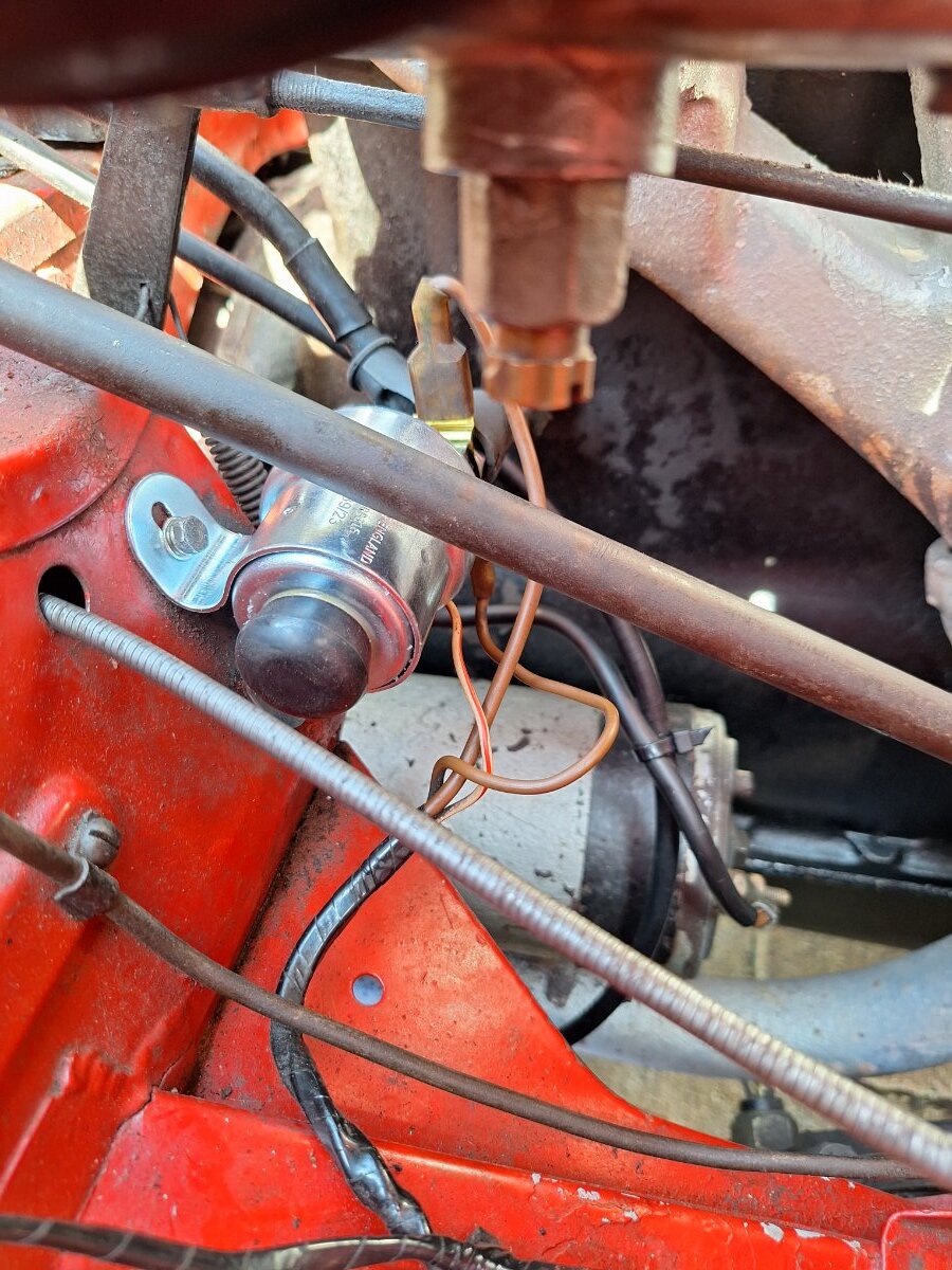

R1ceman Posted August 11, 2025 Report Posted August 11, 2025 Yesterday my TR4 (+ earth) failed to start. Cable from the solenoid to starter motor was extremely hot and the wire from battery terminal to bulkhead was smoking. Concensus amo got the group present was that my starter motor was shot. A push start got me going and managed to get home without any issues. So today I will be removing the old part and possible getting it refurbished. I'm also toying with the idea of upgrading to a high torque version but have seen some bad reports rgds WOSP models. Any recommendations gratefully received. Also is removal straight forward or is there anything I need to be aware of before I dive in? Cheers. Andy Quote
R1ceman Posted August 11, 2025 Author Report Posted August 11, 2025 Update. I just pushed the car out of the garage and before disconnecting the battery I thought I would see if the old girl would start and she did. Now I'm unsure what to do 🤔 Quote
R1ceman Posted August 11, 2025 Author Report Posted August 11, 2025 Update. Applying the principles of highly trained RAF technicians, of changing parts until it works, I changed the starter motor solenoid with a spare one I had and bingo it's fixed 👍 Looks like I don't need a starter motor after all. Quote

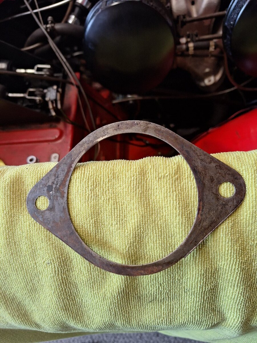

R1ceman Posted August 13, 2025 Author Report Posted August 13, 2025 Hi again, I'm trying to install my new WOSP and have a couple of questions. Forgive me if they are pretty lame but I'm a novice at this kind of thing. 1. Which way up does it go in? I'm assuming that the fixed bolt is at the top But there is a bolt already there. Can this be pushed through as there is little to no access to it? Fitting the nut on would be nigh on impossible which then makes me think it should be the other way round. 2. Do you fit the metal gasket which came off with the old starter motor? Picture attached. 3. If I am connecting the new motor with the cable from my starter solenoid, do I need to attach the small jumper cable supplied with the new motor? All help gratefully received. Now I'm off to have a coffee to help me calm down. Cheers Andy Quote

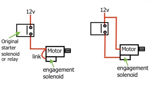

RobH Posted August 13, 2025 Report Posted August 13, 2025 (edited) Probably best to ft it with the solenoid upwards Andy, away from the hot exhaust pipe. If that puts the fixed bolt in the way, it is usually possible to rotate the fixing flange by undoing the retaining screws - in fact with some motors that allows you to index the orientation to the most convenient angle to give best clearance. You probably don't need the spacer ring that the old starter had. In terms of the wiring you have two choices: The first option uses the existing wiring and requires the link you mentioned between the large and small tags. In the second the heavy starter cable goes from the big tag to the battery-side of the original solenoid and you need a new wire from the old solenoid to the small tag on the starter. That wire needs to take up to 40A. Edited August 13, 2025 by RobH Quote
R1ceman Posted August 13, 2025 Author Report Posted August 13, 2025 12 minutes ago, RobH said: Probably best to ft it with the solenoid upwards Andy, away from the hot exhaust pipe. If that puts the fixed bolt in the way, it is usually possible to rotate the fixing flange by undoing the retaining screws - in fact with some motors that allows you to index the orientation to the most convenient angle to give best clearance. You probably don't need the spacer ring that the old starter had. In terms of the wiring you have two choices: The first option uses the existing wiring and requires the link you mentioned between the large and small tags. In the second the heavy starter cable goes from the big tag to the battery-side of the original solenoid and you need a new wire from the old solenoid to the small tag on the starter. That wire needs to take up to 40A. Thanks Rob, that's cleared everything up for me. I just need to find a way of fixing the nut to the fixed bolt. I'm hoping I can get a socket on with a bendy extension ( not sure of the correct terminology) to tighten it up. Quote
james christie Posted August 13, 2025 Report Posted August 13, 2025 (edited) Good advice from RobH on turning the flange through 180°. You can now put a loose bolt through at the top and screw it into a nut that you are holding judiciously in place. You can then get a spanner on the bolt head, as you have already found out, it is impossible to tighten the nut. It is fairly easy to put the nut on the fixed bolt from underneath. I think the metal spacer/ gasket is to adjust the position of the pinion in relation to the toothed ring on the flywheel. james Edited August 13, 2025 by james christie Quote

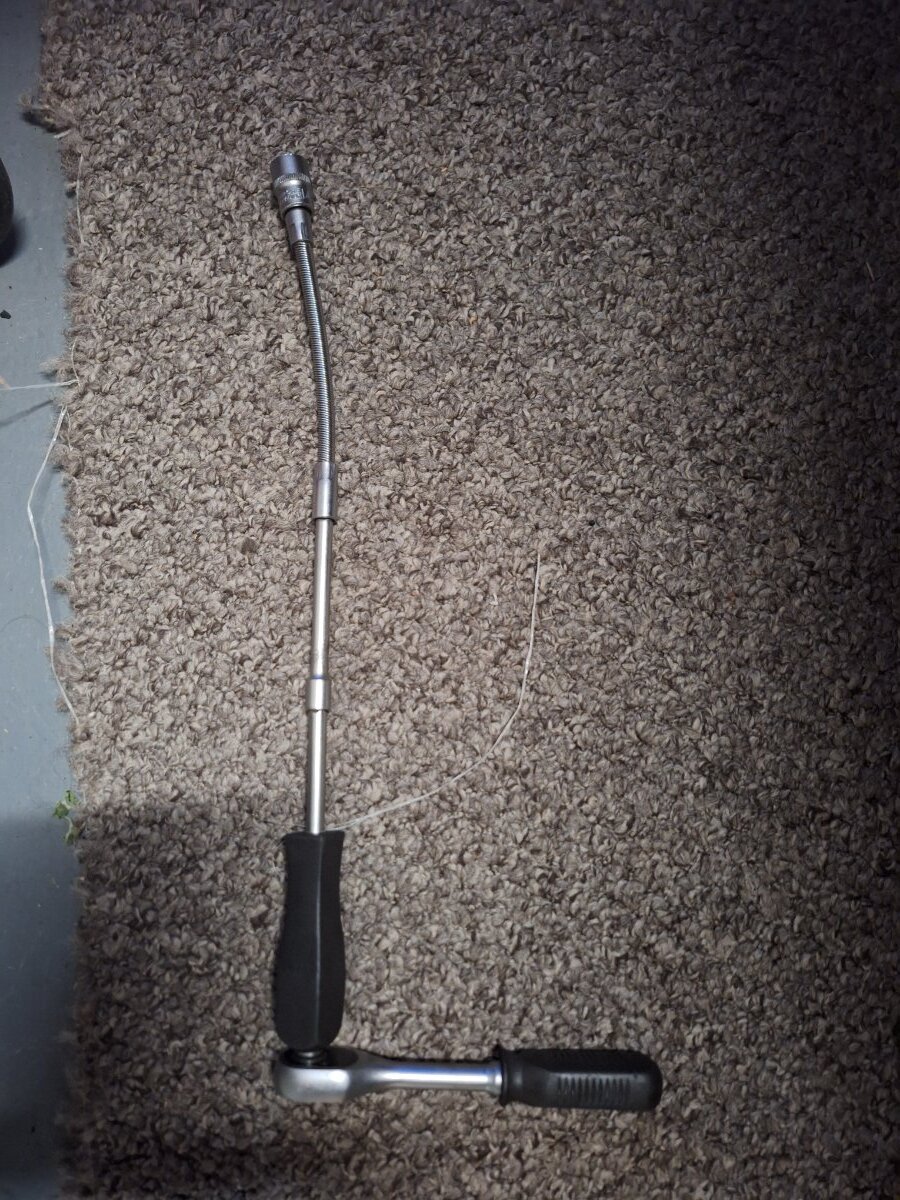

R1ceman Posted August 14, 2025 Author Report Posted August 14, 2025 Update. It's in and working. In the end I had to undo the gearbox cover, after removeing the seats and carpets, to allow me to get my hand in enough to place the washer and nut onto the bolt. After that I had a combination of extensions (see photo) to allow me to tighten it up. It took forever but I got there in the end. The Mrs wasn't happy when I started the engine at 10pm to drive it in the garage 🙄 This afternoon I will replace the carpets and seats and take her out for a test run. Thanks again for all your top tips! Cheers, Andy Quote

Z320 Posted August 15, 2025 Report Posted August 15, 2025 (edited) Hi, I turned my Wosp starter down on my TR4A via the adjustable flange because special issues of my MX5 gearbox. That works in one position only and brings it close to the exhaust - and the electric terminals annoying close (to work) to the engine. I gave the exhaust a VERY limited insulation wrap. That works since some years. The distancer "shim" is needed with Bendix starter to adjust the needed distance between Bendix gear to the starter ring. Most folks fit any number of them without knowing what they do. The needed distance for the Bendix starter is documented here anywhere. Ciao, Marco Edited August 15, 2025 by Z320 Quote
Z320 Posted August 15, 2025 Report Posted August 15, 2025 found it again, from the workshop maual: "out of mash" clearance, all (Bendix) types, except "Eclipse" type = 1/8" Quote
