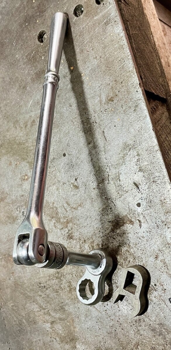

On 8/13/2025 at 5:01 PM, BlueTR3A-5EKT said:
Or cut a neat hole in the gearbox tunnel and work from in the footwell
We have a crows foot spanner that fits in an extension that can be operated from under the bonnet   above the starter motor
IMG_7455.jpegThis is what I did when I fitted a Wasp late last year , then bought large bung from TRGB
