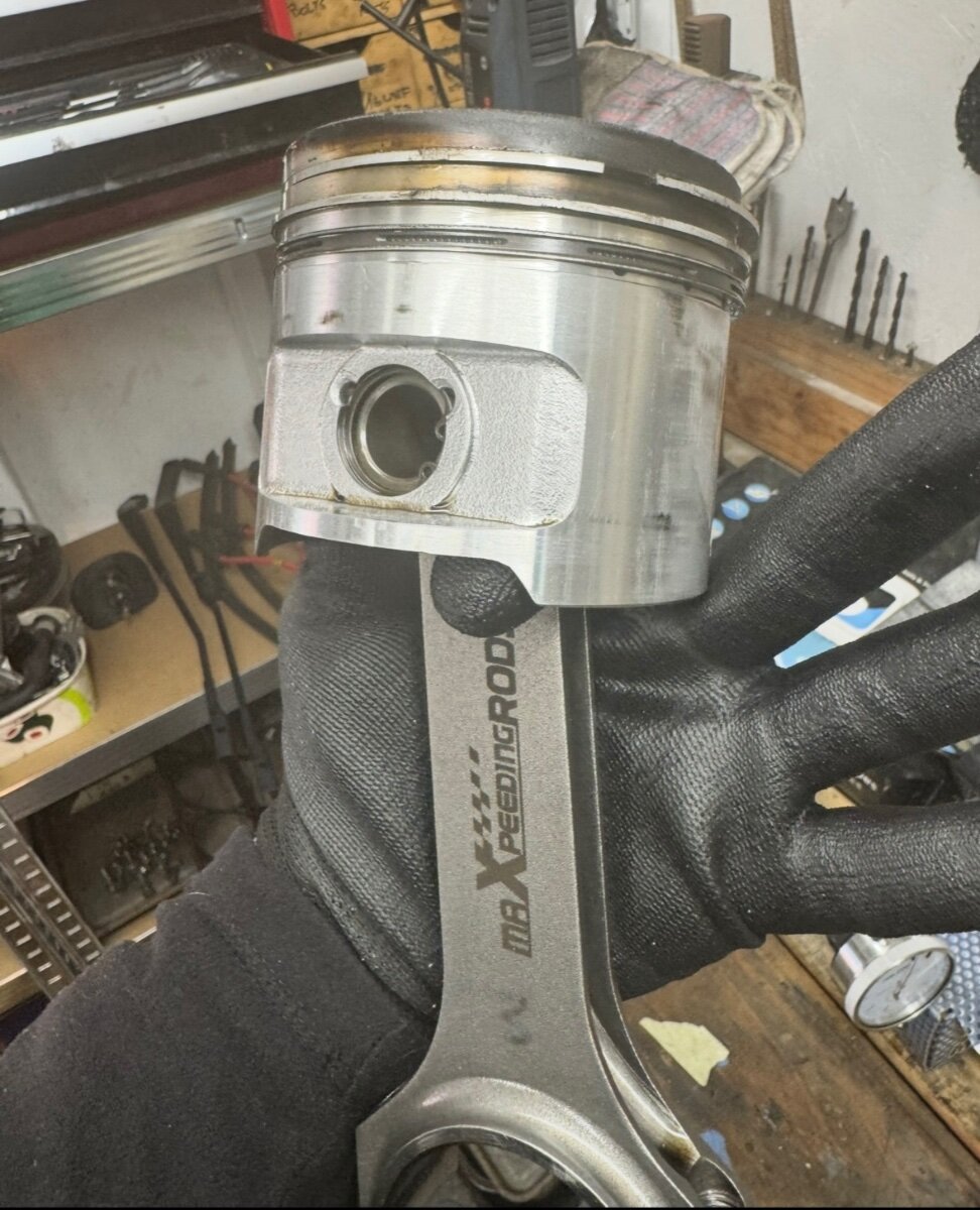

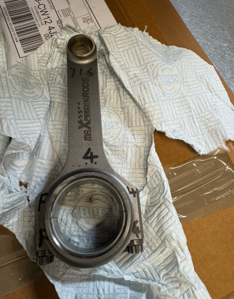

james christie Posted September 2, 2025 Report Posted September 2, 2025 My long term winter project is rebuilding the original engine for my 3A. My first purchase was a set of MaxSpeeding rods last week after much useful advice on these fora. Nice looking rods. Cost here in France was 377€ delivered. Three are at 647g and the fourth at 648g (!) I weighed one of the old rods - 965g. james Quote
Hamish Posted September 2, 2025 Report Posted September 2, 2025 (edited) +2 MaXpeeding rods ive had mine out after about 4 hard years of sprint and hill climb abuse. ( due to piston issues) and they were in great condition. Just changed big end shells not that they needed it. real fit and forget parts. Edited September 2, 2025 by Hamish Quote
Andy Moltu Posted September 2, 2025 Report Posted September 2, 2025 The Maxpeeding rods even come with ARP bolts. They strike me as over engineered- erring on the cautious side so are heavier than Carillos but at a fraction of the price. Way lighter than the original rods and way stronger and better balanced. Quote
