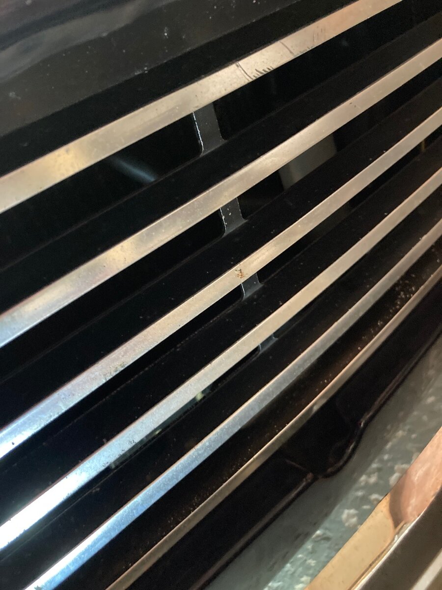

trchris Posted September 1, 2025 Report Posted September 1, 2025 Hi I’m about to re- paint the grill on my 250 fortunately it’s original but has, by the previous owner, already been spruced up however not particularly well. Does the black cover the whole of the slat up to the bend ? at present it stops approximately 5mm short and l take it it’s matt black? not the gloss it is at present. Chris Quote
Tim T Posted September 1, 2025 Report Posted September 1, 2025 It is up to the bend and certainly not gloss. I did mine matt. Tim Quote

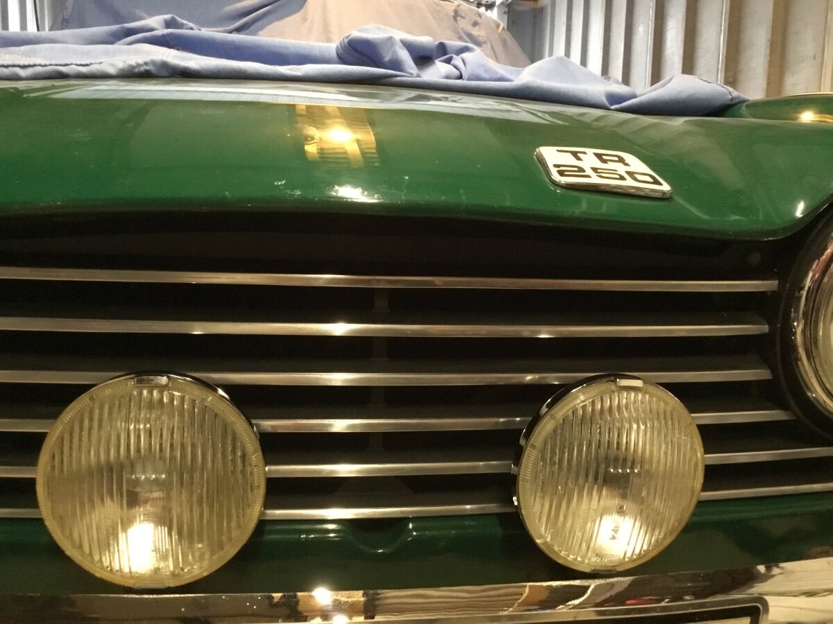

TR4Tony VC Posted September 3, 2025 Report Posted September 3, 2025 8 hours ago, trchris said: Mine has the more rounded slats not the sharp folds like Peters above possibly because it’s the original 250 ? Anyway l can now do as Tim and use a silver spray before applying the Matt black after etch priming first of course Chris The rounded profile is actually for the TR4a. The angled grill as shown in Peter V W’s pick above was used toward the end of the TR4a production run from the beginning of May 1967 when the first TR250 and TR5’s were being assembled and tested via the prototype cars. All TR250’s and TR5’s had this later grill as far as I am aware. Certainly easier to mark up and paint this later grill! Regards Tony Quote

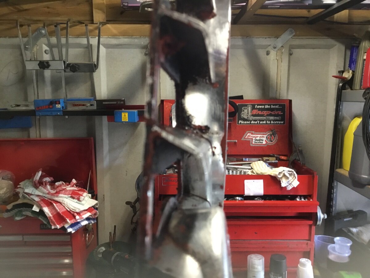

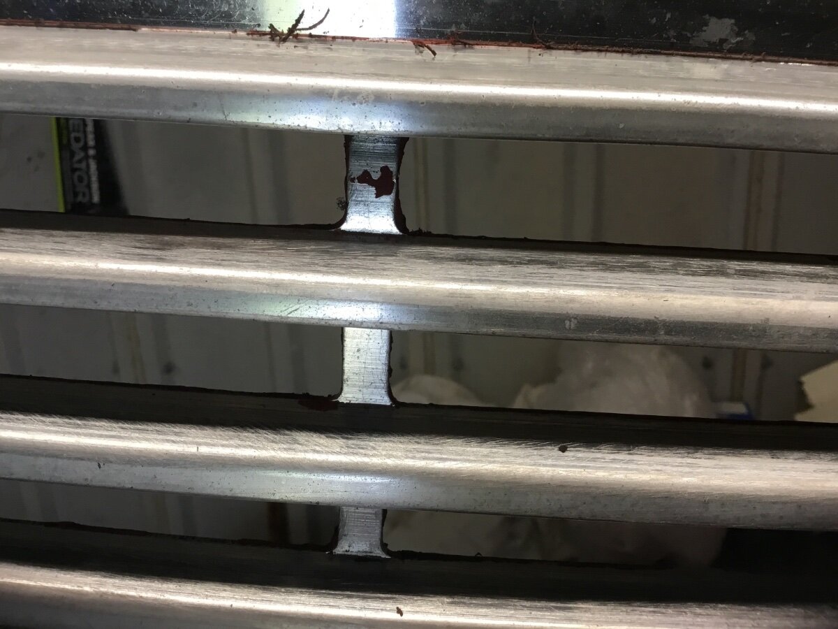

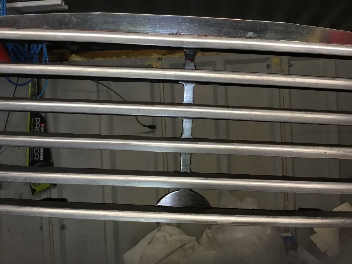

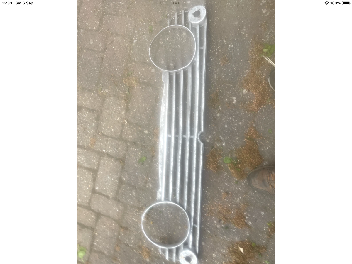

trchris Posted September 4, 2025 Author Report Posted September 4, 2025 (edited) Here’s some pictures midway through paint stripping note scratches from previous owners original stripping of grill hopefully the etch primer will cover Chris Edited September 4, 2025 by trchris Quote
TR4Tony VC Posted September 6, 2025 Report Posted September 6, 2025 Hers another one I’ve pinched from eBay - this is a late 4a grill, with the angular slat and the starting handle cut out. Quote
trchris Posted September 6, 2025 Author Report Posted September 6, 2025 After a hours of stripping , polishing then a morning of masking using a vernier gauge, coat of etch primer 2 coats of Matt black the grills back on and looks 100% better than before so worth the extra effort Chris Quote

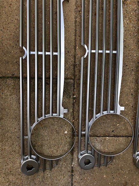

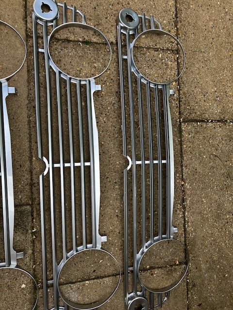

rcreweread Posted January 27 Report Posted January 27 As far as I am aware. what I find interesting about this topic is that early TR4As, with the starting handle hole, had the rounded slats and it was later ones which were fitted with the angular slats - I can say this with a degree of confidence as I have three very original and unrestored 4As which support this view. One would have expected therefore that the carry over to the TR250/5 production would have been the later angular slatted version - incidentally, none of my original grills had any black paint on the rear of the slats as per the norm for TR5 ones. Photos attached show the difference in the slat profiles if you look closely. I will be taking some of these refurbished grills to Stoneleigh (Stand 330C in Hall 2A) so you can have a closer look and buy if necessary ( Bargain at £250 ono )- I understand the company who had started remaking these a few years ago has now stopped so the supply of these may get more scarce. Cheers Rich C-R Quote
trchris Posted January 27 Author Report Posted January 27 11 hours ago, Kenrow said: This article was written by Jan Steenbeek, TR Register Holland: The Riddle of the Rounded Slat Grilles on TR250 and TR5.pdf 755.94 kB · 10 downloads Thanks Ken for posting this article it looks like l have one of these earlier 250 grills mentioned it’s good to get a ending to the saga Chris Quote
