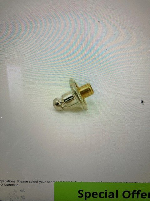

Lebro Posted September 3, 2025 Report Posted September 3, 2025 I assume this is what is being refered to, but where on a TR is this type used ? Quote
MichaelH Posted September 3, 2025 Author Report Posted September 3, 2025 Hi Lebro Not that one This one is used across the back of the hood so as to attach the rear of a tonneau Quote

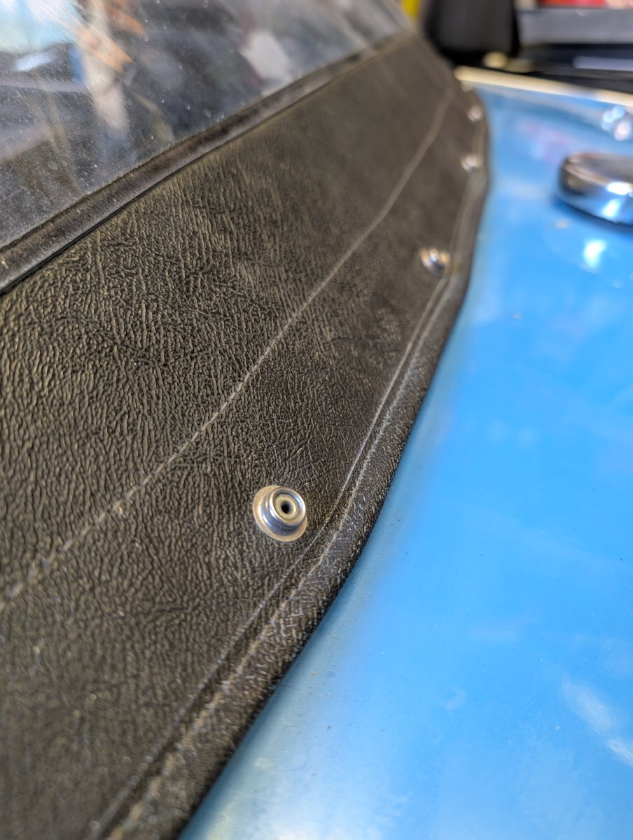

Dale Moore Posted September 3, 2025 Report Posted September 3, 2025 (edited) My 4a has these along the back of the hood, to hold the hood bag on. Not sure about a tonneau as I don't have one. Dale Having said that the same studs are along the tops of the doors and the dash. Always assumed that if I had a tonneau that would be how it was meant to be attached Edited September 3, 2025 by Dale Moore Quote

Dale Moore Posted September 3, 2025 Report Posted September 3, 2025 Interested to know why Michaels are different Quote
Dale Moore Posted September 3, 2025 Report Posted September 3, 2025 Well I've learnt something today. All the suppliers show Michaels style studs along the back. I always assumed the hood cover was original to the car when I bought it. hence why I fitted the press studs to suit it wow 😲 Quote
