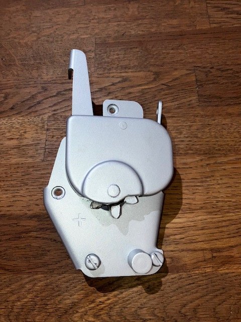

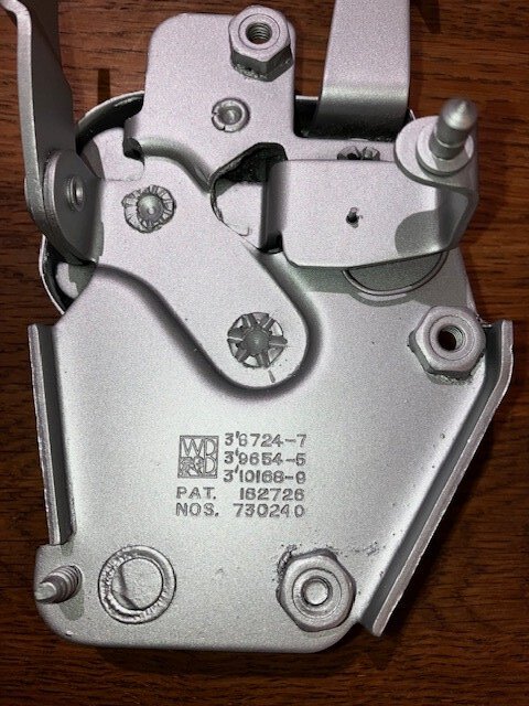

rcreweread Posted September 3, 2025 Report Posted September 3, 2025 11 hours ago, John Morrison said: Had a couple of different door seals on my Tr4. Latest one is a Woolies 265A Flap mSeal, on Stewarts recommendation. lovely fit but it hasn't solved an on going isue I have with the NS door, chattering on the door lock. The dor panel fit i sfine, yet I can move the door 'Inside 2/3 MM on the lock. The striker plate is as far inwards as it can go, being up against the the holes in the B Post, so I can't see what need sto be done. Is there wear in the door catch or something else? John. John - how worn is the cog in your rotary door lock? The cog itself rarely wears as it constantly moves around - the pin it rotates on can wear but more usually the pin itself becomes loose as it is rivetted onto the back plate and this can come loose. The rivetted back of the pin is clearly visible in the middle of the attached photo. The front photo shows the head of the pin sticking through the top cover - when these come loose, they often wear the hole in the top cover which just adds to the problem. This problem was raised previously on the forum since when I now have a good stock of latches for both sides, all refurbished, just like the photos attached- PM if you are interested in one - cheers Rich C-R Quote

Pontious Posted October 14, 2025 Report Posted October 14, 2025 On 9/3/2025 at 10:44 AM, rcreweread said: John - how worn is the cog in your rotary door lock? The cog itself rarely wears as it constantly moves around - the pin it rotates on can wear but more usually the pin itself becomes loose as it is rivetted onto the back plate and this can come loose. The rivetted back of the pin is clearly visible in the middle of the attached photo. The front photo shows the head of the pin sticking through the top cover - when these come loose, they often wear the hole in the top cover which just adds to the problem. This problem was raised previously on the forum since when I now have a good stock of latches for both sides, all refurbished, just like the photos attached- PM if you are interested in one - cheers Rich C-R Thanks Rich I bought one of your refurbished door latches to replace my 4A driver’s one which was very worn and usually needed a good slam to engage. What a transformation - it now easily clunks just a VW Golf as the old advert used to say! So thank you for that. David Quote
rcreweread Posted October 14, 2025 Report Posted October 14, 2025 26 minutes ago, Pontious said: Thanks Rich I bought one of your refurbished door latches to replace my 4A driver’s one which was very worn and usually needed a good slam to engage. What a transformation - it now easily clunks just a VW Golf as the old advert used to say! So thank you for that. David David - thanks and glad to have been able to help - it makes it worthwhile when one's efforts work well and are appreciated - thanks again Cheers Rich C-R Quote
