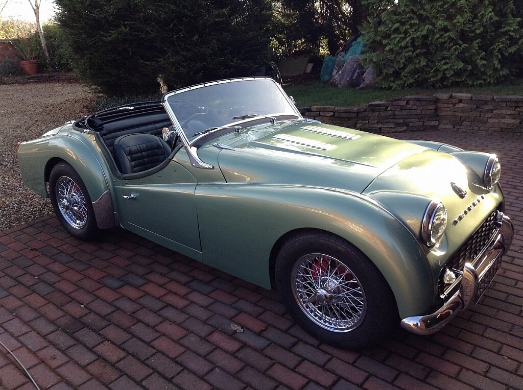

Upriis Posted September 10, 2025 Report Posted September 10, 2025 Hi Bev, I had the Phoenix sport single box big bore system on mine. After failing scrutineering at castle Coombe with this set up, I purchased the Phoenix twin box standard set up. I found that the bore of the pipes was identical? I fitted the front pipe and centre box from the "standard’ twin system and retained the original "big bore" back box as it was bigger and quieter than the "standard" rear small box. The sound is still sporty, but much more bearable and importantly now passes scrutineering. Great car by the way, it was a toss up for me between yours and the car I have now, when I purchased a few years ago… Quote
Bev Spiers Posted September 11, 2025 Author Report Posted September 11, 2025 That's interesting, sounds like I nearly missed out on David Gillespie's superb restoration. In the past all my classics have needed work, some have been a real money pits, like my 53 Jowett Jupiter. I know I paid big money for 499KPA but it's perfect and needs no work at all, possibly saving me money in the longrun. I just need to change the silencer to quieten it down a bit so I don't fall out with any of my neighbours. 😀 Thanks to everyone for replying to my questions Quote
Upriis Posted September 11, 2025 Report Posted September 11, 2025 (edited) It was a close call… Please wait while image is uploading... Edited September 11, 2025 by Upriis Quote
Bev Spiers Posted September 12, 2025 Author Report Posted September 12, 2025 Where and when was photo taken. It must of been earlier in it's restored life. Red brake calipers are now black and two grill badges added before I bought it. Love to know who owned the car between me and David Gillespie the restorer. Just to say, 499 KPA features in the latest Practical Classic magazine, page 88 Quote
