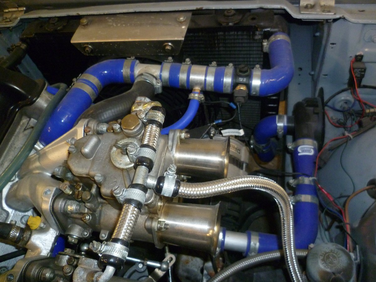

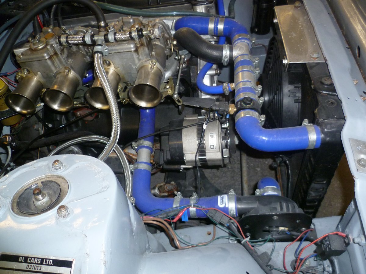

Ecosse Posted September 17, 2025 Report Posted September 17, 2025 Hello Mick, Your biggest hassle shall be sorting out the cooling system, particularly if you do not have a thermostat housing. I have a Davies Craig electric water pump, electric fan and controller fitted. Another issue may be the throttle linkages fouling on the bonnet, I have 'underslung' actuators. The manifolds for Webers are different for the 8v and Sprint engines. As Jerry mentions, to get the best out of the Webers ideally you would require some engine upgrades, I have a balanced and lightened engine, flowed head, uprated cam, four branch, straight through exhaust, electronic ignition, etc. Good Luck. Cliff Quote
Mick Ferguson Posted September 19, 2025 Author Report Posted September 19, 2025 Hi Jerry & Cliff, Thanks for your advice and getting connected, The under bonnet pictures save a thousand words but can I ask where did you get your remote sections for the temperature sensor and everything else that has to be fitted into the top hose?. I already have a stainless steel four branch sports exhaust and the electronic ignition fitted. Do you need to change anything to accommodate the advance and retard vacuum pipe as was previously attached to the HS6 twin SU's. Quote
Ecosse Posted September 22, 2025 Report Posted September 22, 2025 Hello Mick, Sorry for the delay in responding, busy weekend Hillclimbing at Doune, it now looks like I have an engine issue. Anyway, all of the parts for my cooling system came from Car Builder Solutions, including a custom piece for the original temperature sensor and expansion tank take-off. I would be interested to know what chokes and jets are fitted to the Webers supplied with the kit, it has been a long journey by trial and error to find the best set-up. When I spoke to Weber they only said that they recommended a Rolling Road session. Cliff Quote

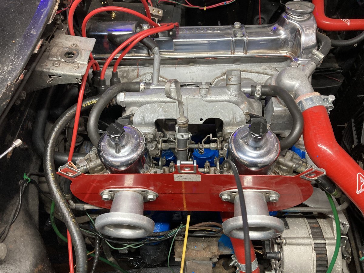

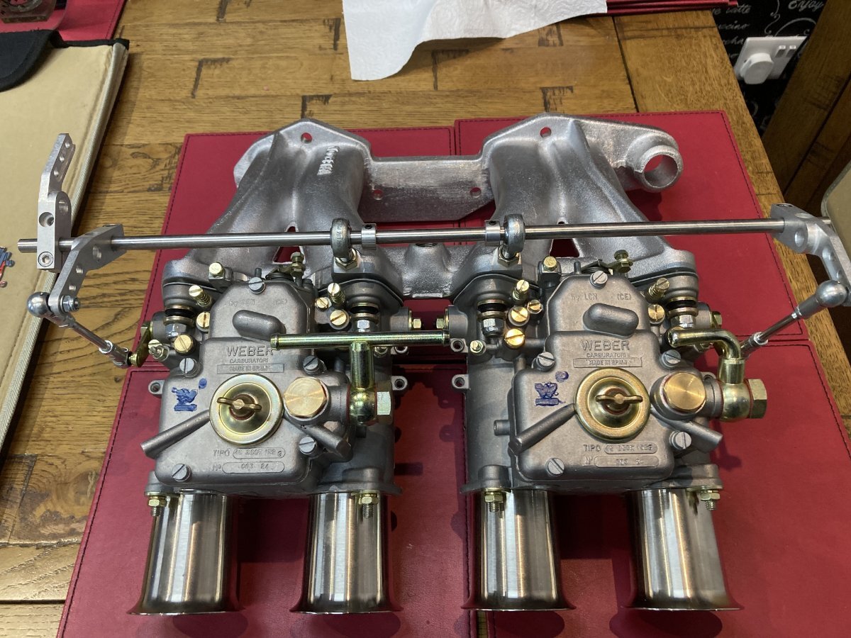

Mick Ferguson Posted June 23 Author Report Posted June 23 Hi Cliff I know its been awhile but I have finally been getting on with the TR7 twin 45 conversion. May I ask were did you get the underslung actuators for your carbs because as you say the standard top fitting of linkages fouls the bonnet. Quote
Ecosse Posted June 24 Report Posted June 24 Good Morning Mick, Disappointing in that the Weber kit does not include a suitable linkage set-up. Attached is a diagram of the linkage from the Weber Tuning Manual. I have used the LP 3000 version on each carburettor, mainly because the carburettors seem to be too close together to use a single linkage associated with the available throttle levers. I ended up purchasing a second hand throttle pedal from Robsport which I modified to take two throttle cables, one for each carburettor. If you purchased your kit from Webcon it may be worthwhile contacting them to advise that the set-up provided with the kit does not work. Webcon can supply all of the parts required. Hopefully the attached file opens OK and the above makes sense and is of use. Regards, Cliff IMG_20260624_0001.pdf Quote
