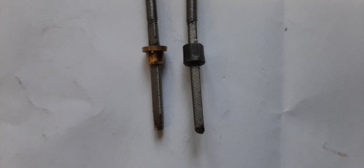

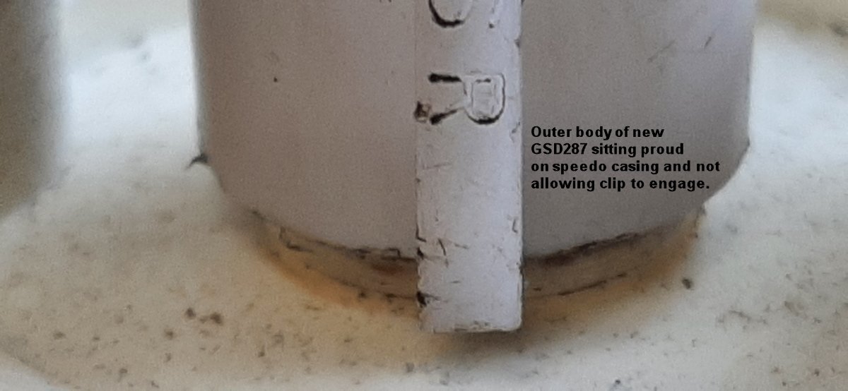

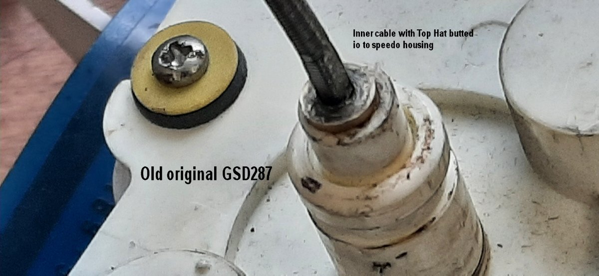

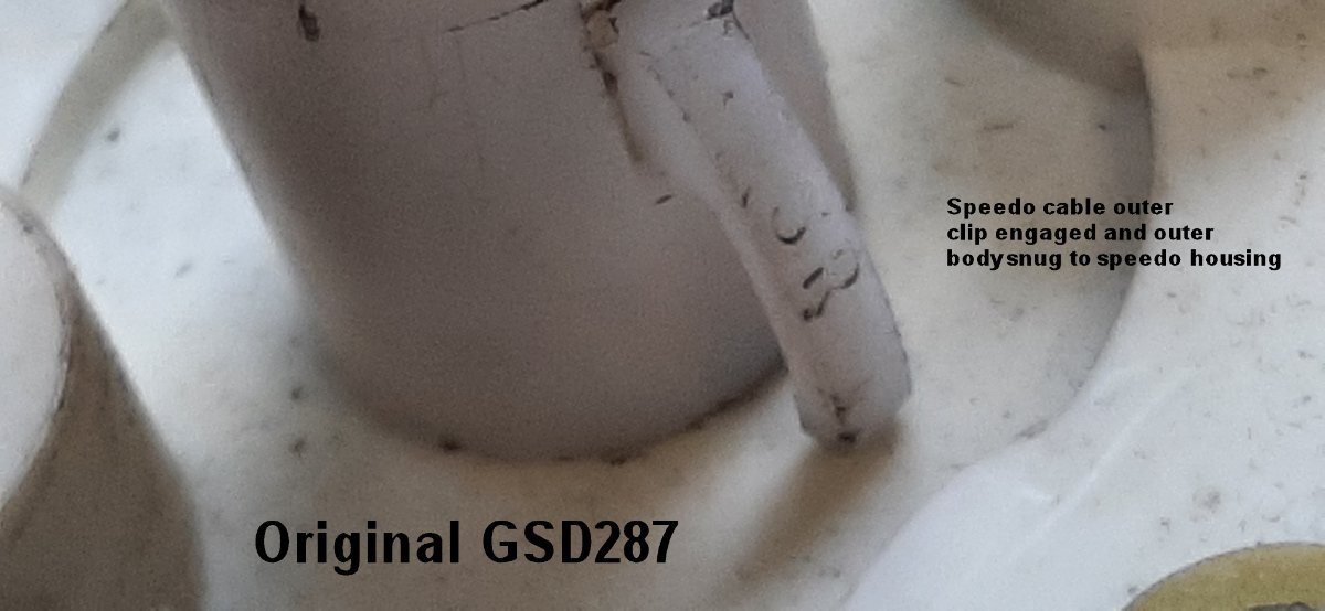

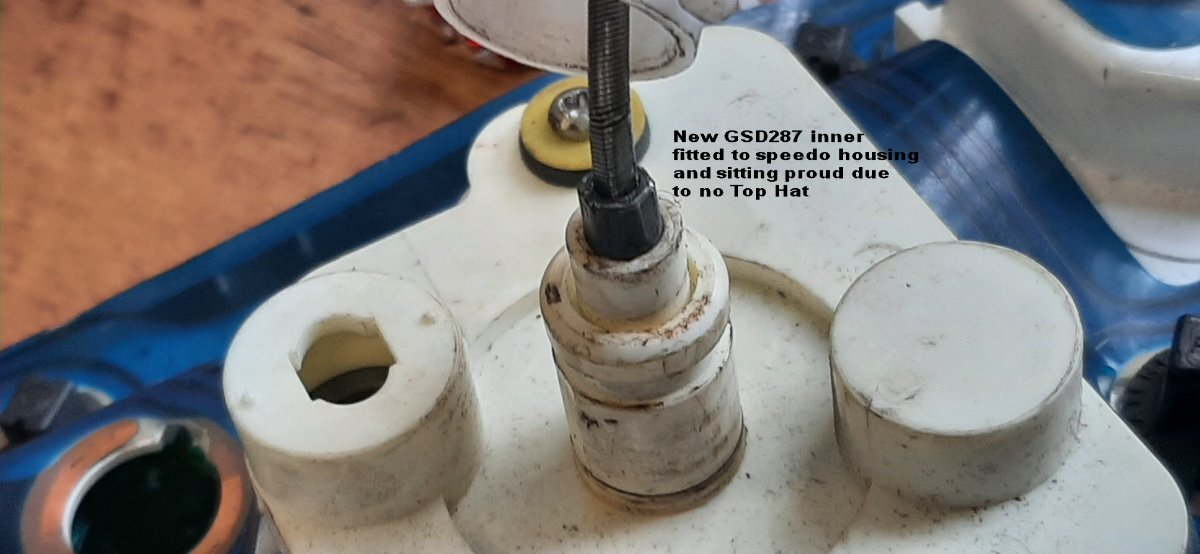

I have a problem with a GSD287 replacement speedo cable not clipping in to the body of the speedo casing. The clamp ferrule on the inner cable at the speedo head end is sitting on top of the speedo case moulding and unlike the original (which uses a brass top hat ferrule) not entering into the speedo case moulding,
Has anybody come across this issue? Does the ferrule have to go inside the speedo case moulding to allow the clip to engage? Do I need to fettle the clamp ferrule? Do I have the inner cable reversed?

I am surprised there have been no replies to this thread as this problem must have been encountered before. The solution is whilst this is the right replacement cable the ferrule should site "inside" the speedo back housing, not on top of the casing as it did. The solution was to carefully grind the the ferrule from it's rough crimped hexagonal shape to one more rounded. Once done it slipped into the housing ensuring that there was enough leeway to allow rotation. Then the outer plastic sleeve fitted over and clipped correctly into place.
