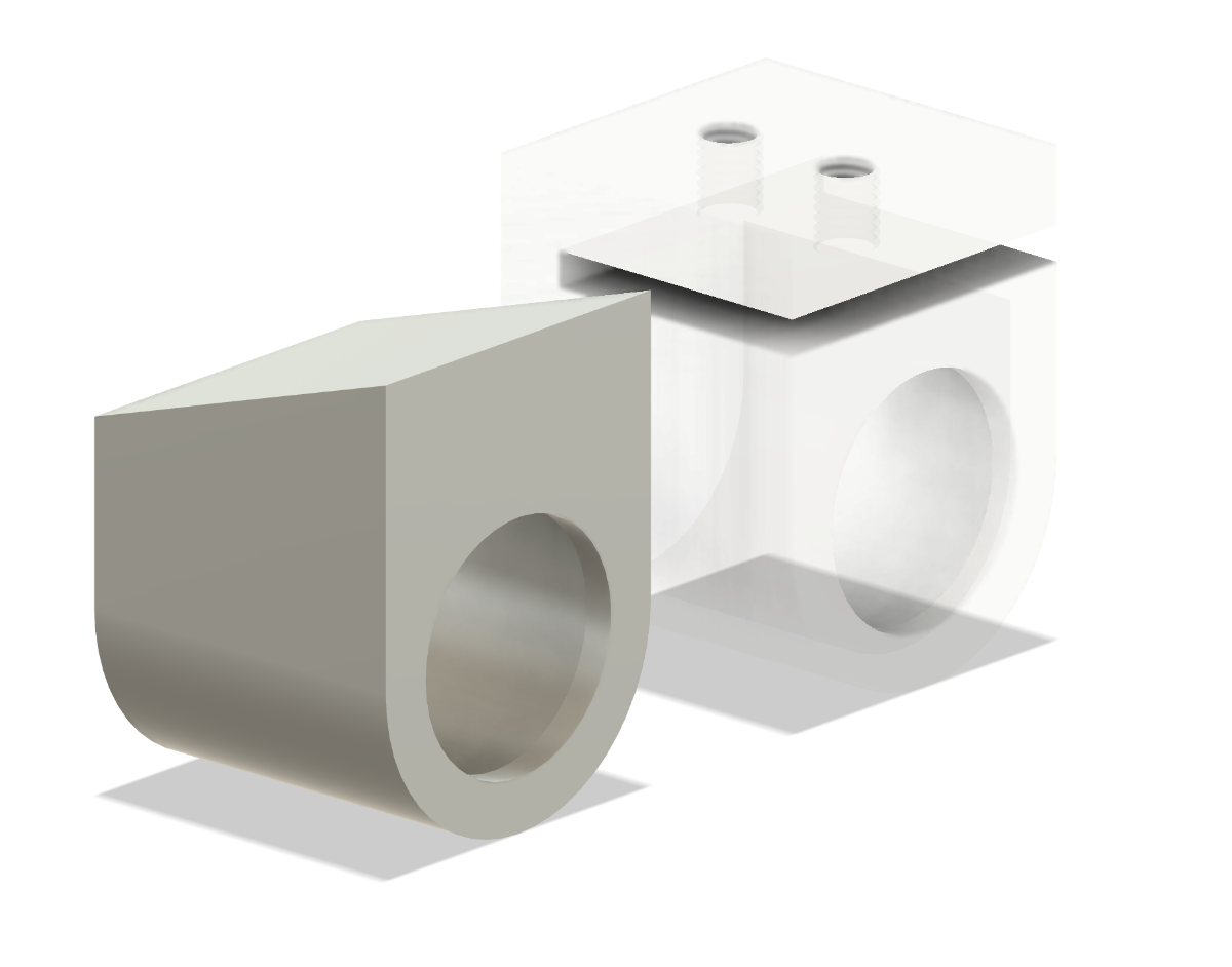

GreatOldOne Posted September 29, 2025 Report Posted September 29, 2025 How about something that sits under the bumper? I looked up a popular kit on amazon and it says they're 21mm diameter... I did a quick and dirty model of a pod that might slide onto the bumper from behind and then be locked in place with a couple of grub screws. You'd still have to deal with routing wires - and account for any angle of the bumper making them point up... Quote
RogerH Posted September 29, 2025 Report Posted September 29, 2025 That adapter may work. The sensor can see sideways better than an Owl with a twisty neck so anything sticking out will set it off. Roger Quote
GreatOldOne Posted September 29, 2025 Report Posted September 29, 2025 You wight even get away with having something similar to what I drew up - but instead of fastener it might be easier to use some VHB tape to sticker them to the underside of the bumper. They’re not very heavy. And that tape is what they usually use to stick stuff to the outside of cars anyway. Just a thought. 🤓 Quote

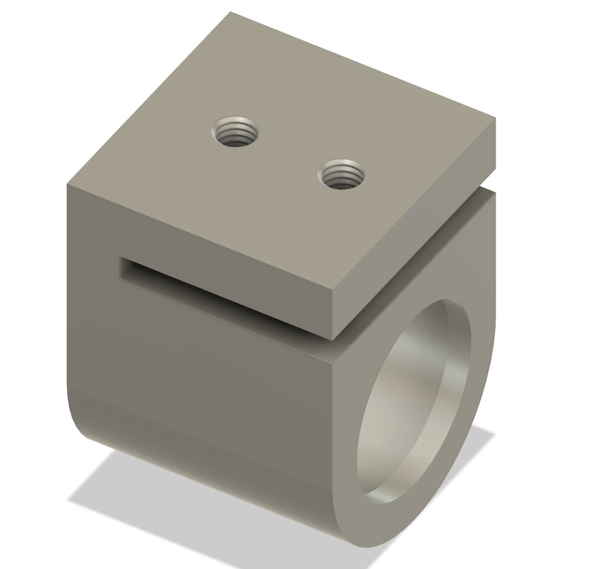

GreatOldOne Posted September 30, 2025 Report Posted September 30, 2025 (edited) Here's another with an angle to accommodate the underside of the bumper (can be changed to whatever angle is required) that would stick on with VHB. Happy to help out if you want to look into fitting them like this. I can print them out for you - and make them prettier (chamfers or radiuses corners) and size them to whatever size sensors you get. Cheers Jason Edited September 30, 2025 by GreatOldOne Quote

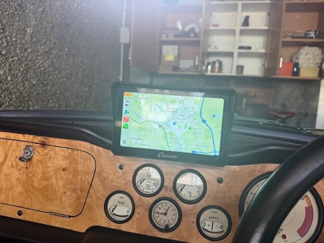

GreatOldOne Posted September 30, 2025 Report Posted September 30, 2025 Put it where the ash tray is? That's how I mounted my CarPlay screen. Quote

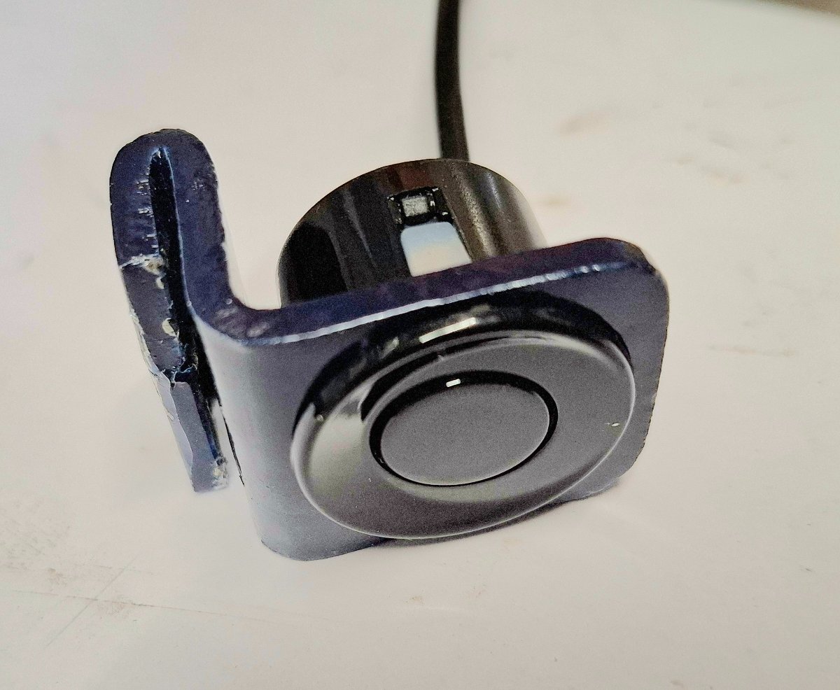

wheeler Posted September 30, 2025 Author Report Posted September 30, 2025 Thanks Guys especially Jason (GreatOldOne) I am fabricating holders out of aluminium inspired by Jason's suggestions. If they don't work I may be back asking for your help Jason. Thanks again Bill Quote

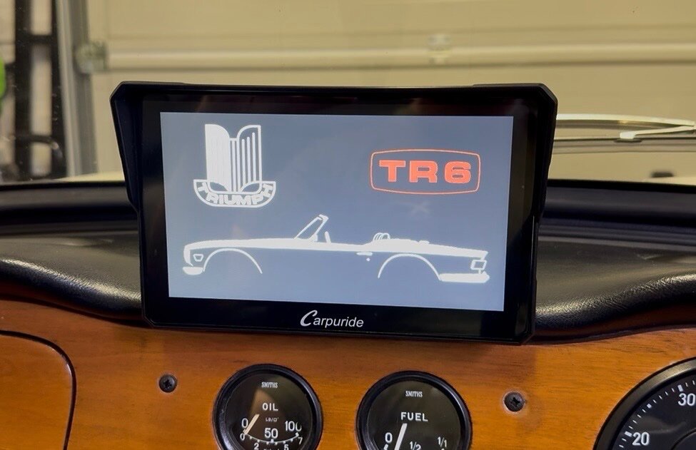

harrytr5 Posted October 1, 2025 Report Posted October 1, 2025 Maybe a a camera mounted to the rear Surry screen and programmed into the Carpuride? How can I put a picture of my 5 when unit is not needed for sat nav Jason ? Regards Harry Quote

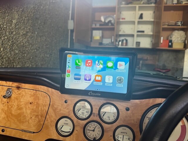

GreatOldOne Posted October 1, 2025 Report Posted October 1, 2025 I don’t think you can add a camera to the units we have @harrytr5 - they’re designed for motorcycles, which don’t really have a need for a reversing camera. I have seen other bike specific carpuride units that have front and rear cameras, but I believe they’re more akin to dashcams rather than anything else. You can get car specific CarPlay units from carpuride and other manufacturers that do offer reversing cams - but then you lose your quick disconnect mounting system. 1 hour ago, harrytr5 said: How can I put a picture of my 5 when unit is not needed for sat nav Jason ? Like this? This only displays when it starts up… and you need to have an image in the correct format. I can walk you through it if you want. PM me. Quote
harrytr5 Posted October 1, 2025 Report Posted October 1, 2025 Hi Jason, I could of course bugger everything up knowing me. Regards Harry Quote
pinky Posted October 1, 2025 Report Posted October 1, 2025 That really is impressive Mr great old one, it such ashame the unit dousnt connect to a camara 10 out of 10 and a gold star Pink Quote
harrytr5 Posted October 3, 2025 Report Posted October 3, 2025 Thanks to Jason, After a few teething problems the Satnav works extremely well and the touch screen is ace. So much in there I have as yet to explore. Regards Harry Quote

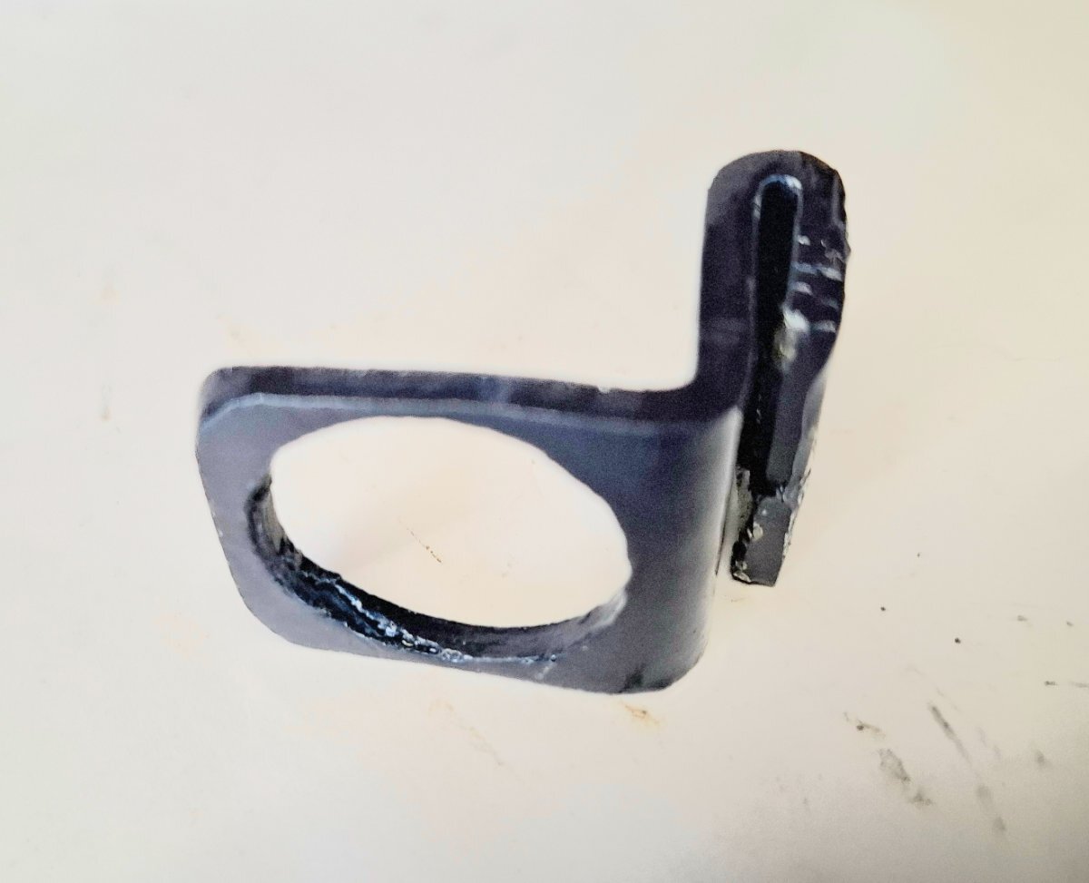

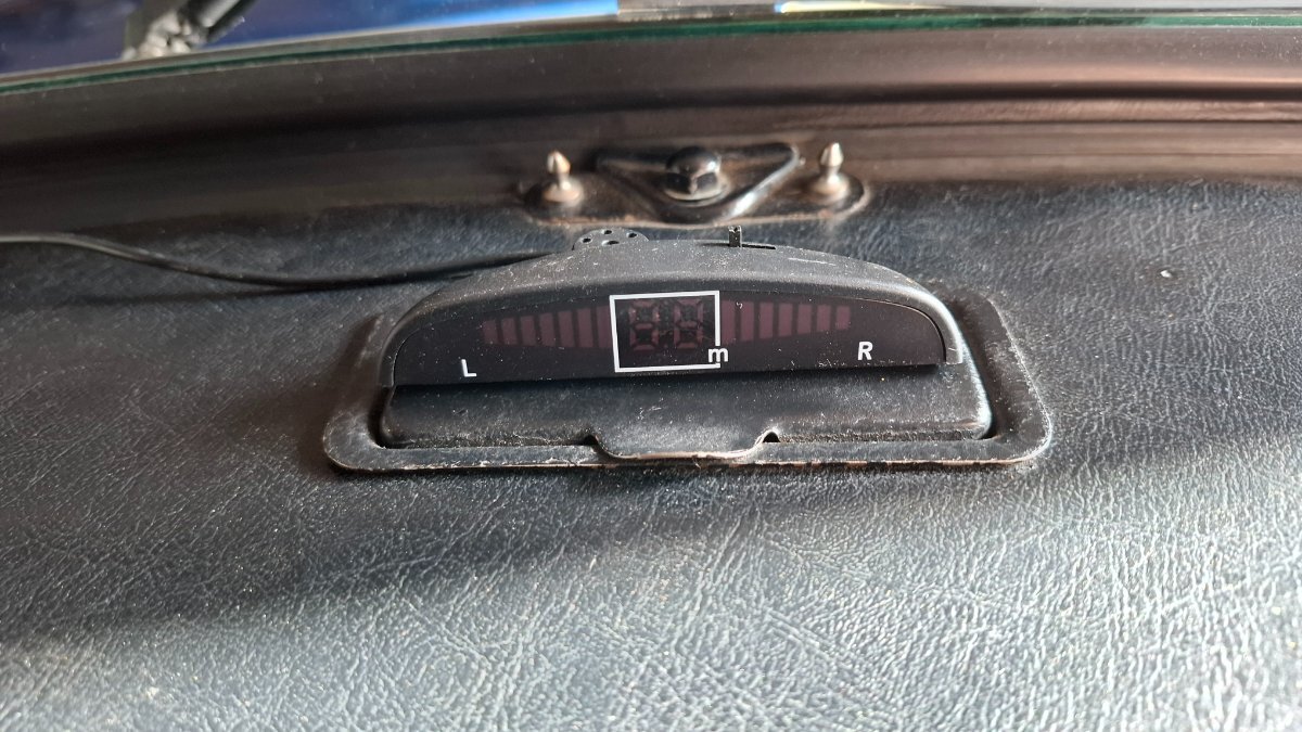

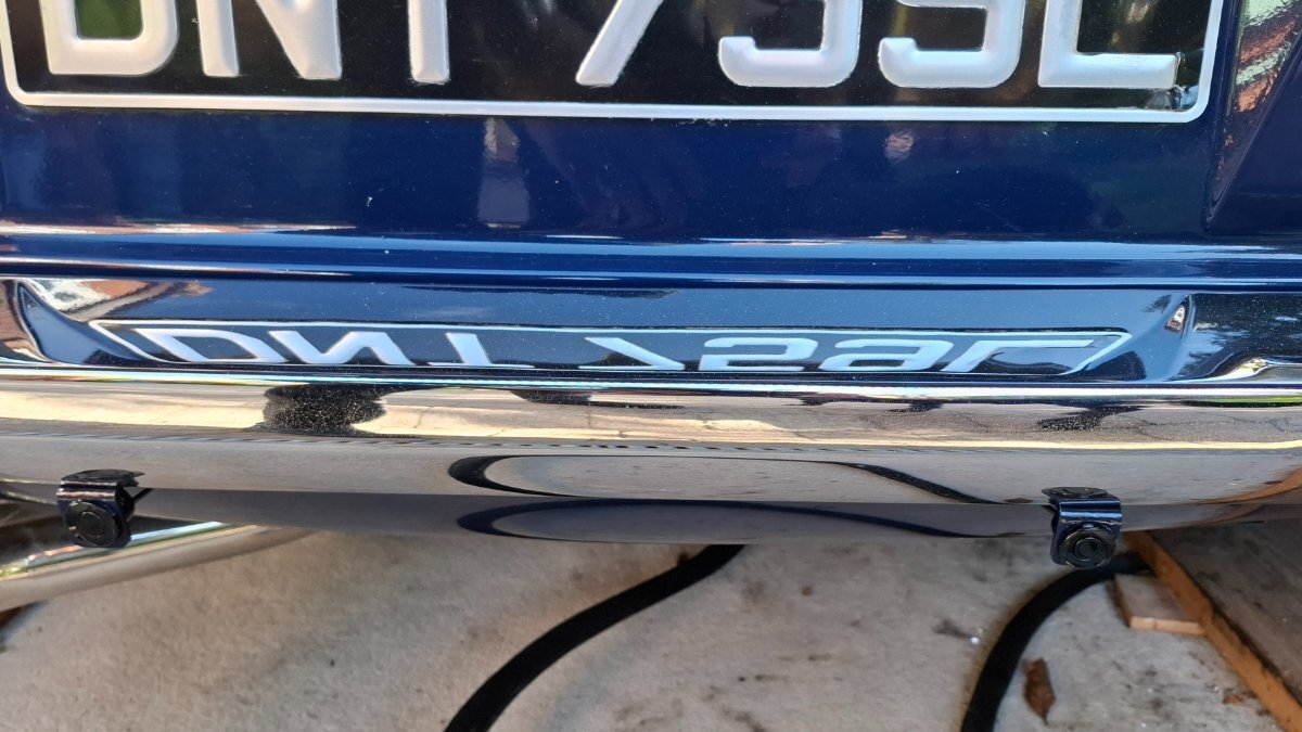

wheeler Posted October 27, 2025 Author Report Posted October 27, 2025 Finally got round to installing the parking sensor kit. I did not want to drill holes in the bodywork or bumper so I made some clips/brackets that clipped on to the underside of the bumper. Wiring was easy as I have a CP body converted to CR and have the redundant hole for the CP number plate light wiring just behind the rear bumper. I connected the control unit to the reversing light lamp connection. The sensor kit has a small display which sits nicely on the ashtray. Kit works quite well even has a left right indication. Bleep could be louder. Quote
wheeler Posted October 27, 2025 Author Report Posted October 27, 2025 Sorry forgot to add where I got the sensor kit from https://amzn.eu/d/fajHUeh Bill Quote
GreatOldOne Posted October 27, 2025 Report Posted October 27, 2025 Looks good! How does the beeper unit mount to the ashtray? Quote
wheeler Posted October 27, 2025 Author Report Posted October 27, 2025 At the moment temporarily with a number plate double sided adhesive pad but looking for a more sophisticated method, maybe double sided sellotape. Quote
