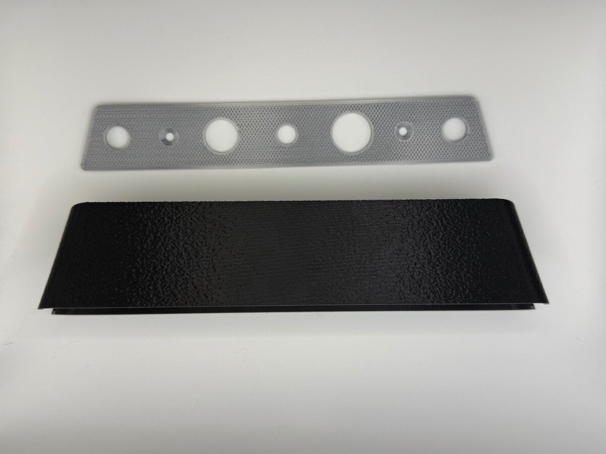

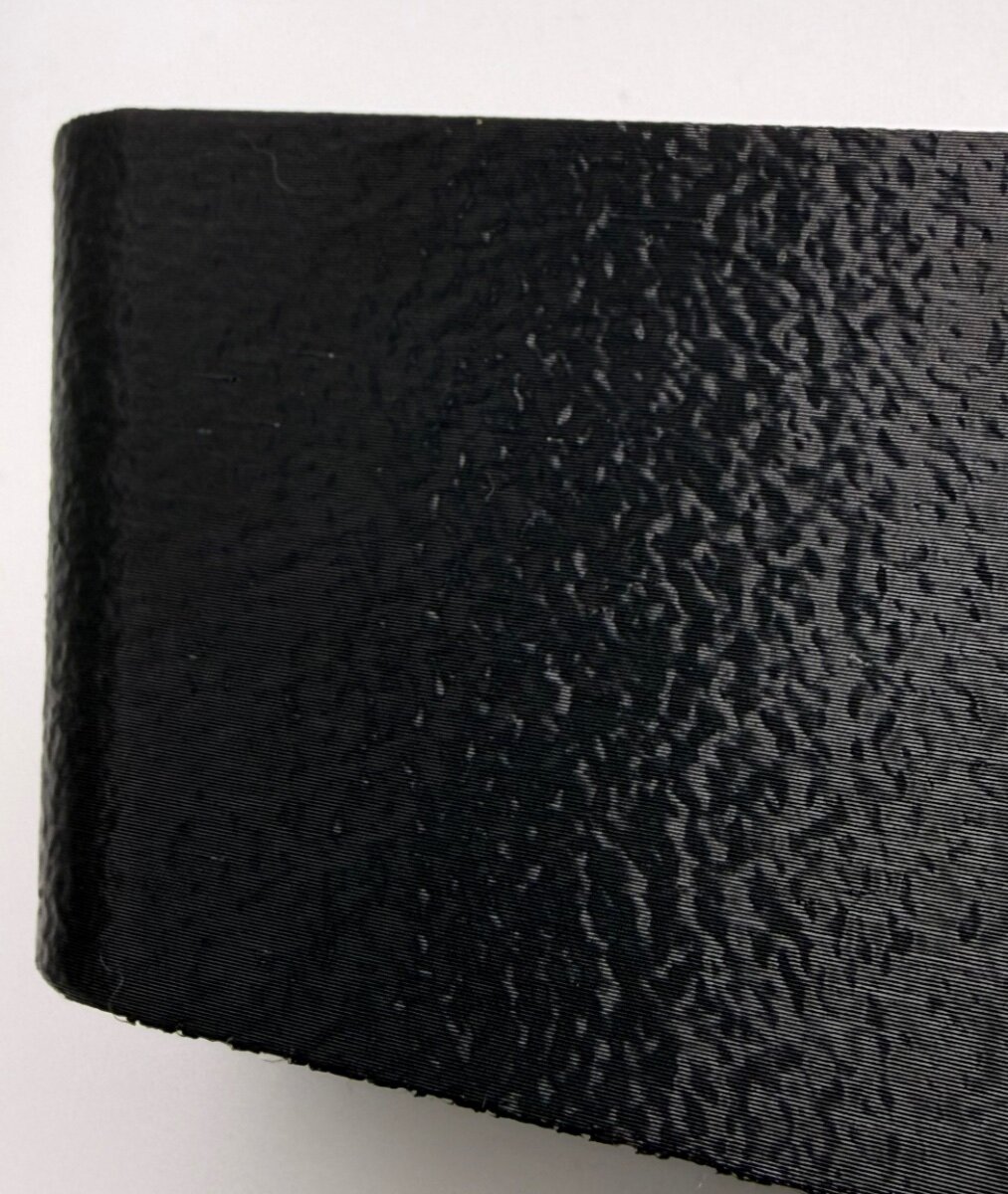

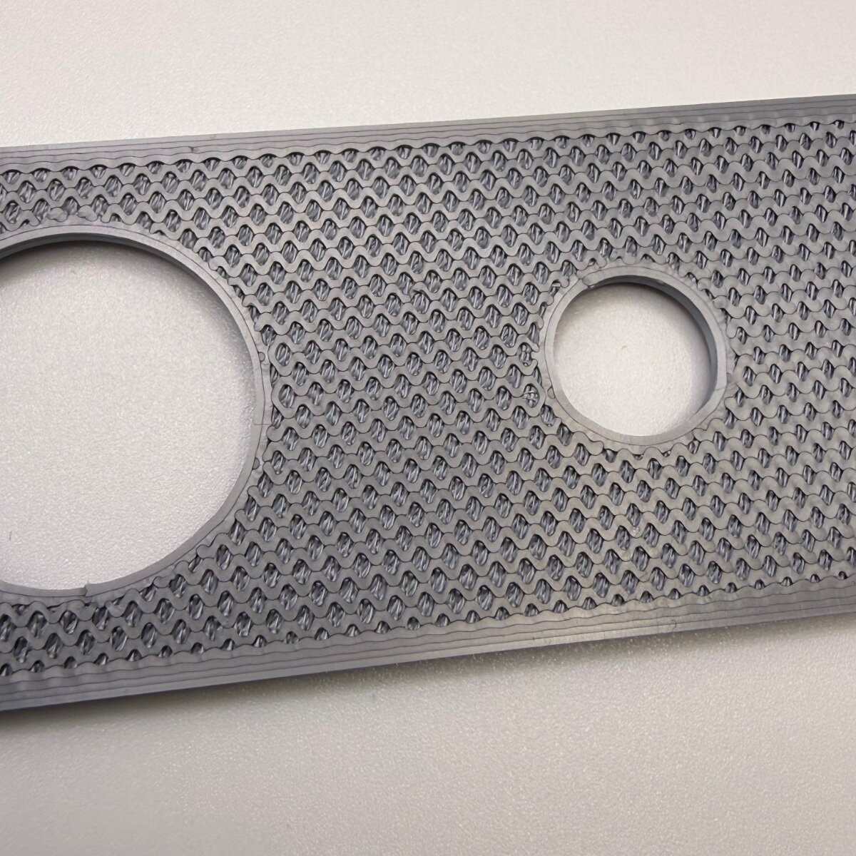

GreatOldOne Posted November 21, 2025 Author Report Posted November 21, 2025 Plinth = Black ASA plastic. Fascia Insert Silver / Grey Silk PLA+ Leather texture detail: Fascia detail. This (depending on people’s comments may get a test reprint with a finder a nozzle to try and better define the hatching. This is with a 0.4mm nozzle, I have a 0.2 arriving today. Quote
TR4Tony VC Posted November 21, 2025 Report Posted November 21, 2025 Switch plynth looks very good ! I think most could make the silver bezel work if they paint it ? Quote

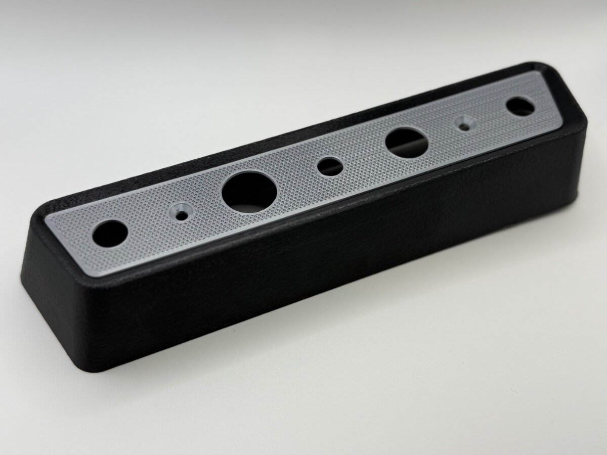

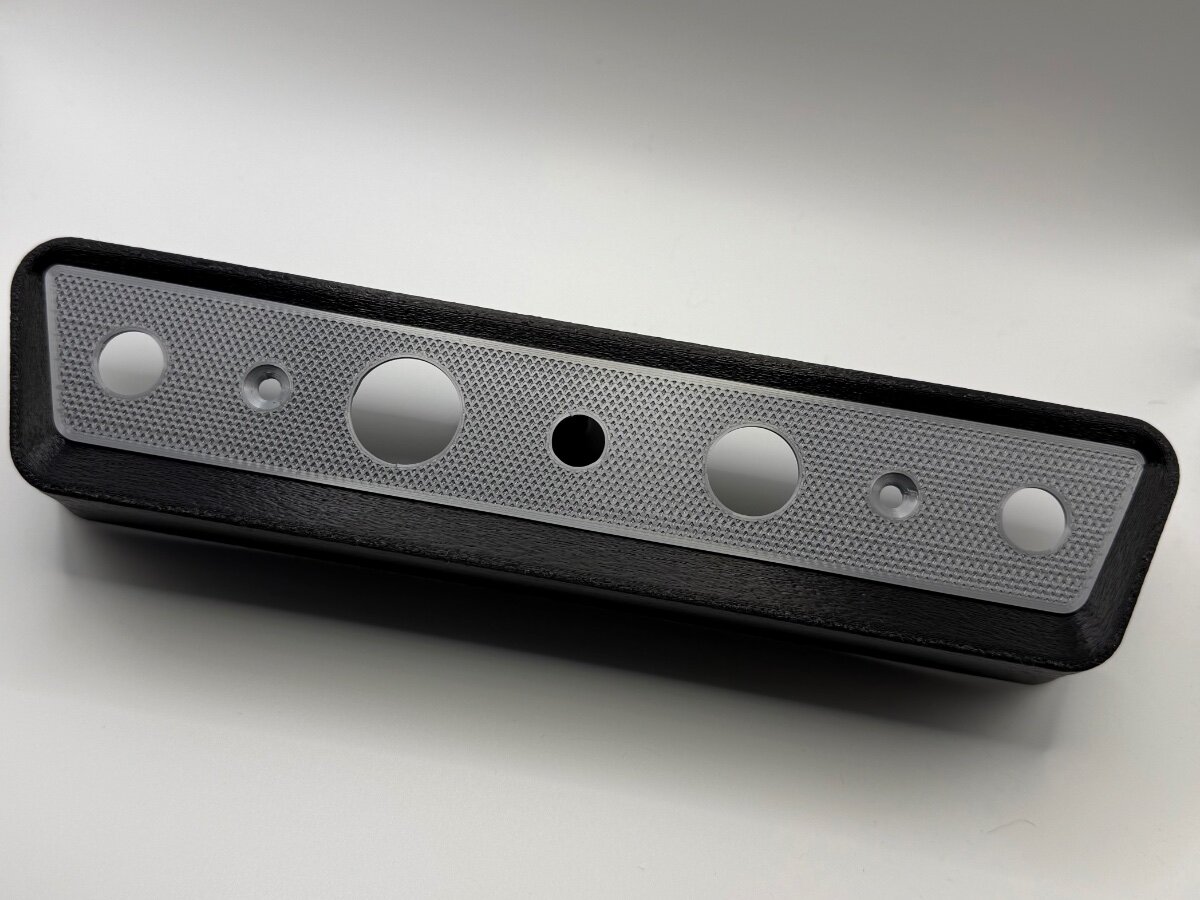

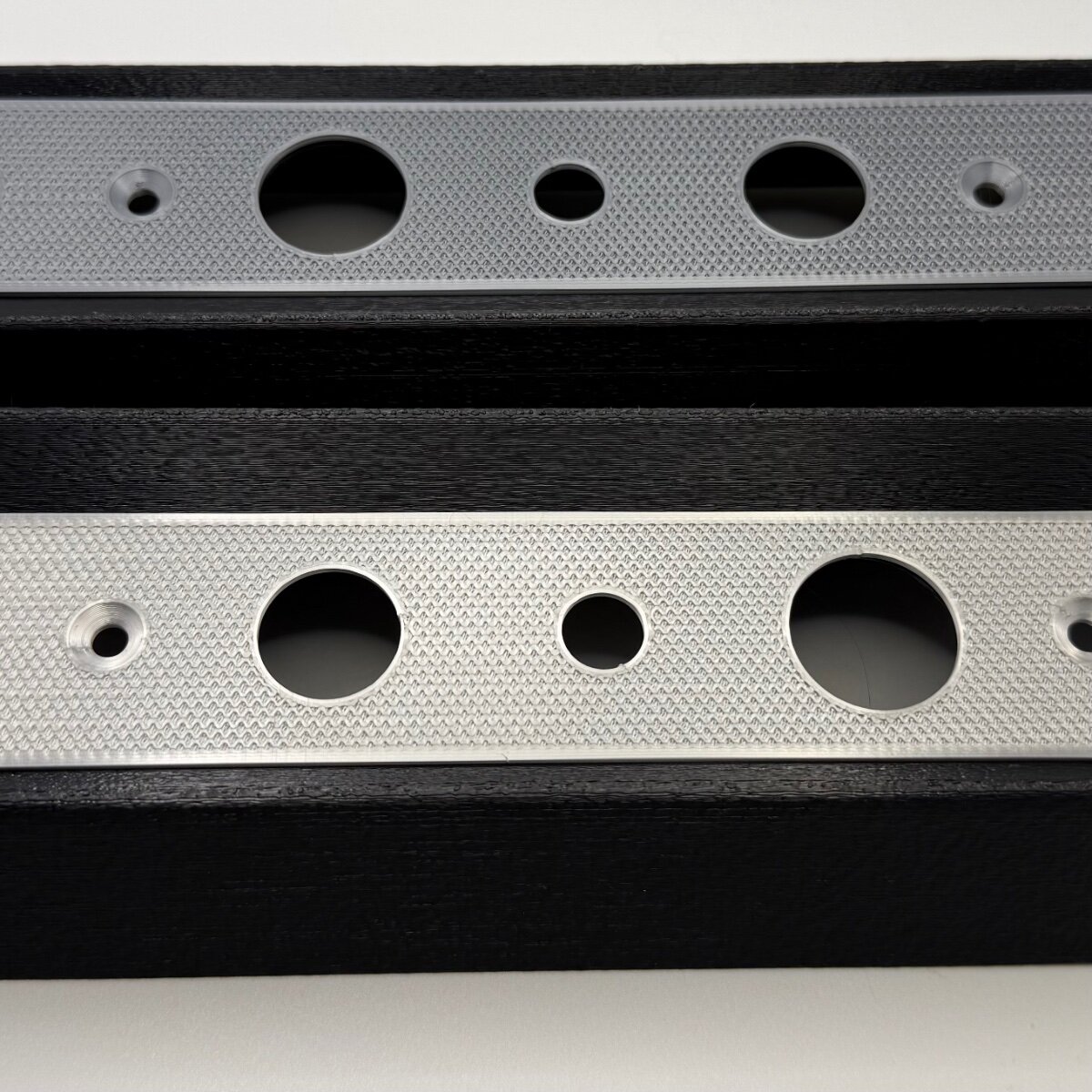

GreatOldOne Posted November 23, 2025 Author Report Posted November 23, 2025 Shiney. 😎 This is as silver as it gets - but I think it looks 100% better to the previous attempt. If it needs to be even shiny / chrome like, then it will need painting with one of the chrome like paints. If that is necessary then I may as well print these in black. And a word of advice when painting - use a specialist plastic primer before the colour. Quote
Chilliman Posted November 23, 2025 Report Posted November 23, 2025 That is looking close enough for me....Nice job 👍 Quote
stuart Posted November 23, 2025 Report Posted November 23, 2025 That does look really close to original as the original ally finish does tend to dull off after a while so would be a good match, what about the steel backing bracket that is needed to stop the choke cable pulling the whole thing off ? Will that fit behind? Stuart Quote

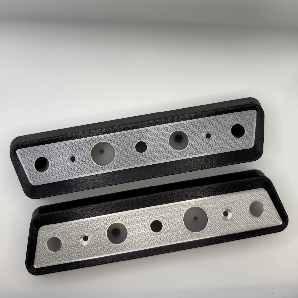

GreatOldOne Posted November 23, 2025 Author Report Posted November 23, 2025 I believe it should be - as Tony supplied me one of the brackets when I was creating the model. We’ll know for sure though next week, as he’s picking up the version without any crash pad cut outs and a black version of the fascia plate tomorrow night, and he’s fitting them to his car. all the dimensions of the plinth and the fascia along with the location and sizing of the holes are off the plastic version & oem fascia he lent me. If there are other hole spacing / patterns out there, I don’t know them as I only had those to work from (and don’t have a TR4 myself) Quote
stuart Posted November 24, 2025 Report Posted November 24, 2025 12 hours ago, GreatOldOne said: I believe it should be - as Tony supplied me one of the brackets when I was creating the model. We’ll know for sure though next week, as he’s picking up the version without any crash pad cut outs and a black version of the fascia plate tomorrow night, and he’s fitting them to his car. all the dimensions of the plinth and the fascia along with the location and sizing of the holes are off the plastic version & oem fascia he lent me. If there are other hole spacing / patterns out there, I don’t know them as I only had those to work from (and don’t have a TR4 myself) The plinth is fine from what I can see its just that there is a steel backing plate that was originally fitted behind the inner section of original plinths and had a return angle section on the right hand end that bolted to the side of the vent flap bracket to stop you pulling the whole thing off the dash when pulling the choke out. Just wondered how it would fit behind your plinth? Item 98 here https://www.moss-europe.co.uk/en-gb/dashboard-tr4-4a-1961-67-tr24--22--05--02 Stuart. Quote
GreatOldOne Posted November 24, 2025 Author Report Posted November 24, 2025 (edited) From the image on Moss, that’s the bracket that Tony left with me. It should sit behind ok as far as I can tell, as I tried it behind the new part and the holes lined up - as for height and the ability to bolt it all up - we’ll have to wait for Tony to report back once he’s tried it. My reproduction is the same height as the original, and it’s got (as far as I can measure) the same recessed section to it that the fascia sits in. And the wall thickness is the same as the original too. So fingers crossed that the plinth underside sits at the correct height. If it’s off I can always adjust and reprint. 🙂 Edited November 24, 2025 by GreatOldOne Quote
stuart Posted November 24, 2025 Report Posted November 24, 2025 48 minutes ago, GreatOldOne said: From the image on Moss, that’s the bracket that Tony left with me. It should sit behind ok as far as I can tell, as I tried it behind the new part and the holes lined up - as for height and the ability to bolt it all up - we’ll have to wait for Tony to report back once he’s tried it. My reproduction is the same height as the original, and it’s got (as far as I can measure) the same recessed section to it that the fascia sits in. And the wall thickness is the same as the original too. So fingers crossed that the plinth underside sits at the correct height. If it’s off I can always adjust and reprint. 🙂 There is this original on fleabay with a picture of the rear. https://www.ebay.co.uk/itm/406148810347 Stuart. Quote

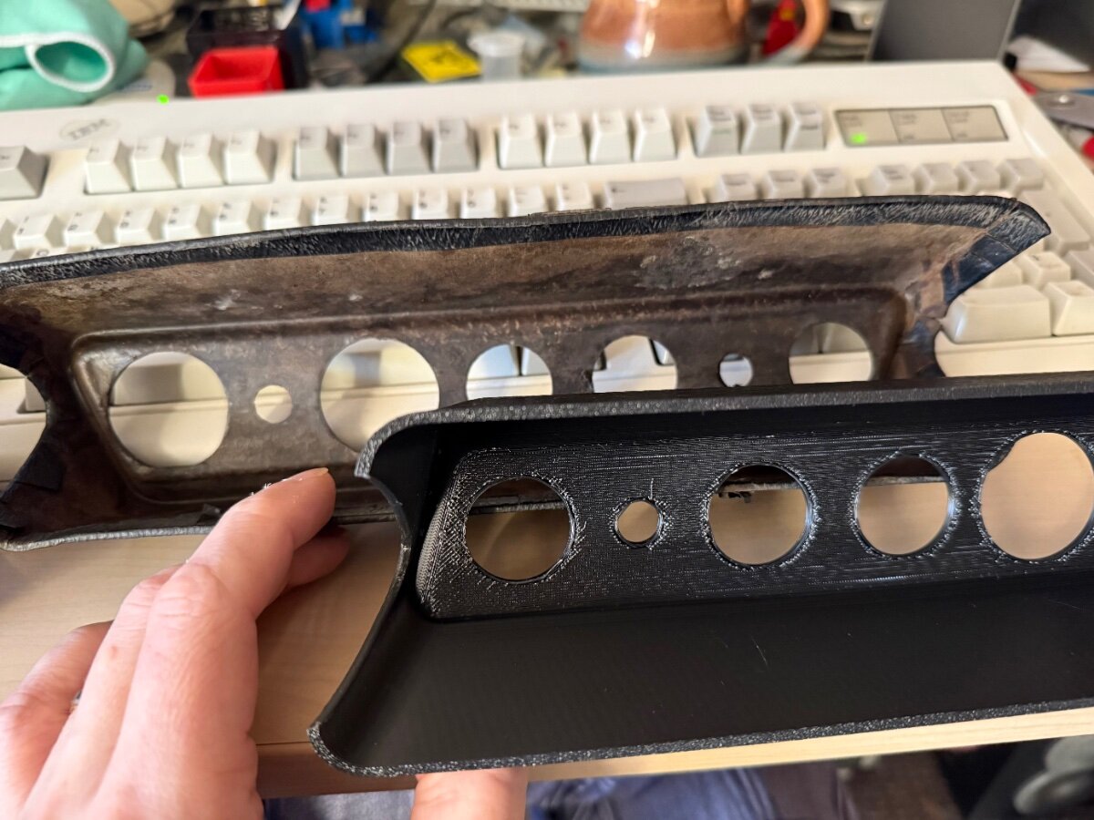

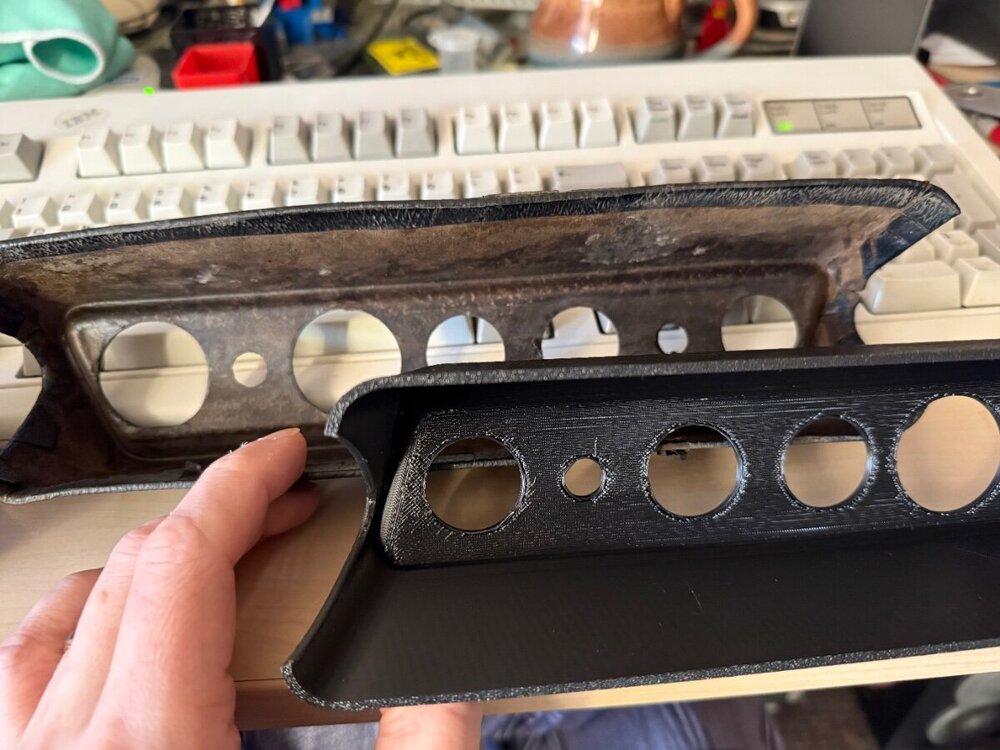

GreatOldOne Posted November 25, 2025 Author Report Posted November 25, 2025 Maybe this will help - top, original part. Bottom my repro. Both have the same internal / underside features and wall thicknesses. Quote
RogerH Posted November 25, 2025 Report Posted November 25, 2025 can you not reproduce that wavy/bent top edge Roger PS - well done Quote
GreatOldOne Posted November 25, 2025 Author Report Posted November 25, 2025 1 hour ago, RogerH said: can you not reproduce that wavy/bent top edge Anything’s possible… 🤪 Quote
