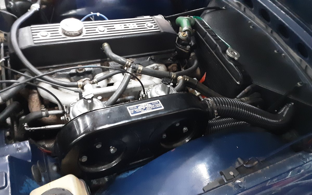

harlequin Posted October 26, 2025 Report Posted October 26, 2025 48 minutes ago, trchris said: George where did you pick up the two black air induct pipes from ? Chris Hi Chris Where most things come from these days! Amazon 🫣 This is the link https://www.amazon.co.uk/dp/B0DKXM5XC4?ref_=ppx_hzsearch_conn_dt_b_fed_asin_title_3&th=1 I also found a couple of flanges to connect it to the radiator shroud https://www.amazon.co.uk/dp/B0DB63VB3R?ref_=ppx_hzsearch_conn_dt_b_fed_asin_title_2&th=1 the pipe is a little big for the airbox so I put a couple of turns of electrical tape around the spiggots I'm pleased with the result the car runs well and induction noise is gone George Quote

trchris Posted November 28, 2025 Report Posted November 28, 2025 10 hours ago, Kenrow said: Be aware the TR250 did not have inlet hoses or a full shroud… Why didn’t the 250 have a full radiator shroud? And what should be there ? Chris Quote

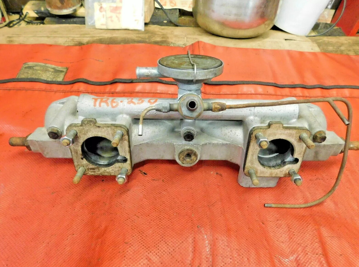

Kenrow Posted November 28, 2025 Report Posted November 28, 2025 (Sorry to divert from original post) If you are really trying to get your 250 to a concourse level: Air Deflector: Photos and part numbers are in the below post from the Triumph Experience Forum. The originals were cheepo carboard and did not last long. The replacements are the same (suggest applying a waterproof coating): TR250 Radiator Air Deflector Moss UK TR250 Air Deflector TR250 Intake Manifold: Photos of TR250 Intake Manifold with PCV (only on carb 250 and 69 TR6). These fit the narrow-spaced port heads that were on the 250 and early 6's. As far as air filter housing the TR250 had twin snorkels and a vent tube near the back carb. I have seen both black and silver housings over the years. The bottom photo is an official TR250 dealer's brochure - note bumble bee hoses which are available from a member of the Triumph Experience Forum (NFI): Quote
