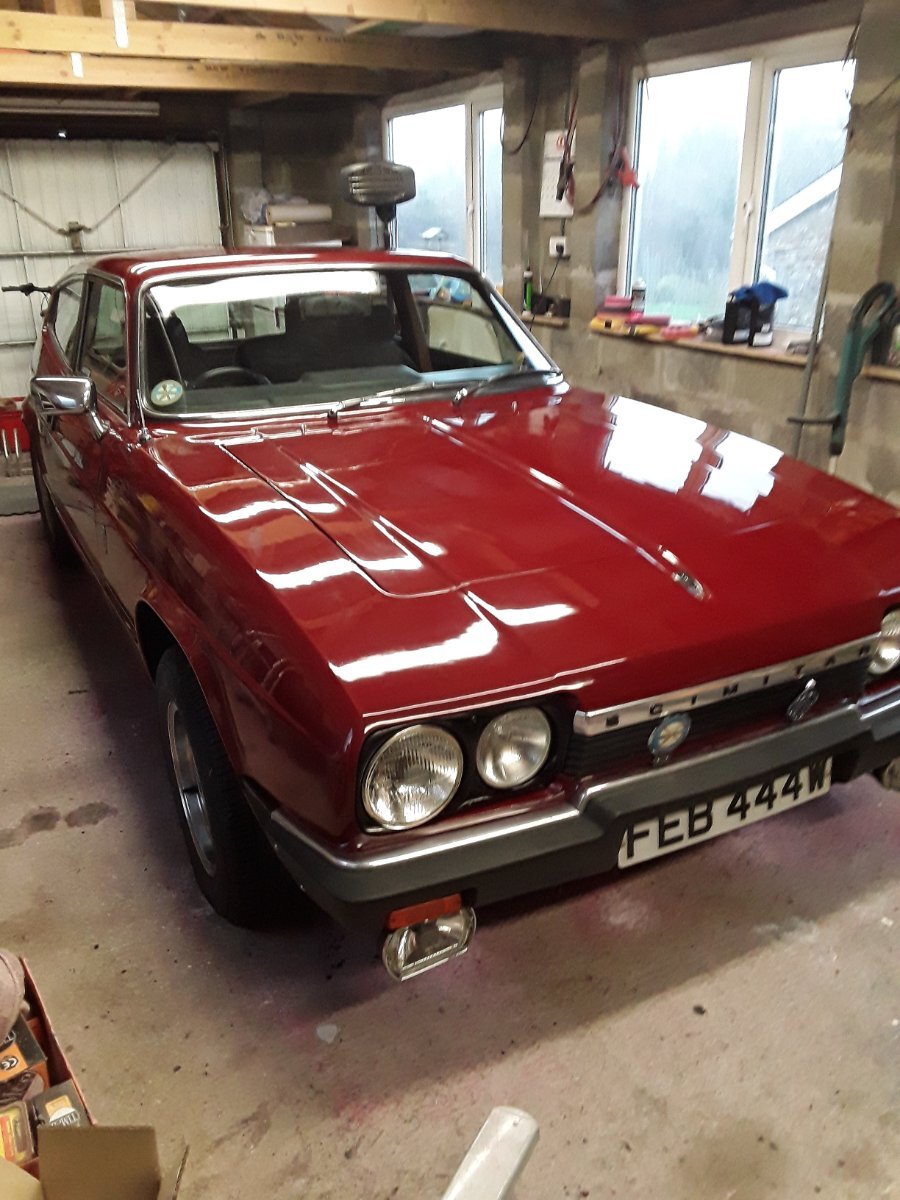

Trev Good Posted November 9, 2025 Report Posted November 9, 2025 Roger, when I did the total respray of my Scimitar with two pack, I spent a lot of time between mixing the paint and actual spraying, on making sure that the air to paint mixture coming out of the gun was correct on a test flat upright piece of metal (an old door or bonnet is perfect for this). Only when I was satisfied that the spray pattern was correct by adjusting the gun needle and air pressure from the compressor, and after many practice runs, did I commit to the car! I still needed to then use Faracla compound to get the best results afterwards! Incidently, I used three different moisture traps, a purpose built oil and moisture trap bought in, a homemade 10m long pipe trap with three returns and a final swirl pot on the gun. Quote
