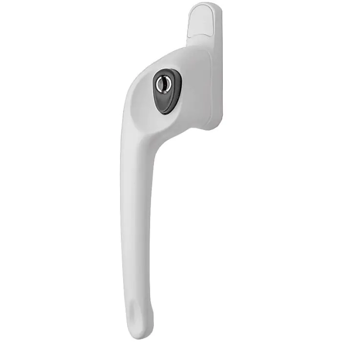

Trev Good Posted December 3, 2025 Report Posted December 3, 2025 What handles does your window have? If of the type in the photo, the glazing unit can be accessed from inside the room. If you prize the top plastic retainer out, stick some door draught excluder strip inside it and then refit. If you have the old cockspur handles, then the glazing unit may be external or internal fit, but still as above. However, the plastic retaining strips will probably be brittle with age, so best to leave until you can afford to upgrade. Quote
