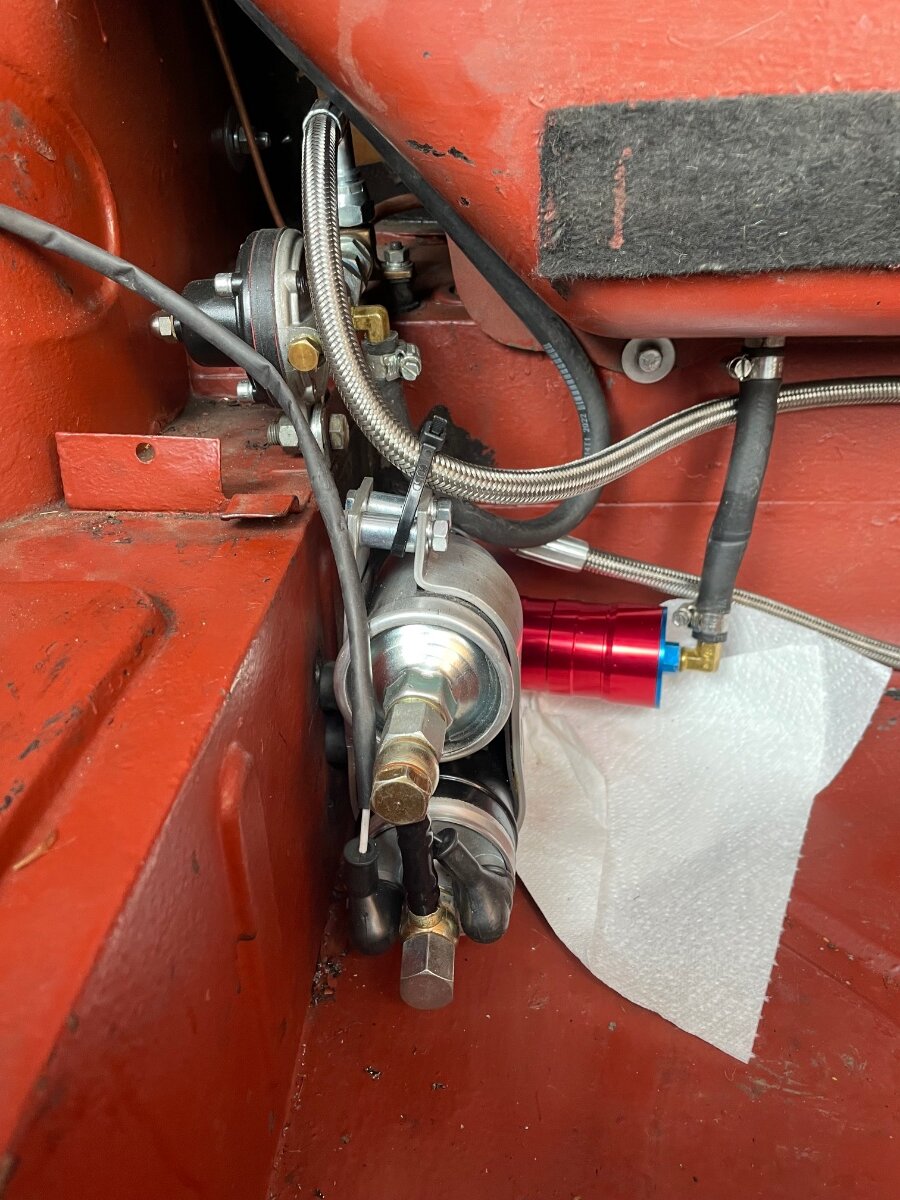

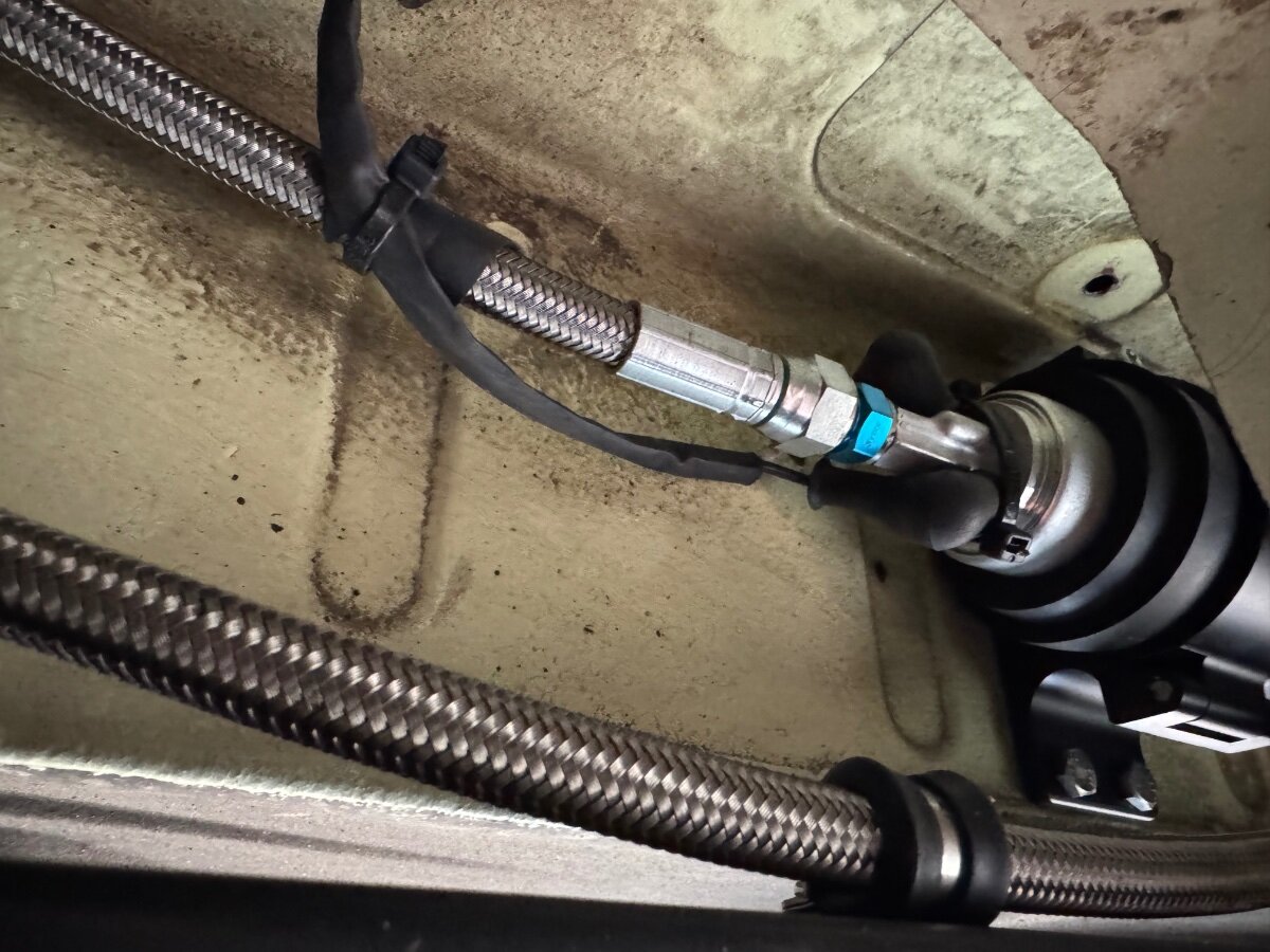

Steve-B Posted December 2, 2025 Report Posted December 2, 2025 James, here's links to 2 pictures of said valve. I didn't find the results strangely searching "This Forum" with "fuel AND cutoff" but did from the top level forum page...one shows it with a modern PRV and one with the original PRV... Quote

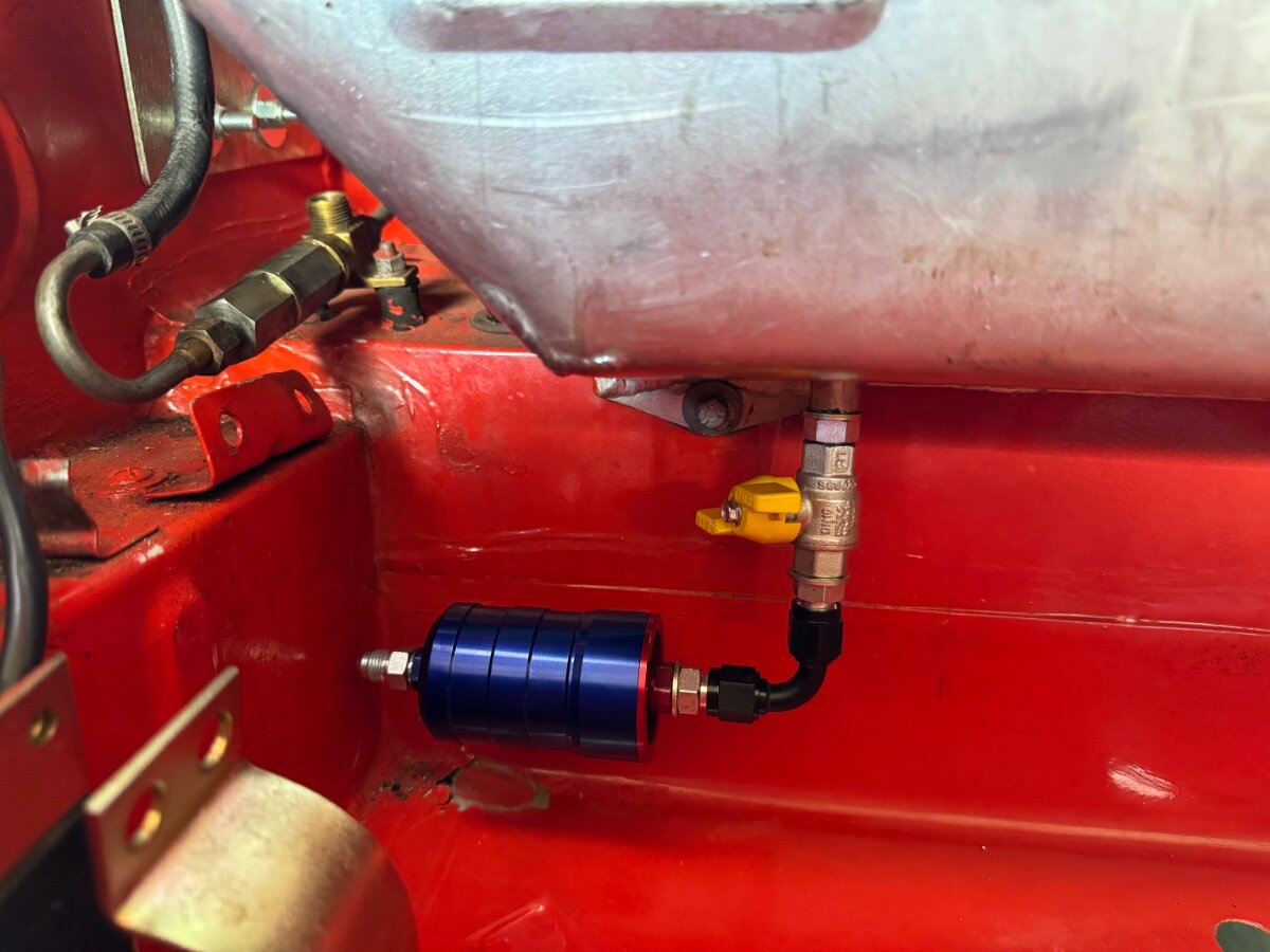

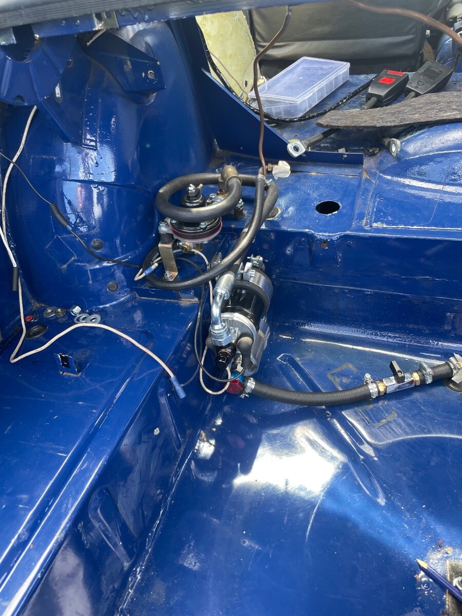

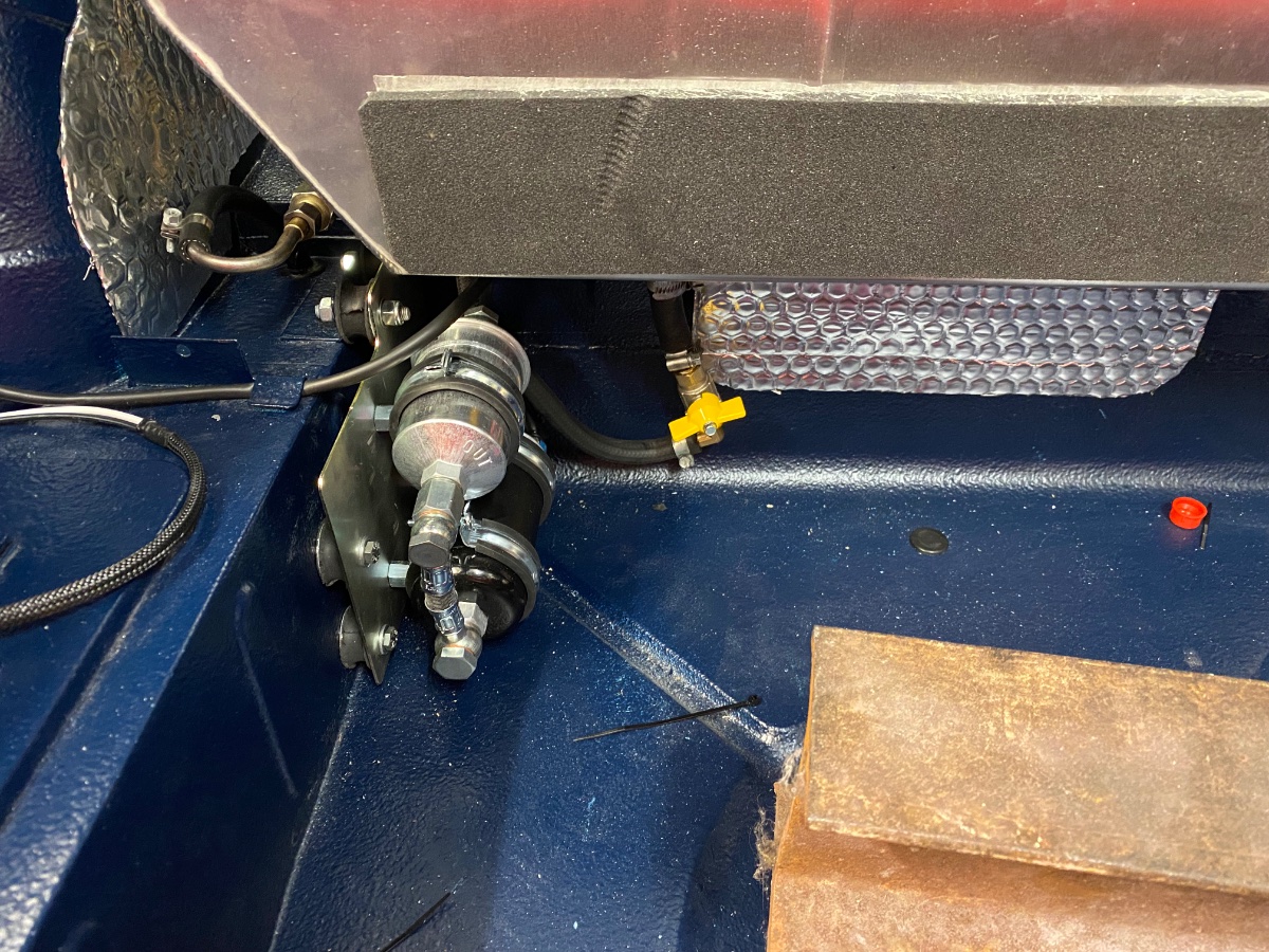

jimt Posted December 2, 2025 Report Posted December 2, 2025 (edited) I have this cut off tap set before a high flow fuel filter to make changing the filter easier. Then runs to a Bosch pump & filter fitted externally under the boot floor. Edited December 2, 2025 by jimt Quote

TR NIALL Posted December 3, 2025 Report Posted December 3, 2025 15 hours ago, jimt said: I have this cut off tap set before a high flow fuel filter to make changing the filter easier. Then runs to a Bosch pump & filter fitted externally under the boot floor. Jim any idea what size that top fitting is I have the Tap but can’t seem to find the correct fitting between it and Tank,Cheers. Quote
jimt Posted December 3, 2025 Report Posted December 3, 2025 Hi Niall Sorry don’t know - although I put the pre-filter in, the tap and fittings were already in place having been fitted by the PO as it comes as part of the revington Bosch pump kit RTR4050XK Quote
Chris Hale Posted December 3, 2025 Report Posted December 3, 2025 Niall Dont know what size that fitting is but it is readily available at hydraulic hose/parts suppliers I just took the outlet pipe fitting from my tank and the tap into them and got them to match the fitting which from memory they just took straight off the shelf Quote

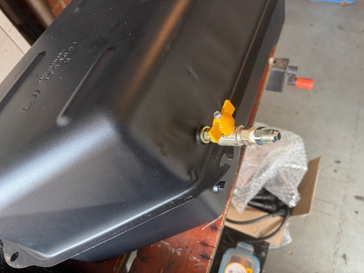

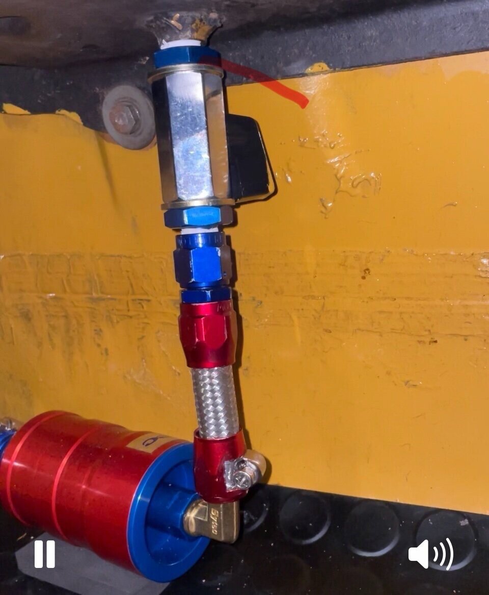

PodOne Posted December 3, 2025 Report Posted December 3, 2025 1 hour ago, harrytr5 said: https://www.ebay.co.uk/itm/263623144871 My favourite petrol tap. Made in Italy and 10mm bore. Lots of stockist's due to import cost's have pulled out stocking it which is a shame. Ebay is your friend here. I found a local to me that stocks this and the appropriate connectors between tap and tank and tap with either a push on barb connector or my favourite Jic 6. Lovely bit of kit. Regards Harry +1 That's the one I used in the Pic above which is my car before I changed the PRV to a modern diaphragm type. I think the connection could be improved by eliminating the short rubber section from the tank to tap. Currently have a 10mm outlet from the tank bought from TRGB. As an alternative can anyone advise a brass 10mm fitting to screw direct into the tank and the tap? Thereby eliminating the short rubber section. Thanks Andy Quote
FBM Posted December 3, 2025 Report Posted December 3, 2025 9 minutes ago, PodOne said: +1 That's the one I used in the Pic above which is my car before I changed the PRV to a modern diaphragm type. I think the connection could be improved by eliminating the short rubber section from the tank to tap. Currently have a 10mm outlet from the tank bought from TRGB. As an alternative can anyone advise a brass 10mm fitting to screw direct into the tank and the tap? Thereby eliminating the short rubber section. Thanks Andy Is that TRGB 10 mm outlet a direct replacement for the original one? I’d like to standardize all the hoses on 10 mm Gates Barricade, but at the moment the hose from the tank is in 8 mm to match the current tank outlet size. Quote
PodOne Posted December 3, 2025 Report Posted December 3, 2025 (edited) 36 minutes ago, FBM said: Is that TRGB 10 mm outlet a direct replacement for the original one? I’d like to standardize all the hoses on 10 mm Gates Barricade, but at the moment the hose from the tank is in 8 mm to match the current tank outlet size. Yes it screwed straight into the tank outlet Prestige offer one also likely the same fitting. Edited December 3, 2025 by PodOne More info Quote

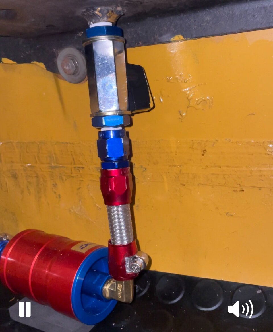

harrytr5 Posted December 3, 2025 Report Posted December 3, 2025 2 hours ago, harrytr5 said: https://www.ebay.co.uk/itm/263623144871 My favourite petrol tap. Made in Italy and 10mm bore. Lots of stockist's due to import cost's have pulled out stocking it which is a shame. Ebay is your friend here. I found a local to me that stocks this and the appropriate connectors between tap and tank and tap with either a push on barb connector or my favourite Jic 6. Lovely bit of kit. Regards Harry Quote
PodOne Posted December 3, 2025 Report Posted December 3, 2025 36 minutes ago, harrytr5 said: Hi Harry You appear to have achieved what I wanted to do👍 can you advise where it from and which fitting you used from the tank to tap. I have need to remove the tank to calibrate the sender so it would make sense to copy your solution. Thanks Andy Quote

harrytr5 Posted December 3, 2025 Report Posted December 3, 2025 2 hours ago, PodOne said: Hi Harry You appear to have achieved what I wanted to do👍 can you advise where it from and which fitting you used from the tank to tap. I have need to remove the tank to calibrate the sender so it would make sense to copy your solution. Thanks Andy Andy , I will have a look in my paperwork tomorrow and let you know. If I remember it was 1/4 BSP to tap and *1/2" UNF to tank and drilled a *bigger hole in the union hence the safety of the doughty washer and PTFE tape to seal. From tap 1/4 BSP to JIC 6 to then connect up to braided teflon pipework where I make up the aero fittings from Speedyflow. Not cheap but the best. I changed my Applemac as too old to my super Apple lap top and lost the majority of my pics which is annoying to say the least. Regards Harry Quote
PodOne Posted December 3, 2025 Report Posted December 3, 2025 Thanks Harry like your solution even more with the pre filter. I get mixed up with all the various threads/adapters! I'm no expert but have you considered syncing your Mac to Apples i cloud that way you will never loose anything. You can also link your i phone as well if you have one. Andy Quote
