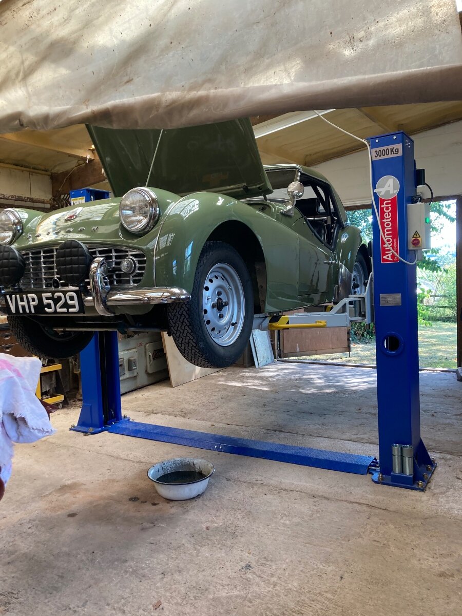

iain Posted December 6, 2025 Report Posted December 6, 2025 (edited) I bought a Automotech two post lift this summer. Short and narrow version. It’s an absolute game changer. Why I haven’t gone this route sooner I can not explain. https://automotechservices.co.uk/products/as-230nsp-3-0t-capacity-short-narrow-2-post-lift/ Max lift is 1.5m, seems low, but for 95% of jobs it’s more than enough. When I need to be underneath, I sit on an old milk crate with a ply lid on it. Couldn’t be happier. Delivery was impressively quick and support with installation excellent. Iain Edited December 6, 2025 by iain Quote

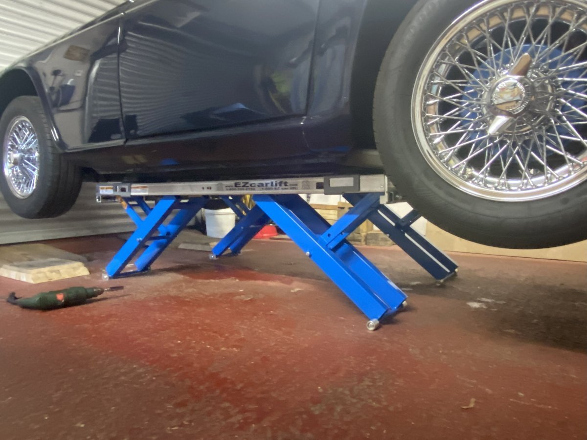

8iggles Posted December 6, 2025 Report Posted December 6, 2025 (edited) I used two trolley jacks, axle stands, ramps and various blocks of wood for years What a palaver! I was recommended the EZ lift which, I bought: I like it. With my power drill it is so easy to jack up the TR, and it is very stable. I have a wheeled crawler board which fits between the ramps. In the winter the EZ stays under the TR. In summer it hangs on the wall. I still use the axle stands etc to spread the weight when necessary. The EZ is heavy and difficult to hang on the wall on my own. My financial advisor helps. Due to the weight I secure it to the wall with a chain for safety. When the TR4A IRS is up on the EZ lift the rear (and front?) of the TR are not supported. If suspended for any length of time I lower the TR onto the axle stands. John Edit: I was not aware of the race ramp wheel block things before but if they would compliment the EZ lift. When's Christmas? Edited December 17, 2025 by 8iggles Added Image and comment. Quote

Don H. Posted December 6, 2025 Report Posted December 6, 2025 7 hours ago, iain said: That looks terrific, Iain! Very nice. Do you use the lift for any other vehicles? Have you found the width or weight capacity to be a limitation in any way? And most of the time, two-poat lifts have specific requirments for concrete floor thickness for mounting the posts. Was that a requirement for your lift, one it looks like your garage floor met? Quote
TR NIALL Posted December 6, 2025 Report Posted December 6, 2025 50 minutes ago, Don H. said: That looks terrific, Iain! Very nice. Do you use the lift for any other vehicles? Have you found the width or weight capacity to be a limitation in any way? And most of the time, two-poat lifts have specific requirments for concrete floor thickness for mounting the posts. Was that a requirement for your lift, one it looks like your garage floor met? Looks as if Ian had to put in a reinforced section across the width of the Lift. Quote
Don H. Posted December 6, 2025 Report Posted December 6, 2025 (edited) 4 hours ago, TR NIALL said: Looks as if Ian had to put in a reinforced section across the width of the Lift. Possibly, Niall — you’re referring to what looks like a new concrete section where the posts are? Sometimes people pour new squarish sections for the posts, too. Edited December 7, 2025 by Don H. Quote
TR NIALL Posted December 7, 2025 Report Posted December 7, 2025 9 hours ago, Don H. said: Possibly, Niall — you’re referring to what looks like a new concrete section where the posts are? Sometimes people pour new squarish sections for the posts, too. Yes Don that’s the section I’m referring too. Quote

iain Posted December 7, 2025 Report Posted December 7, 2025 (edited) Don/Niall, the shed floor was laid years ago and I wasn’t sure of the thickness or concrete grade.I drilled some test holes to check the thickness and found it to be marginal. Rather than take a risk, I had the floor dug out to a depth of 400mm (150 was the guidance). Width and length to the suppliers spec( I could have done two squares but decided it made little difference to the cost.) Added steel reinforcing, some driven under the existing slab and then filled with the appropriate grade of concrete. Left alone for 6 weeks before drilling for the mountings expansion bolts. So far Don I’ve only lifted the Tr and the Elan. It’s rated to 3000kg so I could lift other stuff, but to tbh I don’t play with the moderns. Width might be a problem with door opening, given the size , but they do another version that would solve that issue. In what could be a “world first” my wife has just described it as a good investment 😀…….oh dear this could get expensive😂 Iain Edited December 7, 2025 by iain Quote

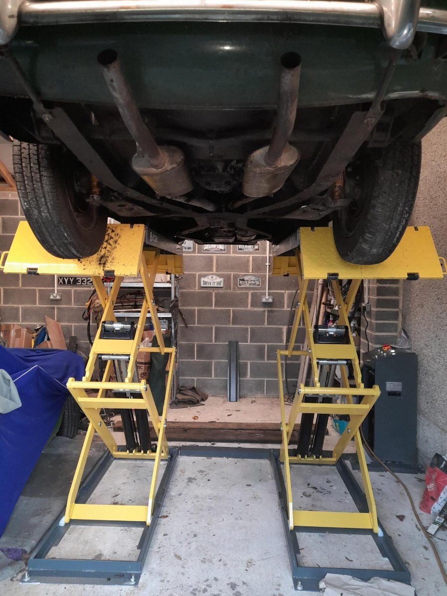

Phil Read Posted December 7, 2025 Report Posted December 7, 2025 I recently bought a full height 3.5 tonne scissor lift. Its brilliant I should have done it years ago. You do need a garage with headroom though. Quote

Phil Read Posted December 7, 2025 Report Posted December 7, 2025 My garage is just wide enough for 2 cars. I wanted a lift so I could still park 2 cars side by side. A scissor lift allows me to do this. The control box can be fit anywhere with in reason so there is plent of the room to work on the car either side and open doors. Quote

Don H. Posted December 8, 2025 Report Posted December 8, 2025 On 12/6/2025 at 7:35 AM, iain said: @iain, I think we use the same oil drain pan! Quote
iain Posted December 8, 2025 Report Posted December 8, 2025 (edited) 23 hours ago, Don H. said: @iain, I think we use the same oil drain pan! Ha that’s funny😂 Edited December 9, 2025 by iain Quote
