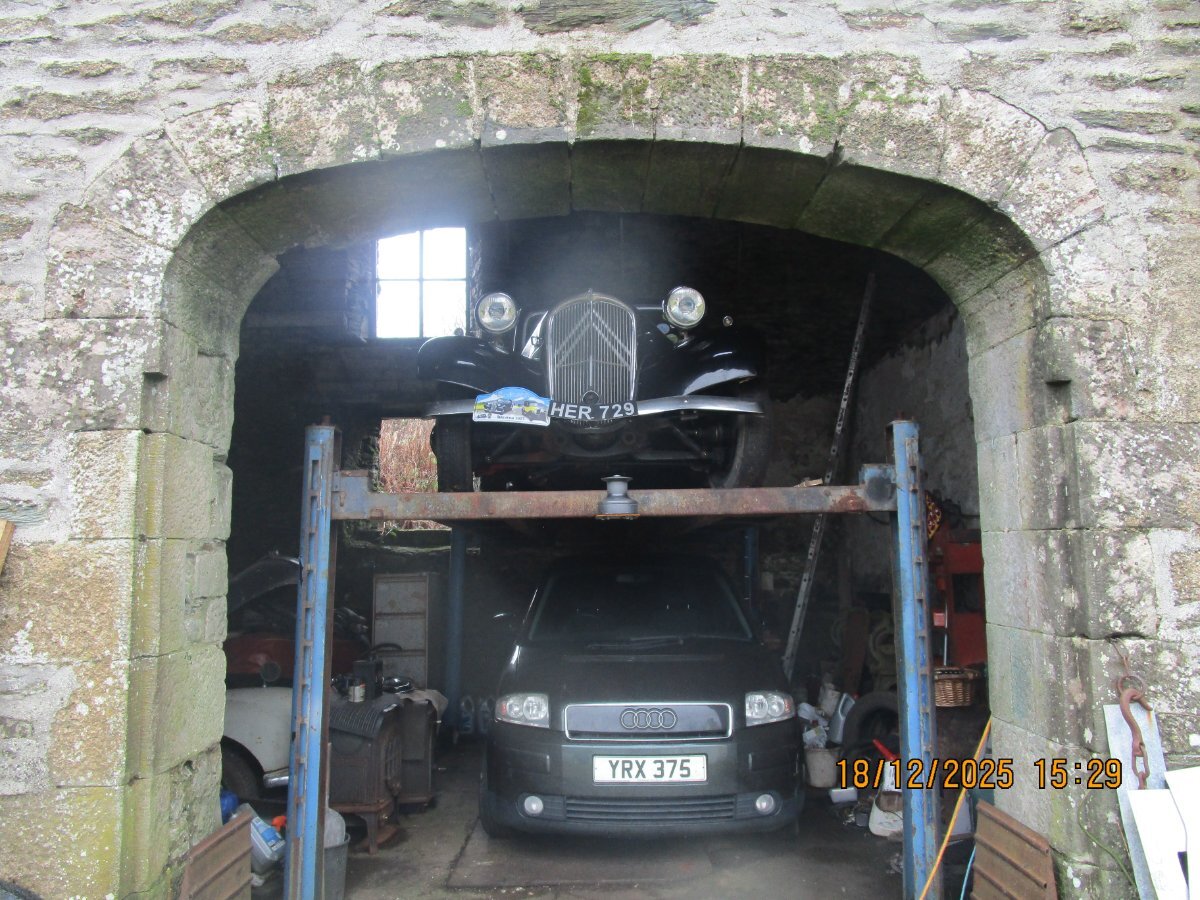

harlequin Posted December 19, 2025 Report Posted December 19, 2025 That wall looks like it ain't going to fall down any time soon Dic Quote
harrytr5 Posted December 19, 2025 Report Posted December 19, 2025 26 minutes ago, Dic Doretti said: No doors! You guys are tough up there! Regards Harry Quote
harlequin Posted December 19, 2025 Report Posted December 19, 2025 Doors? Don't you mean Portcullis 🤣 George Quote

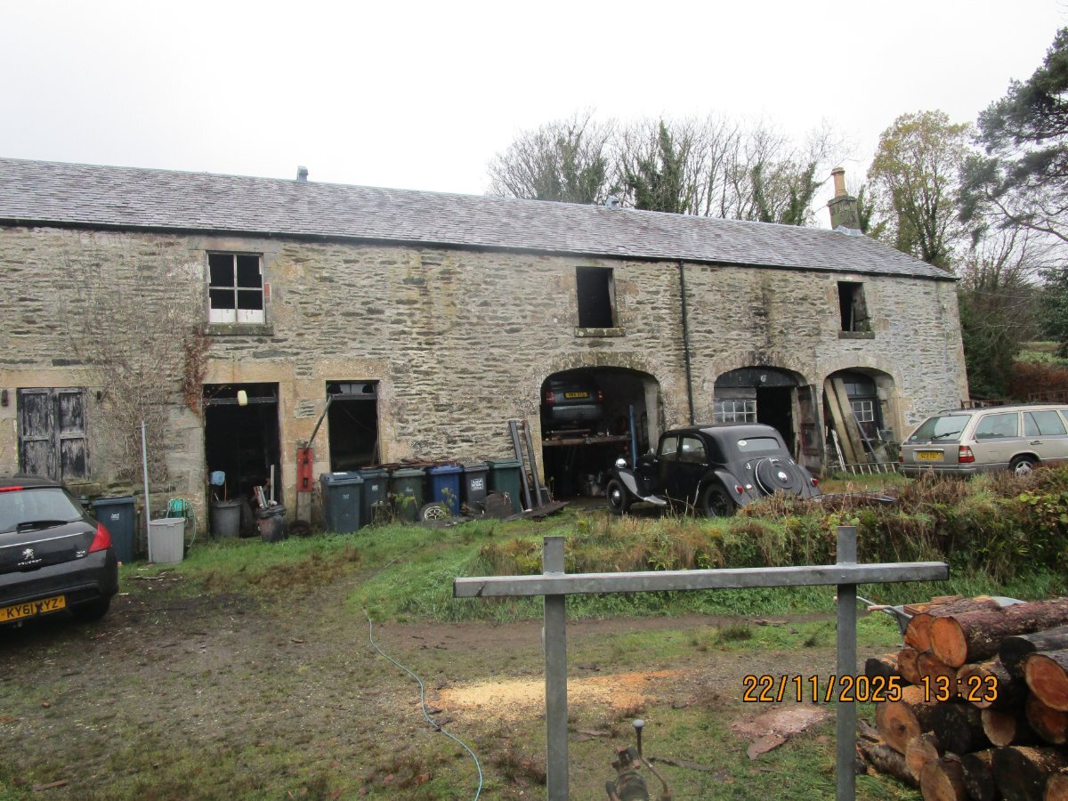

Dic Doretti Posted December 19, 2025 Report Posted December 19, 2025 The cars are well catered for living in an almost 200 year old coach house while I live in an adjacent 2 up 2 down cottage! Quote

harlequin Posted December 19, 2025 Report Posted December 19, 2025 1 hour ago, Dic Doretti said: The cars are well catered for living in an almost 200 year old coach house while I live in an adjacent 2 up 2 down cottage! That looks timeless Dic especially with the Light 15 in the photo Quote
TR NIALL Posted December 20, 2025 Report Posted December 20, 2025 4 hours ago, harlequin said: That looks timeless Dic especially with the Light 15 in the photo Even more timeless now. Quote

harrytr5 Posted December 20, 2025 Report Posted December 20, 2025 20 hours ago, TR NIALL said: Even more timeless now. loose the bins and perfect! regards Harry Quote
