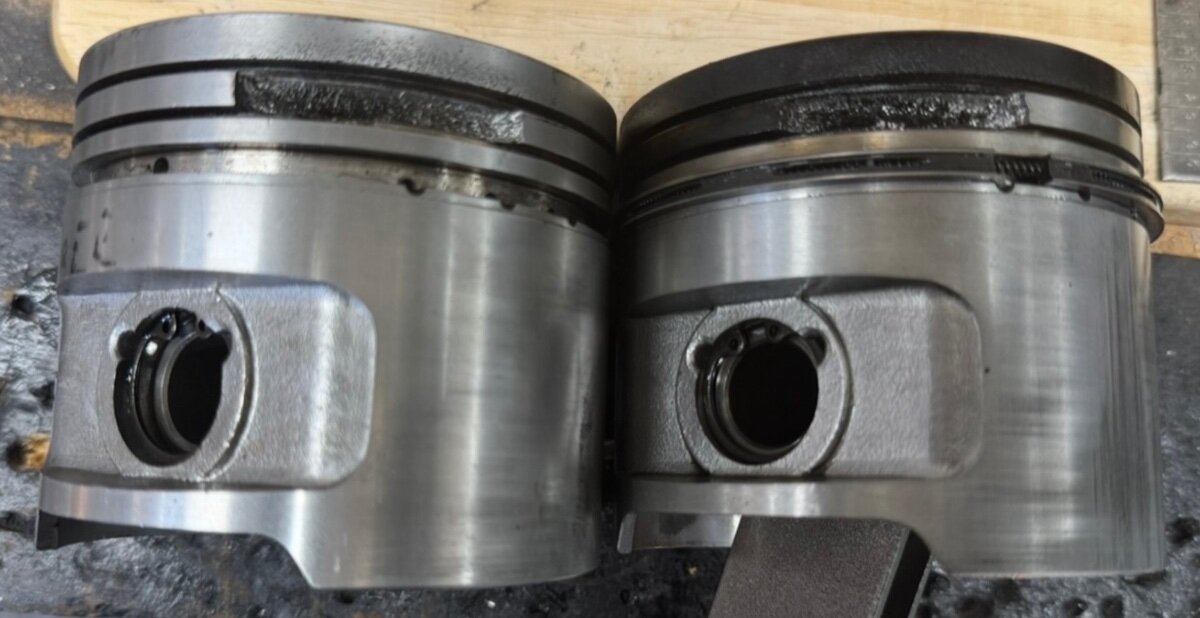

Ecosse Posted December 8, 2025 Author Report Posted December 8, 2025 Thanks to all for your thoughts, and I sometimes marvel at my own ineptitude. After thoroughly cleaning the pistons crowns of light carbon deposits and oil from the compression check I have discovered cracks on the crowns of Nos. 1 and 4, so I guess that is the issue. The next issue is what caused the damage, I have two front runners. Perhaps 'Standard' spec pistons are not up to the rigors of competition, I investigated forged pistons, the cost seemed disproportionate but I guess I may have to bite the bullet. The other possibility may be mechanical in that the block was skimmed just enough to clean up the mating face, which resulted in a slight protrusion the pistons by differing amounts of up to five thou maximum, Nos. 2 and 3 having the greatest protrusions, obviously there are some manufacturing tolerances in the pistons. I was assured by my machine man, who also builds competition engines, that this would not be an issue, perhaps I should have had the pistons machined. The staggering thing is that the car ran well, if a tad smokey, despite the issues. Anyway, the engine has to come out and be rebuilt. Hindsight is a marvelous thing, thanks again to all for your comments. Regards, Cliff Quote
