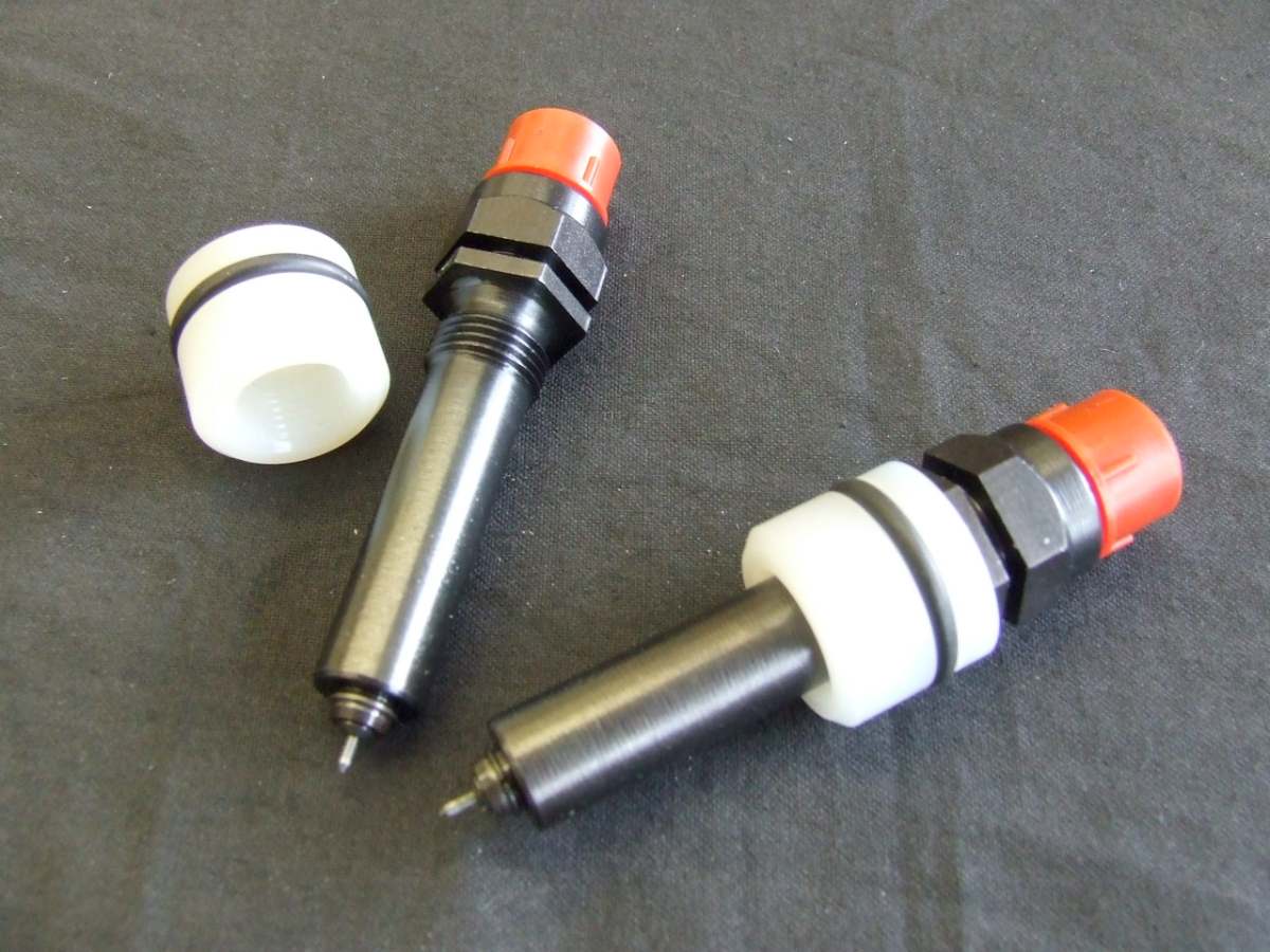

john.r.davies Posted December 12, 2025 Report Posted December 12, 2025 The injectors spray when a pulse of pressure from the M/u artives, and overcomes the tension in the internal spring. So continuous spray says that the injector needle is stuck open. Debris in the system? Hokd the valve WIDE open briefly, by gripping the needle in the finger nails ( never pliers!) In the hope that 'bits' will wash out. John Quote

brucer Posted December 12, 2025 Author Report Posted December 12, 2025 Thank you both. I've tried exactly what you suggest, but no change. The spray pattern looks perfect, it's just spraying all the time the pump is running. I'm suspecting that something has gone wrong with the metering unit, hoping it's not that. Bruce Quote

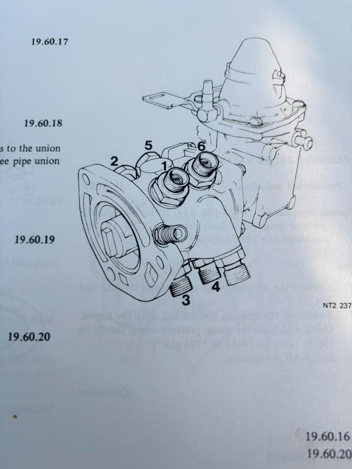

Spit_2.5PI Posted December 12, 2025 Report Posted December 12, 2025 Bruce, the space between the alloy body and the steel sleeve of the MU is full of petrol at continuous pump pressure. The nose of the outlet connection (which contains the one-way valve) goes through this gap and seals on the sleeve. I wonder if this seal has broken down somehow. Perhaps the outlet connection is no longer tight in the body? Cheers, Richard Quote
john.r.davies Posted December 12, 2025 Report Posted December 12, 2025 (edited) Bruce, Do you have The Manual? See: https://www.lucasinjection.com/MANUALS.htm And Page 3. The body and sleeve in the M/u should be so tight that pressure can't get through. The sleeve rotates to open each port to the injectors and delver a pulse. If the sleev was so worn that pressure does get through , then it would cause continuous squirting from all injectors. IMHO, of course. JOhn PS The Wheatsheaf Press used to publish a facsimile copy of the original manual. They are now "Wheatsheaf Print" and I don't know if the Manual is still in print, and they don't have a website, but are at: Wheatsheaf Print, The Printworks Lacey Green, Wilmslow, SK9 4BQ Directions Tel: 01625 530530 J. Edited December 12, 2025 by john.r.davies Quote
Peter Cobbold Posted December 12, 2025 Report Posted December 12, 2025 If the continuous-spraying injector changes after turning the engine over, it suggests to me that the shuttle is allowing fuel to pass to whichever port is open. A worn shuttle could do that. But the engine may still run OK under load, when the shuttle excursion is allowed to increase. Peter Quote
brucer Posted December 12, 2025 Author Report Posted December 12, 2025 Thanks for those suggestions. I'll go and do some more investigation. @Richard I'll check and make sure they are tight. @John I don't have the Lucas Manual, but the website you linked to was very informative. @Peter I have found that if I can get the engine to run without it getting totally flooded, it does run OK under load but terrible at tickover. Sounds like I might be in for a new/reconditioned metering unit. Bruce Quote

brucer Posted December 12, 2025 Author Report Posted December 12, 2025 Just had another tinker and things have changed. The injector that was spraying continuously has now stopped. 2 other injectors are dripping slowly so not sealing properly. I'm now wondering if the "Reconditioned" injectors I bought were a waste of time. They did come from K Raven Smith on Ebay. Might go for a new set. even though they are mighty pricey. @Ralf, thanks for that information. I think I'll take another look tomorrow, and if it's not spraying continuously, I'll take it for a run up the road. I will report back tomorrow. Thank you again for all your help. Bruce Quote
Trev Good Posted December 12, 2025 Report Posted December 12, 2025 Some reconditioners simply blow compressed air or fuel through an injector, then call it reconditioned. I'm not suggesting the person you bought from did just this, but it happens! Quote

k_raven_smith Posted December 13, 2025 Report Posted December 13, 2025 Regarding the the injectors I reconditioned for you I can assure you I DON'T just blow air through them. As for the leaking this is normal and allowed by Lucas in their workshop manual. The problem is more likely to be the bung seals in the metering being passed there best. Neil Fergusson (k- Raven-Smith) Quote
Spit_2.5PI Posted December 13, 2025 Report Posted December 13, 2025 23 hours ago, john.r.davies said: And Page 3. The body and sleeve in the M/u should be so tight that pressure can't get through. The sleeve rotates to open each port to the injectors and delver a pulse. If the sleev was so worn that pressure does get through , then it would cause continuous squirting from all injectors. IMHO, of course. I would just take issue with you there John. It's the ROTOR which rotates. The sleeve is fixed within the body of the MU, not least because the nose of each outlet (screwed into the body) seals in the various orifices of said sleeve, fixing the position. My point is that if the seal (an o-ring?) of one of these outlets was faulty, that would give the path for pump-pressure fuel to that ONE injector, whatever the position of the rotor. Cheers, Richard Quote

Steve-B Posted December 19, 2025 Report Posted December 19, 2025 @brucer You might want to consider removing the injectors, injector hoses and MU as a group and sending to Carl at TR Trader. He'll completely recondition, bench test, new Vitron seals, and diaphrams for a reasonable price. Then you'd have the knowledge of that part of the system being up to current spec. I'm about to send him my spare MU to do just it so I have it ready just in case... Quote

brucer Posted May 4 Author Report Posted May 4 Thank you, everyone, for your help and a special thank you to Martin Giles (Fred Millturn) for his superb service. My injection system is now sorted with a reconditioned Metering unit and Injector pipes. I think my main problem was that 2 of the injector pipes had failed and were leaking. Changing the metering unit was a fiddly job, but would be much easier if I hade to do it a second time now I know what tools to use for which bolts.😄. Regards Bruce Quote

Andy Moltu Posted May 5 Report Posted May 5 A leaking injector pipe wouldn’t explain continuous spraying from the injector. More likely a failed seal in the metering unit. Injector fails usually manifest themselves as dribbling, irregular spray pattern or non injecting. 9 times out of 10 it’s crud/debris in the injector for which the solution is usually blowing through with an airline. The small internal o-rings do fail eventually and are simple enough to replace unless they are of the “crimped tip” variety. Quote
