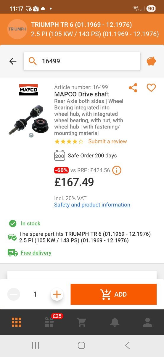

DRD Posted January 17 Report Posted January 17 22 hours ago, trchris said: Has anyone got these to give a review? I’m just curious why they are such good value as the old saying “ cheap for a reason “ comes to mind . They probably are excellent value for money so any feedback would be appreciated as l have one rear hub with slight play and possibly needs replacement these maybe the way forward Chris I've ordered some so will give them a close scrutiny when I get them. If they look poor quality I'll send them back. Quote
15eren Posted January 17 Author Report Posted January 17 (edited) Hi all As a thread-starter I will have to make some things clear: The YouTube video in Z320-post is made by me. And it is not a video that shows the Mapco-shaft from Autodoc_shop. The video shows a CDD-shaft (Classic Driving Development) at a price four-times the Mapco-shafts from Autodoc_shop. The CDD-shafts had a lot of play resulting in clonk. I have removerd the boots on the CDD-shaft and can confirm that the play is definately in the splines and not the CV-joints. The new Mapco-shafts that I have now installed looks exactly the same but there is no play what so ever so I look forward to make my first drives when spring comes. Another difference between the Mapco-shafts and the CDD-shafts is that the Mapco-shafts have hubs made of steel instead of alloy. But I do not see that as a disadvantage. Cheers Tage Edited January 17 by 15eren Quote
Z320 Posted January 17 Report Posted January 17 20 minutes ago, DRD said: I've ordered some so will give them a close scrutiny when I get them. If they look poor quality I'll send them back. If you want to fit them, here is the instruction from Limora (for the case the shafts come without). There you find the distancers and order numbers. Quote
Z320 Posted January 17 Report Posted January 17 (edited) 22 minutes ago, 15eren said: Hi all As a thread-starter I will have to make some things clear: The YouTube video in Z320-post is made by me. And it is not a video that shows the Mapco-shaft from Autodoc_shop. The video shows a CDD-shaft (Classic Driving Development) at a price four-times the Mapco-shafts from Autodoc_shop. The CDD-shafts had a lot of play resulting in clonk. I have removerd the boots on the CDD-shaft and can confirm that the play is definately in the splines and not the CV-joints. The new Mapco-shafts that I have now installed looks exactly the same but there is no play what so ever so I look forward to make my first drives when spring comes. Another difference between the Mapco-shafts and the CDD-shafts is that the Mapco-shafts have hubs made of steel instead of aloy. But I do not see that as a disadvantage. Cheers Tage Hi Tage, good to know it is your video. This is the most interesting link to tthem at the TR-Freunde-Forum. https://tr-freun.de/phpBB3/viewtopic.php?t=17218&hilit=fag Translation should be no problem these days, to see the very intersiting photos you have to register and lock in. There are 2 other threads about, but they are endless and not much entertaining. Ciao, Marco Edited January 17 by Z320 Quote
dblenk Posted January 18 Report Posted January 18 Hi if its too good to be true then there is normally an issue i have a little play on one side on the hub bearing the other side is ok they are original 76 hubs i was thinking of new hubs as people say they are £360 a side from moss so these units look great the back end is next winters job so will monitor feed back on these and ready with a credit card it also replaces the original drive shaft i have as Marco said if on a long tour 2-3000 miles then you dont want any problems look forward to info David Quote
trchris Posted January 18 Report Posted January 18 David you are in the same situation as me and l also have some doubts on the quality of these driveshafts for the price they are however that may be me being too cynical so I’m also , before l buy a new hub, waiting for some feedback although Marco has provided some . There’s been some discussion previously in the forum of some problems with cv jointed shafts so will sit on the fence a bit longer before making a final decision Chris Quote
dblenk Posted January 18 Report Posted January 18 1 hour ago, trchris said: David you are in the same situation as me and l also have some doubts on the quality of these driveshafts for the price they are however that may be me being too cynical so I’m also , before l buy a new hub, waiting for some feedback although Marco has provided some . There’s been some discussion previously in the forum of some problems with cv jointed shafts so will sit on the fence a bit longer before making a final decision Chris yeah did my main bearings at xmas and thought treat the car to new bolts £10 from a TR company when i tightened them one didnt torque up just kept going i was lying under the car looking up thinking new engine i just stripped the block threads totally gutted like really gutted A friend said dont fit new bolts put the old ones back in so i did and tightened up great panic over although i have a spare engine yes cynical over quality these days would like a few more positives before i press the button David Quote
harlequin Posted January 18 Report Posted January 18 I'm another who will have to climb down from the fence in the near future and spend money on hubs and drive shafts, Tag's post has certainly caused interest and I shall look forward to feedback. A friend has had problems with CV jointed drive shafts failing on his TR5 which is now resolved after twice replacing a shaft. The solution was somthing to do with the distance between the dif flange and the hub mounting point being slightly out of the acceptable range on one side, I believe he inserted a shim on the dif to shaft joint. George Quote
trchris Posted January 18 Report Posted January 18 18 minutes ago, harlequin said: I'm another who will have to climb down from the fence in the near future and spend money on hubs and drive shafts, Tag's post has certainly caused interest and I shall look forward to feedback. A friend has had problems with CV jointed drive shafts failing on his TR5 which is now resolved after twice replacing a shaft. The solution was somthing to do with the distance between the dif flange and the hub mounting point being slightly out of the acceptable range on one side, I believe he inserted a shim on the dif to shaft joint. George Hi George l read about measuring this distance on a previous post and l wonder if others are aware about it ? I take it they will come with instructions detailing this otherwise there maybe some more failures. I hope we get some feedback before the offer ends. Chris Quote
