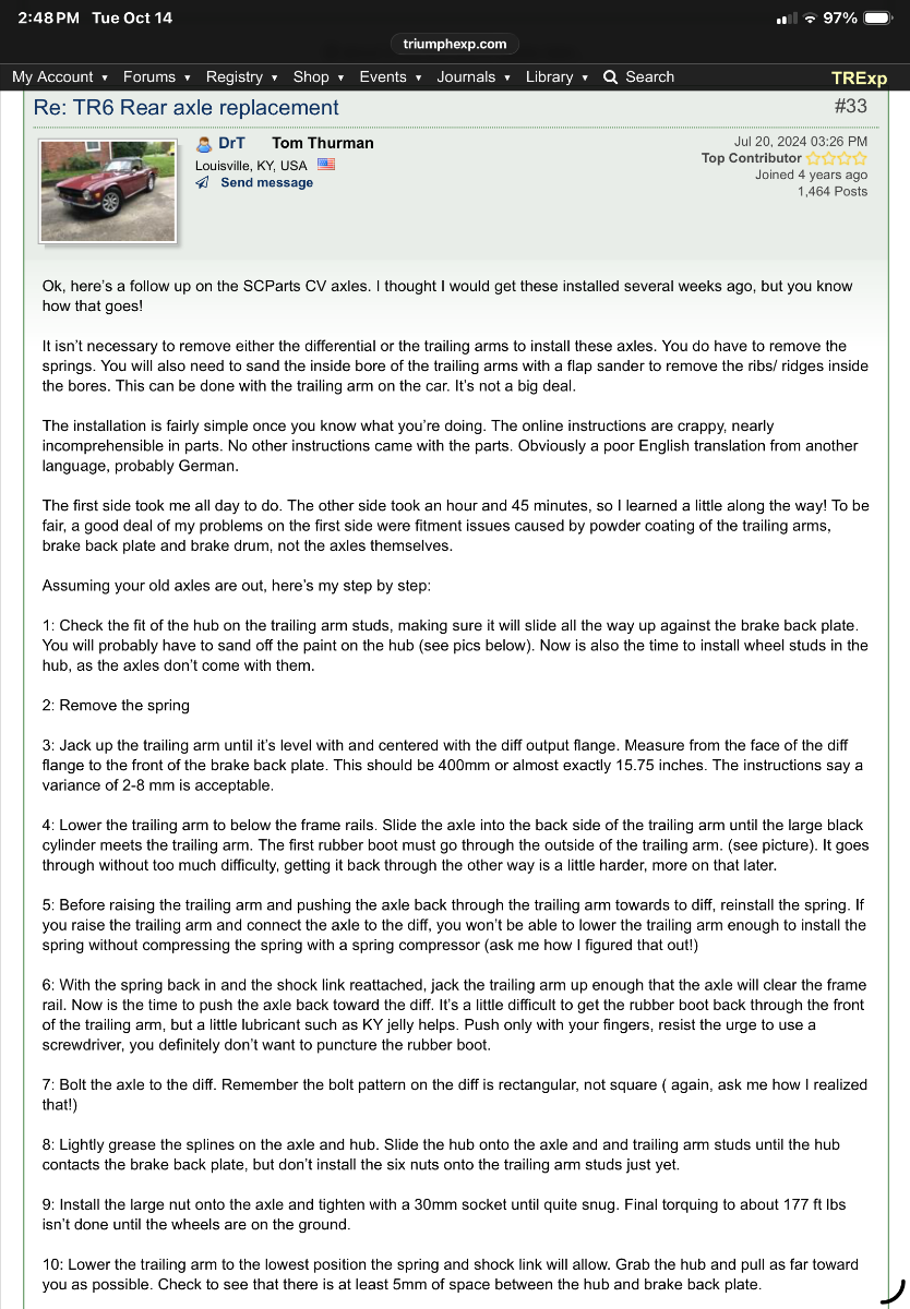

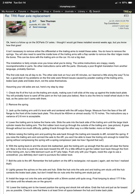

charlie74 Posted January 20 Report Posted January 20 (edited) 177 ftlbs for the hub nut. I have a good summary of another forum members experiences installing these axles which is much more understandable than the supplied instructions but this forum will not let me upload the image. PM me if you would like them… Edited January 20 by charlie74 Quote
DRD Posted January 20 Report Posted January 20 44 minutes ago, charlie74 said: 177 ftlbs for the hub nut. I have a good summary of another forum members experiences installing these axles which is much more understandable than the supplied instructions but this forum will not let me upload the image. PM me if you would like them… Yes please, that would be great. Many thanks Darren Quote
