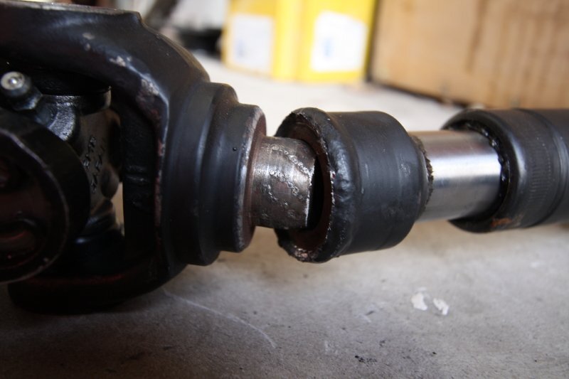

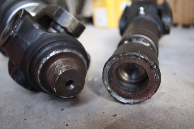

stuart Posted March 17 Report Posted March 17 3 hours ago, rcreweread said: John - I'm glad you clarified this because as far as I know, I've never heard of a TR IRS half shaft ( or driveshaft , same thing) breaking. Apart from replacing worn UJs on the ends of the driveshaft, you can't recondition a driveshaft - once the splines wear, and if you can feel anything other than minimal play in the splined joints when you twist them is opposite directions, then they are scrap. Best replacements are the blue Rislan coated ones from Proptech in Kidderminster if you want to stick with the original set up Cheers Rich Au contraire Im afraid. Pictures sent to me a while ago by Niall. New supplied shafts (Not Proptech) snapped due to poor welding. Stuart. Quote
RogerH Posted March 17 Report Posted March 17 I can weld like that I like the way they have struck an arc on the male fitting to make it a better fit in the female - or am I being cynical Roger Quote
rcreweread Posted March 17 Report Posted March 17 1 hour ago, stuart said: Au contraire Im afraid. Pictures sent to me a while ago by Niall. New supplied shafts (Not Proptech) snapped due to poor welding. Stuart. I reckon those are the £99 ones made in China which I wouldn't touch with a barge pole - I was referring to original units, your honour!! Cheers Rich Quote
RogerH Posted March 17 Report Posted March 17 (edited) Looking at the picture of the interesting weld reminded me of an occasion at British Airways. My department was sited next to a gas 'boiler' room that had a very tall chimney apprx 30mtr. In a reasonable gale in the early 2000's we heard a crunch and looked out to see the chimney laying horizontal on the ground. The steel chimney had been made in sections in Germany. Where it failed was a circumferencial weld. Being in NDT a queue of experts formed to assess the failure. Just like above it had a beautiful weld bead and was stuck to one side of the pipe. Sadly it was not stuck to the other side of the pipe. and that is why it was lying on the ground. Even I can get both sides stuck together. Roger Edited March 17 by RogerH Quote

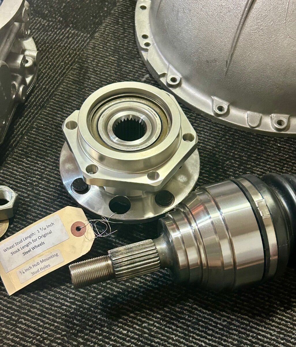

PriceLes Posted April 27 Report Posted April 27 I elected to get the R200 differential CV half shafts from Good Parts in the USA. The original universal jointed items were probably not that bad but there was some clicking coming out of small roundabouts on a steady throttle. (No noise if done with the clutch pedal in) so perhaps the splines were a little worn and binding slightly under engine load in that situation. The possibility even if remote of a hub flange and wheel parting company was enough of an incentive. I chose the GP items not only for their excellent reputation in general but the only option as far as a bolt up with the (VLSD) R200. Quote
charlie74 Posted April 27 Report Posted April 27 (edited) My impression of these axles (Limora) so far this driving season is favourable so far indeed. I had been meaning to contribute to this thread for a while now but wanted to put enough miles on them to make it (somewhat) meaningful. It has only been about 150 so far but since my car averages probably a bit less than 500/season it could be a while before I reach the x000’s mark. If anyone wants to see the documentation of the my project from last winter it is available here (https://www.triumphexp.com/forum/tr6-tech-forum.2/rear-end-refresh.2149503/). I elected to purchase these axles because there was some good feedback about them and the price point fit my budget better. Maybe if it was just the axles I was doing the GP offerings would have been attainable but I had other things to put my budget towards. Anyway, they are smooth, quiet in corners and the power seems to be put down a bit better than with the original equipment. I don’t have a way of documenting that except by “feel” so take it for what it’s worth. Best of all though is that there is no outer universal joint greasing anymore! (or probability of failure…) No doubt Richard Good offers quality products and has many happy customers, deservedly so. I have a few of his offerings on my car but in this case I am satisfied that I made a decision that will serve me well. YMMV but I am comfortable recommending them, best, C74 Edited April 27 by charlie74 Quote
