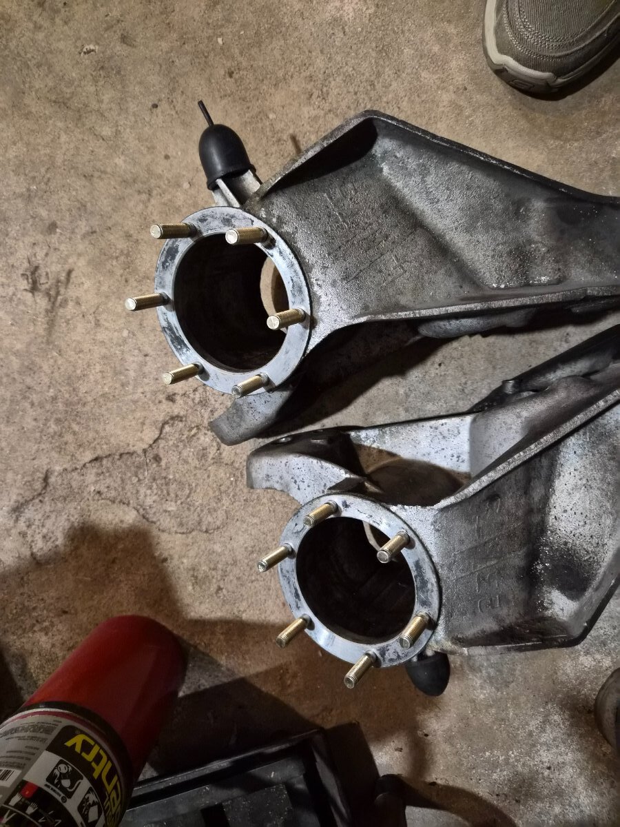

Dale Moore Posted January 18 Report Posted January 18 From what I gather, the holes in his new hubs are already drilled 3/8 Dale Quote
Magz Posted January 18 Author Report Posted January 18 17 minutes ago, Dale Moore said: From what I gather, the holes in his new hubs are already drilled 3/8 Dale Yes, new hubs are already 3/8. Quote
Magz Posted January 18 Author Report Posted January 18 4 hours ago, Dave McDonald said: Mags, the photo shows the “blocks” that Mick referred to which some of the studs are threaded in to. As you can see, they are very marginal for wall thickness if drilled out further. Take great care. Dave McD I have found a local machine shop that says they can put the trailing arms on their milling machine and do the precision drilling and re-threading for a nominal cost. I'm taking them there tomorrow to check them out, with the Goodparts instructions in hand! Although I'm doing all the rest of the rear work, including MIG welding the diff mount reinforcements (first time welding!), I feel this part might be best farmed out. I'll update when it's done. Quote

JohnC Posted January 19 Report Posted January 19 (edited) 12 hours ago, Magz said: I have found a local machine shop that says they can put the trailing arms on their milling machine and do the precision drilling and re-threading for a nominal cost. I'm taking them there tomorrow to check them out, with the Goodparts instructions in hand! Although I'm doing all the rest of the rear work, including MIG welding the diff mount reinforcements (first time welding!), I feel this part might be best farmed out. I'll update when it's done. Just a thought, but is it possible to use a stepped stud - 3/8"UNC one end and 5/16"UNF the other? That would avoid the need to risk scrapping a TA by accident. JC Edited January 19 by JohnC Unnecessary verbage Quote
Z320 Posted January 19 Report Posted January 19 (edited) Allow me to say what I think since Thursday: it the disc brake set requiers 3/8“ studs - it is drilled wrong. Perhaps of the wrong conculsion, because IMO the trailing arm is the limiting factor, not the studs. I have seen stepped studs the other way round for retapped threads. But they are cut on the lathe and with a die and no longer rolled, making them weaker than a 5/16 stud. Edited January 19 by Z320 Quote
Magz Posted February 22 Author Report Posted February 22 (edited) To provide some closure to this thread, the trailing arms are drilled, tapped and the new 3/8" ARP studs installed. The bracket for the disk brake calipers slides on very snugly over the studs. BTW, after some practice and fiddling with flux core vs Argon/CO2 (Ar/CO2 wins), voltage, wire feed rates and technique, the welding of the diff supports is looking good, too! Edited February 22 by Magz Quote

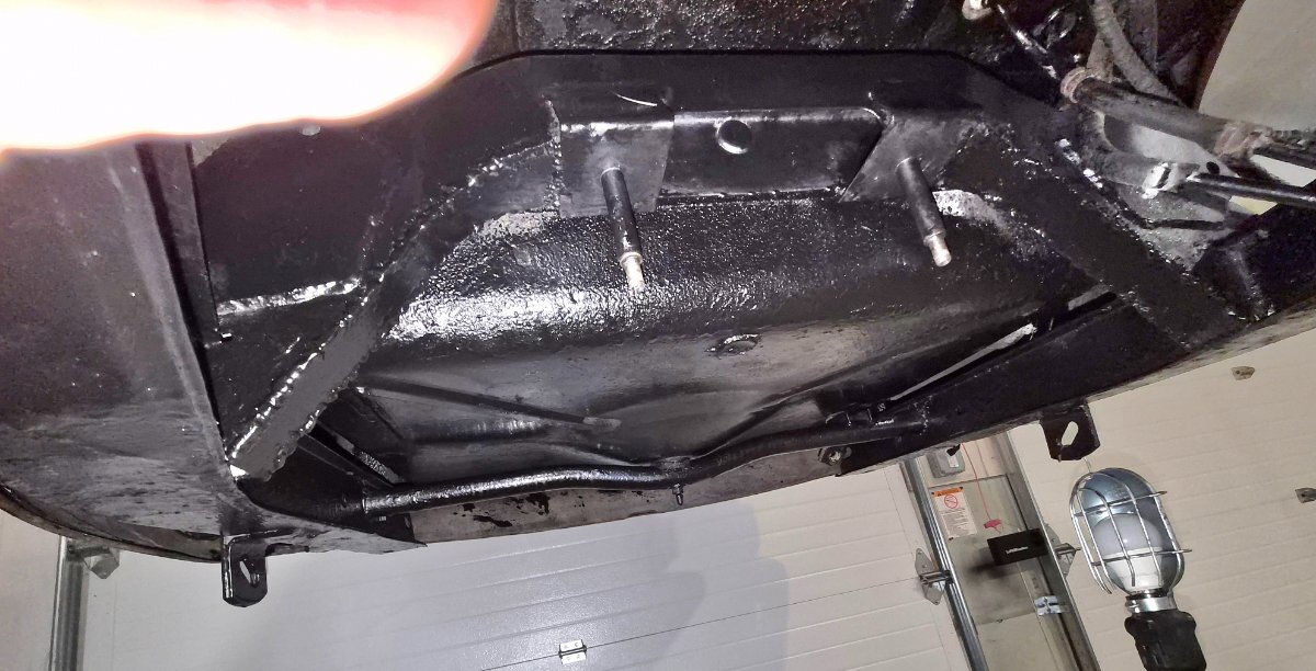

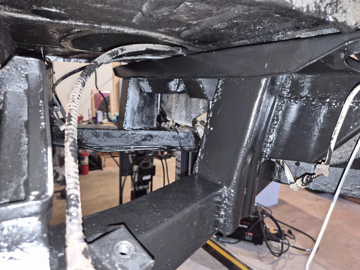

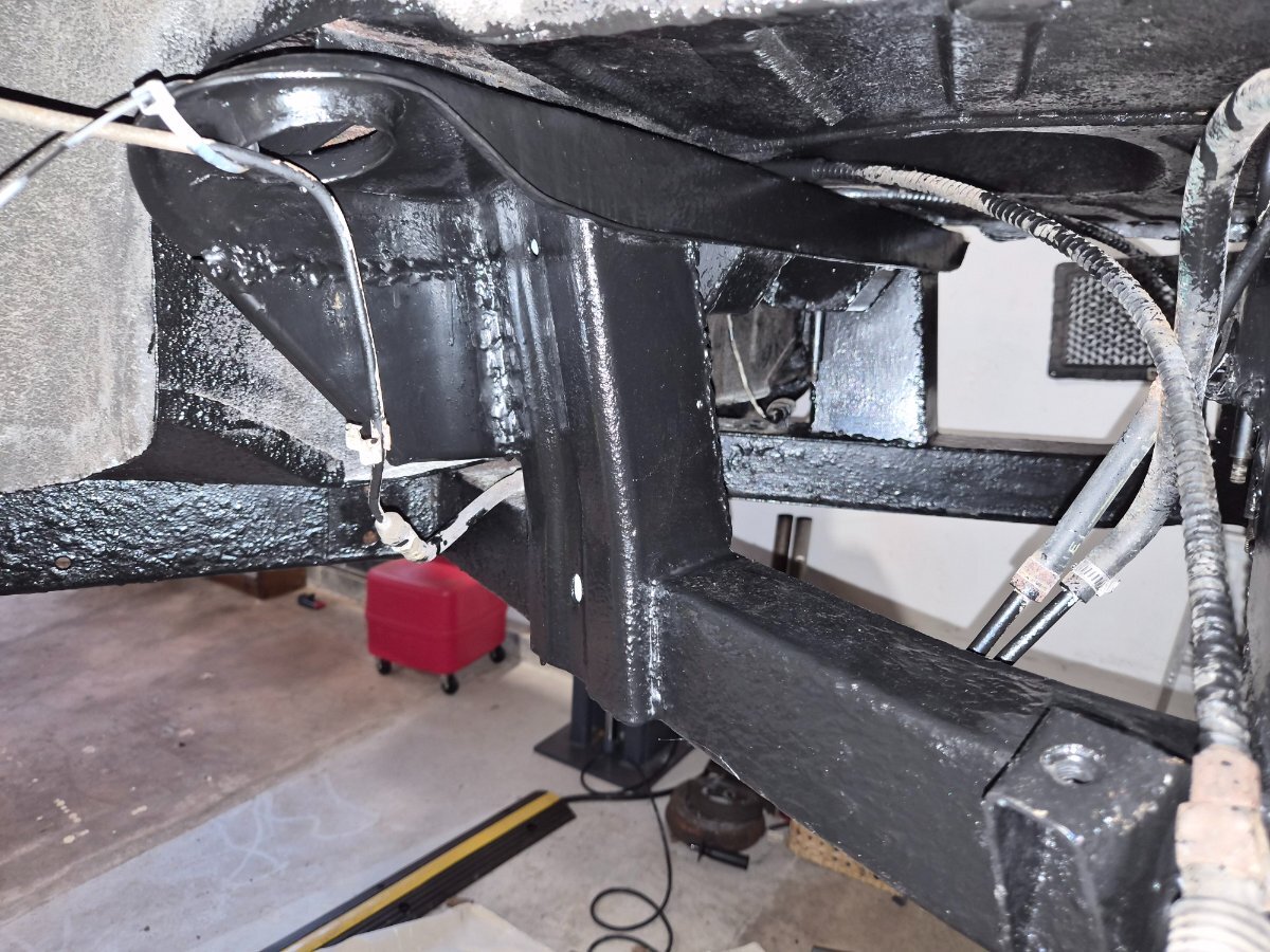

Magz Posted March 25 Author Report Posted March 25 (edited) Just an update on the diff support reinforcements. The supports have been boxed in, and I welded in a 6-piece TSI frame reinforcement kit to box in the front and rear diff bridges and reinforce the spring towers. All the area under the rear of the car was degreased, prepped with POR Metal-Ready and coated with POR-15. After this, I'll do some undercoating with the 3M rubberized product, then reassembly begins...warm weather is approaching here in the Eastern US! Edited March 25 by Magz Quote
