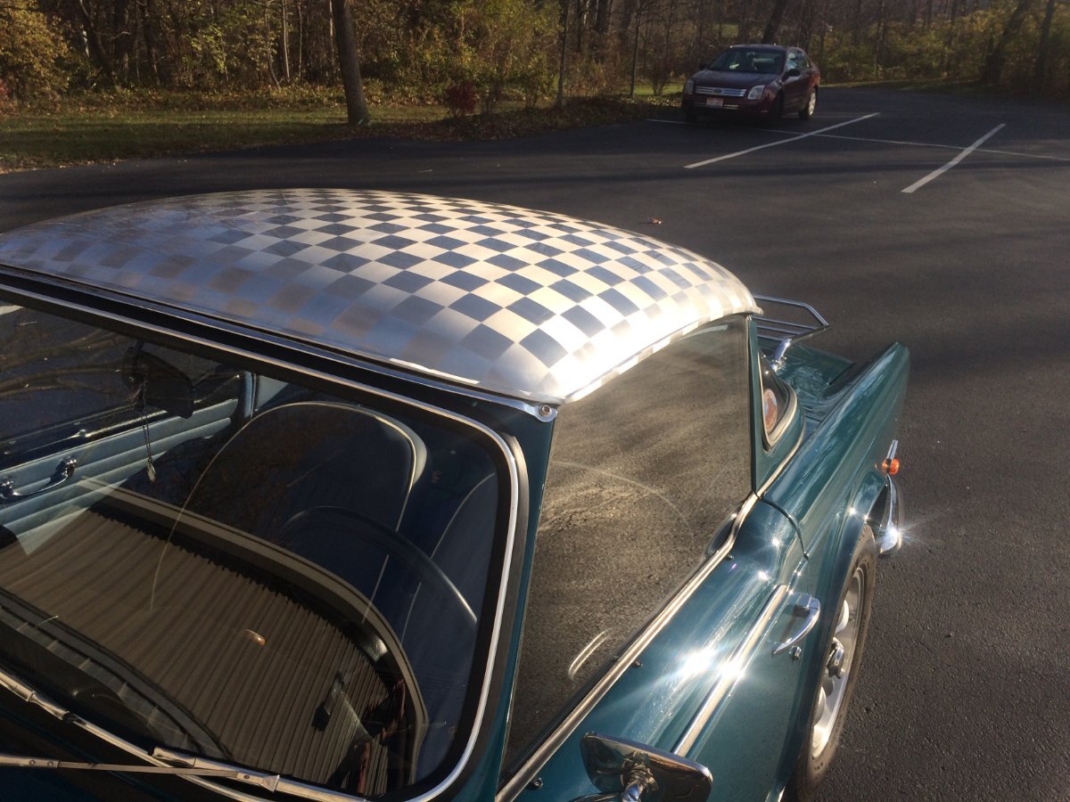

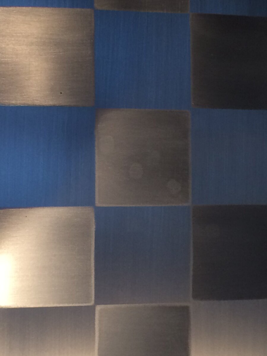

Tom Fremont Posted February 4 Report Posted February 4 On 1/23/2026 at 4:35 AM, multipletriumphsinner said: I have driven customers TR5's with Surrey tops fitted, but none of our own cars have them. I have always found the turbulence in the cockpit uncomfortable when the centre section is removed, especially at speed. Try with the side windows rolled up 😏. I would say it eliminates 70% of the wind buffeting / noise and conversation is possible at 70 mph+. Otherwise the backlight doesn't do anything to protect the occupants from wind. They say it does offer some rollover protection... I've had them for the last 32 years ( junior to many of you here! ) and will never go back nor will I likely ever buy a non-Michelotti TR for that reason. Were I not such an aficionado I might not have endured all the trials and tribulations ( let alone expense ) to land the ones in my collection, (2) steel painted body colour and (2) aluminium polished ( one checkerboard and one engine turned ) and clear coated. Alloy lids tended to be dented to Hell and gone ( 35 puller holes under the Bondo in one of mine ) and their moorings ripped out due to inadequate execution/engineering in the details ( remediable by a metalsmith ). Steel ones tended to rust through from the inside due to condensation settling in the seams, absolutely zero coating provided by TRIUMPH. This is much worse to remedy properly, i.e repaired invisibly with steel. As for the Surrey top, these are unwieldy in a pop-up shower ( hope for a bridge you can duck under while you wrestle with the kit ) and was clearly not intended for high speed use in the rain, reliably peeling out of the capping lip at 80+ MPH ( unless you open a side window a little, letting some of the rain in ). In over 150,000 miles with them I've probably done less than 5000 with the Surrey top including 4000 in one X-country trip. The '250s never leave the garage in the rain or forecast of same so they go out with hardtop or no top 99% of the time. The Michelotti hardtop / Surrey top kit is one of (4) transformative options on these cars; (3) from the factory are the 7-speed Laycock de Normanville overdrive, leather seats and the hardtop kit . These are hardly controversial, but to introduce that factor I submit the 4th is triple Weber DCOEs 😚. With these options in place it's remarkable that Porsche 911 Ts and Es of the day fetch far more at auction despite having less HP and torque than a TR5 and the latter wins the eye candy prize hands down to boot ( ever ogle a Porsche engine bay? ). That besides TRs running with original engines while replacements are the order of the day with most of these aluminum engined contemporaries - iron rocks! Quote
