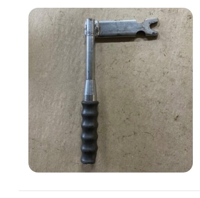

BlueTR3A-5EKT Posted January 19 Report Posted January 19 Errrr how about the original Girling spreading lever/tool? It has worked perfectly for me for 40 years https://www.ebay.co.uk/itm/187731589989?mkevt=1&mkcid=1&mkrid=710-53481-19255-0&campid=5339129536&toolid=20006&customid=f7d2f44f4a3410b44abb9d21f49c9582&loc_physical_ms=218790&loc_interest_ms=&msclkid=f7d2f44f4a3410b44abb9d21f49c9582 Quote

Phil Read Posted January 20 Report Posted January 20 13 hours ago, BlueTR3A-5EKT said: Errrr how about the original Girling spreading lever/tool? It has worked perfectly for me for 40 years https://www.ebay.co.uk/itm/187731589989?mkevt=1&mkcid=1&mkrid=710-53481-19255-0&campid=5339129536&toolid=20006&customid=f7d2f44f4a3410b44abb9d21f49c9582&loc_physical_ms=218790&loc_interest_ms=&msclkid=f7d2f44f4a3410b44abb9d21f49c9582 Yep I have one of these, simple but effective. Quote

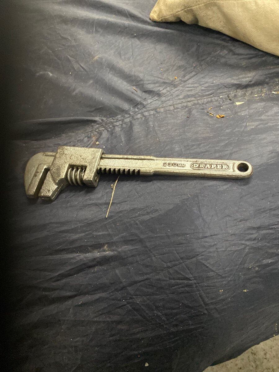

roy53 Posted January 23 Report Posted January 23 I use an adjustable spaner with a parallel shaft any parallel will do to keep even pressure on the piston Quote
