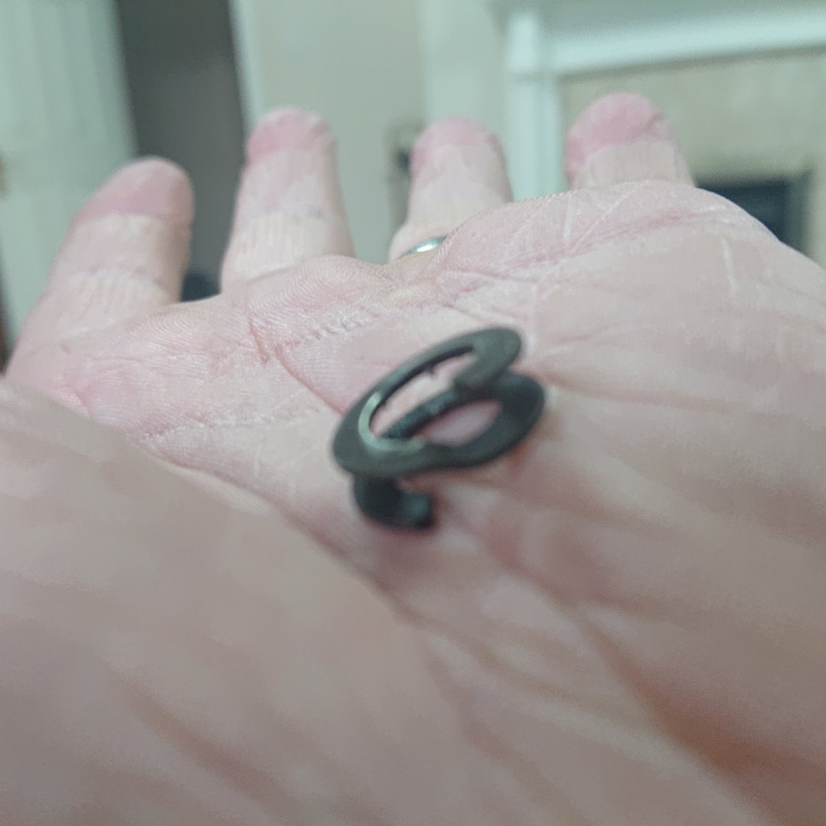

Hi,
Any one know what this is off?. I found it on the garage floor.  It is very tough to compress.  Might not be off the 3a!
Cheers
Dave
Thats a Thackery washer, use to stop rattles on things like bonnet prop or boot prop on 4 to 6. Also used for Webber manifold studs.
Thanks. Could be off a 4a.

5 minutes ago, John Morrison said:
Starter Motor Bendix?
John
Theyre a lot bigger than that.
I have them on the pins of the master cylinders. To centralize the arms part 131787 anti rattle spring
although that one looks a lot thicker
Roy
