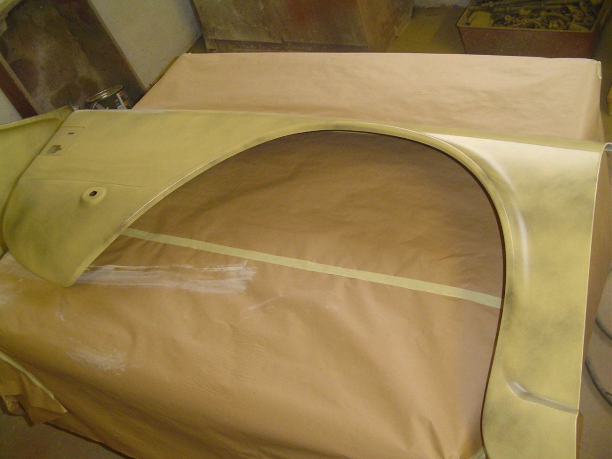

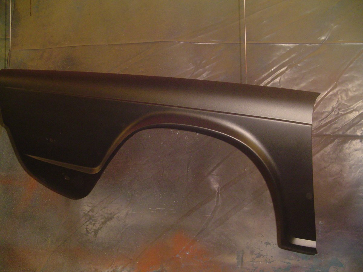

Grey or white is fine for light colours, for dark its better to use a black as it makes the colour stand up more. First picture below for a Royal Blue car, second for a Galla fly yellow car.
