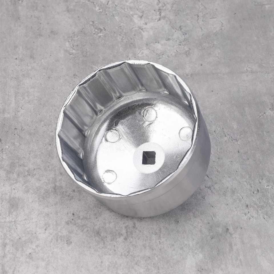

Bfg Posted March 1 Report Posted March 1 (edited) Perhaps one like this Oil filter wrench ? . . . . https://www.ebay.co.uk/itm/195807733695 This is probably the correct tool for the job. They come in different sizes but the above is the first one I happened to find on ebay, I have a couple, from my BMW motorcycling days, and it worked because it engages all the way around without crushing. Unfortunately once you use other types of strap or chain on an oil filter canister then its shape is buggered and then this socket no longer fits. Pete Edited March 1 by Bfg Quote

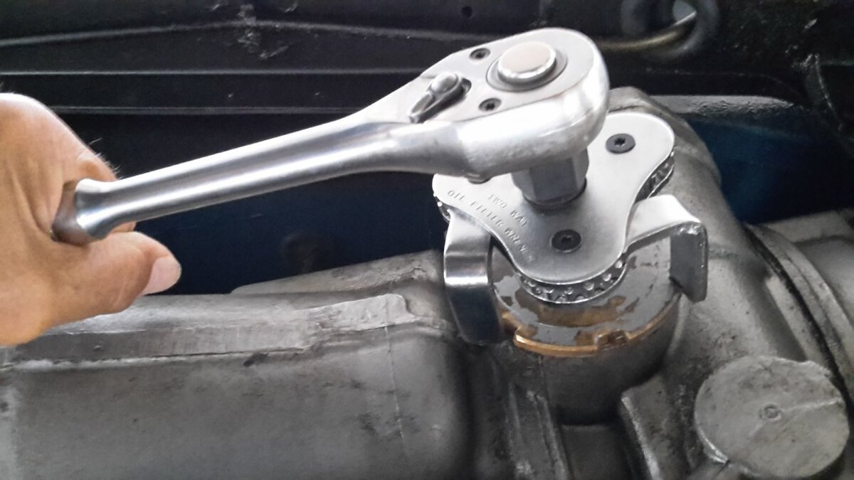

Z320 Posted March 1 Report Posted March 1 At the moment I don’t own a car with such a modern oil filter, but a „3 fingers“ oil filter tool from „Hatez“. Pretty expensive but there are cheap copies from China available Quote
Scott M Posted March 1 Report Posted March 1 45 minutes ago, Z320 said: At the moment I don’t own a car with such a modern oil filter, but a „3 fingers“ oil filter tool from „Hatez“. Pretty expensive but there are cheap copies from China available That’s what I use, fits on 1/2” drive wrench and a cam tightens the legs in use . Can’t remember what they are called but work well. I always found the straps/chains slipped or totally wrecked the filter causing a mess - although not as messy as the good old screwdriver through the filter method I used in the 80s Quote
Lebro Posted March 1 Report Posted March 1 I have one, they are also good for removing / replacing the overdrive drain plug ! Bob Quote
Steve-B Posted March 2 Report Posted March 2 23 hours ago, Bfg said: Perhaps one like this Oil filter wrench ? . . . . Pete Seeing this thread I was about to go to the garage and take a picture of mine Pete! I've had one since the mid-70s when Dad and I restored a 66 Spitfire. Worth more than its weight in gold and only 1 car I've ever owned it didn't fit! Quote
dblenk Posted Tuesday at 01:51 PM Author Report Posted Tuesday at 01:51 PM Nice piece of kit that Quote
