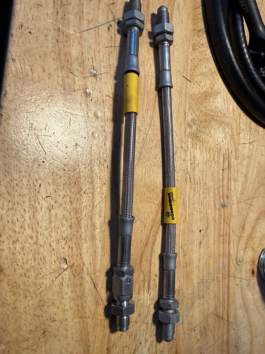

My Dads Car Posted February 13 Report Posted February 13 I bought the fancy braided brake lines from Moss. Front fit ok, now starting on back and I noticed this discrepancy: Regarding the bottom hose right side: can someone please tell me what that nut with the hole in it is? I can't seem to remove it and what was there before certainly did not have the same fitting. Thanks in advance- Jamie Quote
My Dads Car Posted February 13 Author Report Posted February 13 Yes - it turns 7 minutes ago, Hamish said: Does it allow the fitting to turn ? Quote
Hamish Posted February 13 Report Posted February 13 (edited) Thus is it a swivel fitting ? And not something to worry about. Edited February 13 by Hamish Quote
BlueTR3A-5EKT Posted February 14 Report Posted February 14 (edited) Deleted. Comment not correct for the model of car. Edited February 14 by BlueTR3A-5EKT Quote
stuart Posted February 14 Report Posted February 14 Is your car an IRS model or a Girling axle as the Girling axle 4a only has one flexi pipe. Stuart. Quote
BlueTR3A-5EKT Posted February 14 Report Posted February 14 4 minutes ago, stuart said: Is your car an IRS model or a Girling axle as the Girling axle 4a only has one flexi pipe. Stuart. Good point. The hoses then are different front and rear. Quote
My Dads Car Posted February 14 Author Report Posted February 14 (edited) 2 hours ago, BlueTR3A-5EKT said: Good point. The hoses then are different front and rear. My car is a ‘66 TR4A LHD. Independent rear suspension. Edited February 14 by My Dads Car Quote
BlueTR3A-5EKT Posted February 14 Report Posted February 14 (edited) 8 hours ago, My Dads Car said: My car is a ‘66 TR4A LHD. Independent rear suspension. In which case there are two rear hoses that are different. One has the same fitting with a cone both ends, one has a cone one end and is flat (for use with a copper crush washer into the 3 way block) the other. Edited February 14 by BlueTR3A-5EKT Quote

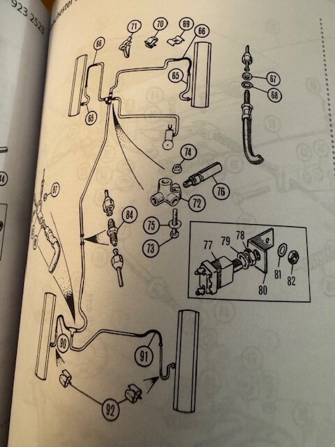

My Dads Car Posted February 15 Author Report Posted February 15 10 hours ago, BlueTR3A-5EKT said: In which case there are two rear hoses that are different. One has the same fitting with a cone both ends, one has a cone one end and is flat (for use with a copper crush washer into the 3 way block) the other. Thank you, Peter. My block is on the left side of the car. Based on my photo above; the hose on the right goes on the right side of the car while the hose on the left goes on the left- with the unusual fitting I initially asked about towards the block? Also, since you mentioned it, do the copper washers that came with brake pipe set go at every union, including the calipers and rear pistons, or just at the front and rear blocks? Thanks! -Jamie Quote
BlueTR3A-5EKT Posted February 15 Report Posted February 15 Washers go between the hose and the brass blocks to form a fluid seal. The cone on the other end of the hose seals to an inverted cone formed on the end of the rigid brake pipe and is clamped closed by tge tightening of the flare nut to the hose thread. Quote
harrytr5 Posted February 15 Report Posted February 15 Try this Jamie, Its from the Moss catalogue Regards Harry Quote
BlueTR3A-5EKT Posted February 15 Report Posted February 15 25 minutes ago, harrytr5 said: Try this Jamie, Its from the Moss catalogue Regards Harry Coo. It’s always nice to see the catalogue stuff I worked on. Quote
