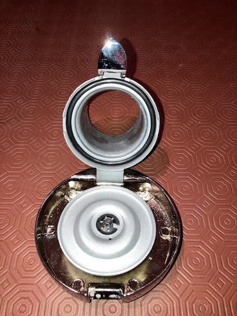

trchris Posted February 24 Report Posted February 24 I replaced the large ugly ,damaged American spec fuel cap with a locking lozenge shaped one as a temporary solution on the 250, l now want to change this as I’m not a fan as there’s a couple of options ( catch on side or underneath)does anyone know which one is correct for a 67 model Chris Quote

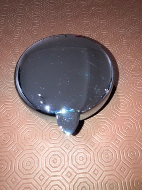

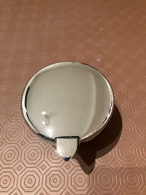

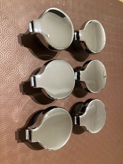

rcreweread Posted February 24 Report Posted February 24 38 minutes ago, trchris said: I replaced the large ugly ,damaged American spec fuel cap with a locking lozenge shaped one as a temporary solution on the 250, l now want to change this as I’m not a fan as there’s a couple of options ( catch on side or underneath)does anyone know which one is correct for a 67 model Chris Chris - one like the ones in the first 4 photos is correct for a TR4 through to TR5- I have 2 of these left and also 3 TR6 ones as in the fifth photo of 6 of them, originally - they have all been fully refurbished and rechromed - the TR4/4A/5 ones are £75 each and the TR6 ones are £100 each - PM me if you or anyone else is interested . Cheers Rich C-R Quote

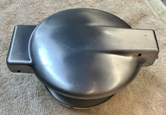

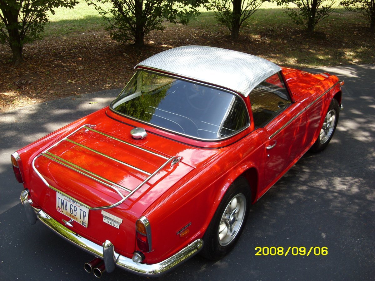

Kenrow Posted February 27 Report Posted February 27 As mentioned the correct cap is the US spec one (shown below), you next best thing would be the from a TR4/5 as Rich is selling. Since you don’t want the 250 cap, what you choose will not be correct so it is all based on which you feel is more visibly pleasing. Quote

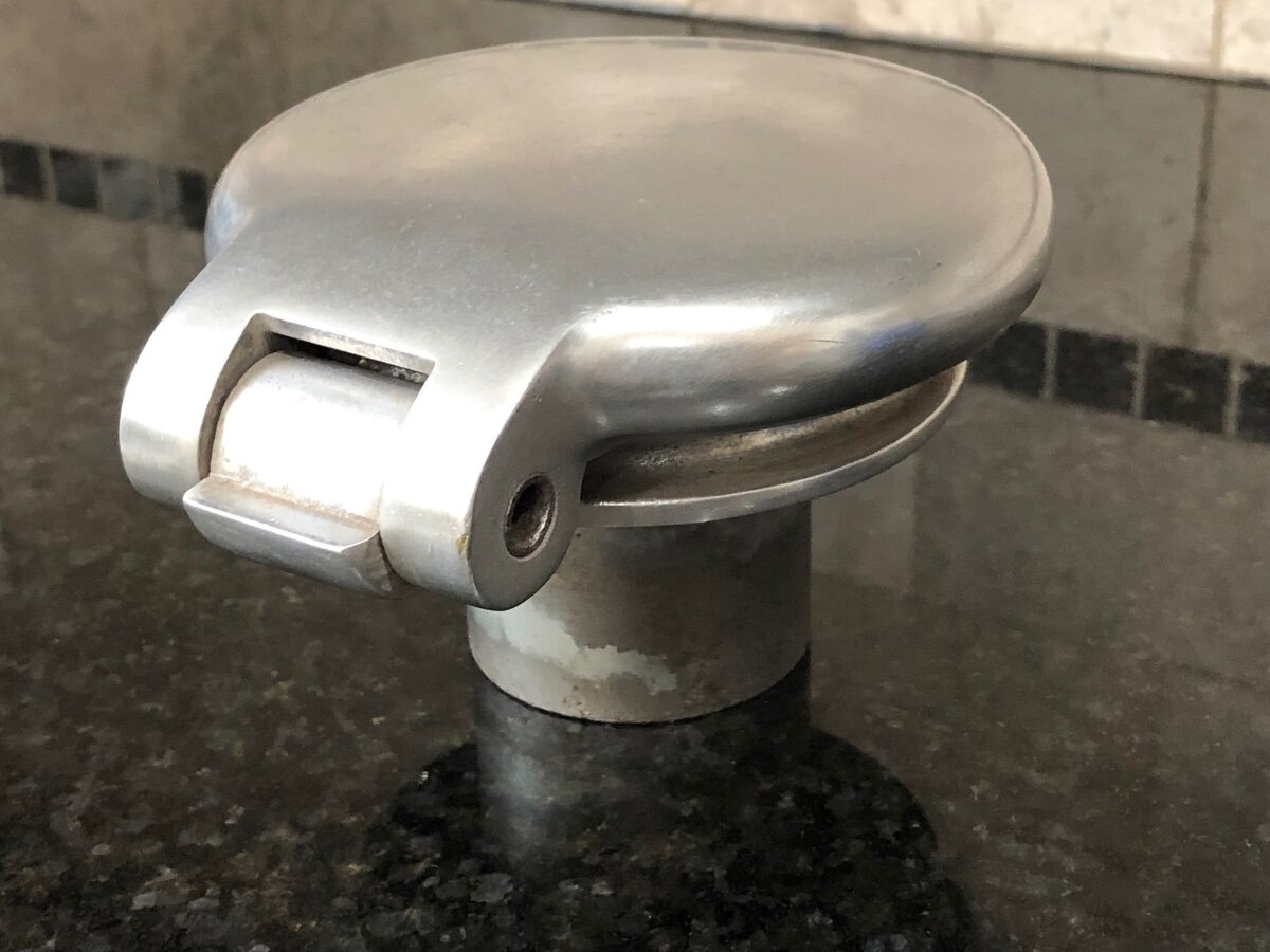

trchris Posted February 27 Author Report Posted February 27 (edited) Hi Ken Thats the one l had originally however it hasn’t faired well and was both damaged and bent I’ve seen another type of aluminium magnetic cap, with a closing catch side mechanism which l believe was fitted to the American early 6s ? ( or was a option ) It’s in good condition so at the moment I’m weighing up the options My 250 is far from original Chris Edited February 27 by trchris Quote

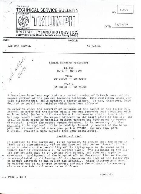

BlueTR3A-5EKT Posted February 27 Report Posted February 27 (edited) Tha magnetic closing cap was deemed to be in potential danger of flipping open if the rear or side rear of the car was struck in an accident. There is a service bulletin to advise on this. SOLD. I have a very good old stock unfitted NAS TR6 cap with the mechanical latch, if anyone is interested. Pt no 723040. Has a few scratches that should polish out. Edited February 27 by BlueTR3A-5EKT Quote
Z320 Posted February 28 Report Posted February 28 I made a few lock inserts for the magnetic TR250 fuel cap too, but this costes me too much time. Perhaps an idea for a project for someone else? Ciao, Marco Quote
Tom Fremont Posted Monday at 05:33 PM Report Posted Monday at 05:33 PM On 2/27/2026 at 4:30 AM, BlueTR3A-5EKT said: Tha magnetic closing cap was deemed to be in potential danger of flipping open if the rear or side rear of the car was struck in an accident. There is a service bulletin to advise on this. This bulletin seems to first address the tendency of the magnet to un-stick itself from the cap ( part 1 of 2 ). I've had this happen on one of mine after 50+ years of service ( out of warranty I suppose ) and indeed it is challenging to match the adhesive TRIUMPH used. I think I used weatherstrip adhesive last time... I love the original caps and still wonder what they were coated with originally; I sanded out all the scratches and buffed them to get an attractive albeit flat sheen but found it necessary to fit stainless hinge pins as originals do rust and stain them. Quote
BlueTR3A-5EKT Posted Tuesday at 11:08 AM Report Posted Tuesday at 11:08 AM 17 hours ago, Tom Fremont said: This bulletin seems to first address the tendency of the magnet to un-stick itself from the cap ( part 1 of 2 ). I've had this happen on one of mine after 50+ years of service ( out of warranty I suppose ) and indeed it is challenging to match the adhesive TRIUMPH used. I think I used weatherstrip adhesive last time... I love the original caps and still wonder what they were coated with originally; I sanded out all the scratches and buffed them to get an attractive albeit flat sheen but found it necessary to fit stainless hinge pins as originals do rust and stain them. Tom, I’d guess the original alloy pressure die cast caps were matte anodised, at least that is what the new ones I used to sell looked like all those years ago. It is the same finish I get done on the aeroscreen mounting brackets I produce for sidescreen cars. It looks like milky chrome. You need some form of surface finish to protect the base metal from atmospheric corrosion, I would guess. The aeroscreen mounts I sell in both anodised and just plain bright polished finish. The anodised can be simply washed with soapy water to bring the back to their original finish. The polished ones require the effort of an application of a suitable aluminium polish to bring them back to their starting look. Quote
