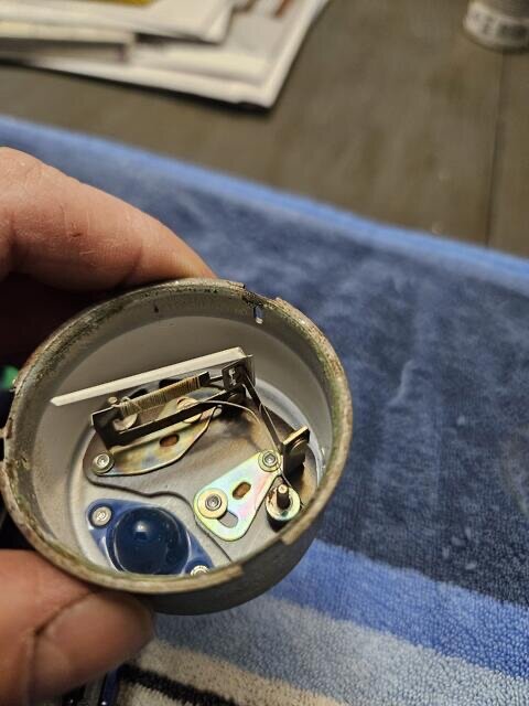

zzzzdave Posted February 25 Report Posted February 25 Just pulled the dash on the 5, to look at why two Gauges light up white in the dark , and why all the rest have a blue tint to the backkground lighting. Temperature gauge and oil pressure gauge dont have a little blue jewel in the hole where the bulb goes in , all other dials both large and ammeter, fuel gauge i can see blue jewels in the hole where the bulb inserts. i also have a spare CP oil gauge and that has no jewel. so my question is , for a TR5 should the the instrument lighting be a blue tint, if that is correct, how is the blue tint added to the lighting for oil pressure/ temp gauges. do i need open up and have a look, or are they the incorrect gauges ., any thoughts before i pull offending gauges apart thanks Dave Quote

zzzzdave Posted February 25 Author Report Posted February 25 thanks for the replies, seems they all should be white coloured. I am using LED white lamps, its seems that the speedo , tacho, ammeter and fuel gauge all have a blue tint due to a blue Jewel in the lamp aperture. Did early TR6 CP have blue jewels colourng the lamps, im wondering whether i may have some TR6 gauges? would it work if i opened the gauges and took the blue Jewels out and made them all white ? thoughts appreciated . Quote

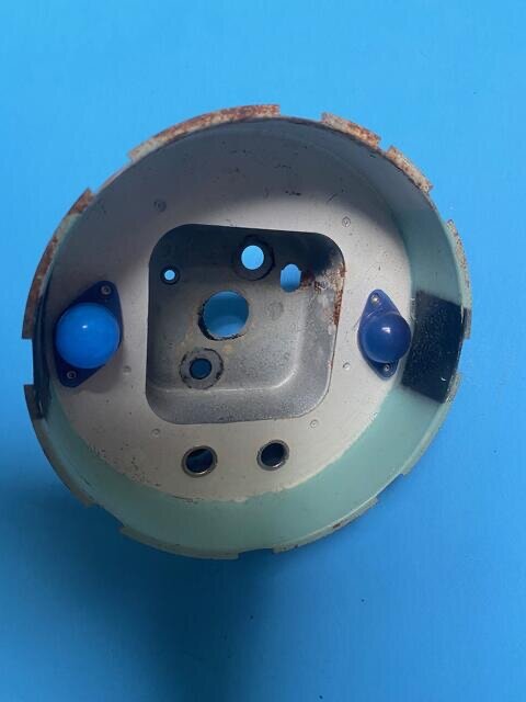

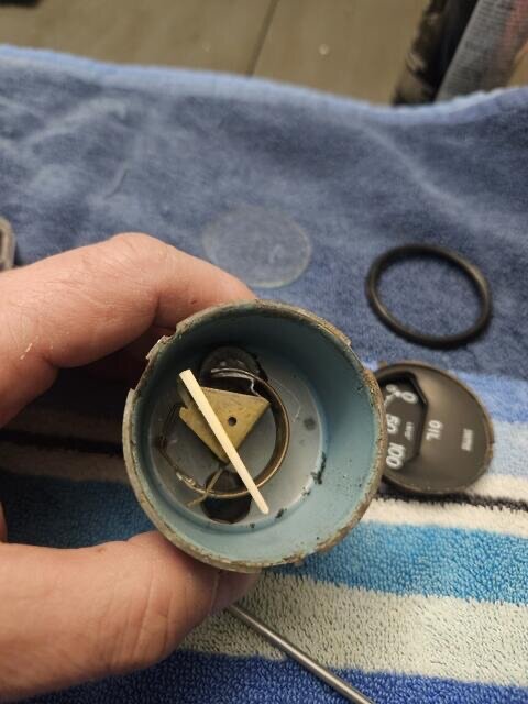

Kenrow Posted February 27 Report Posted February 27 The inside of the oil pressure where painted robin eggs blue, no lens cover. Speedo and tach had paint also but had blue lens covers like the other small gauges (the wierd lens in the speedo photo is an optical illusion) Quote

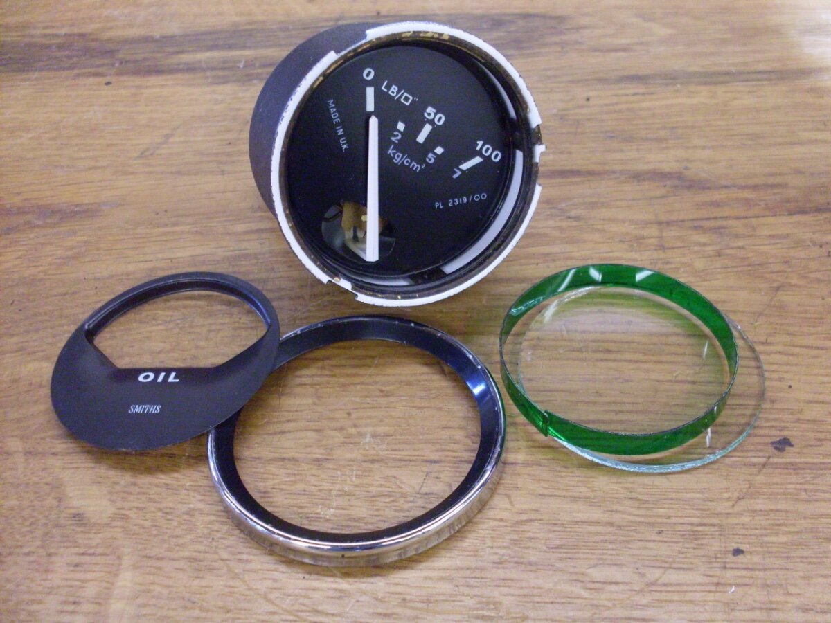

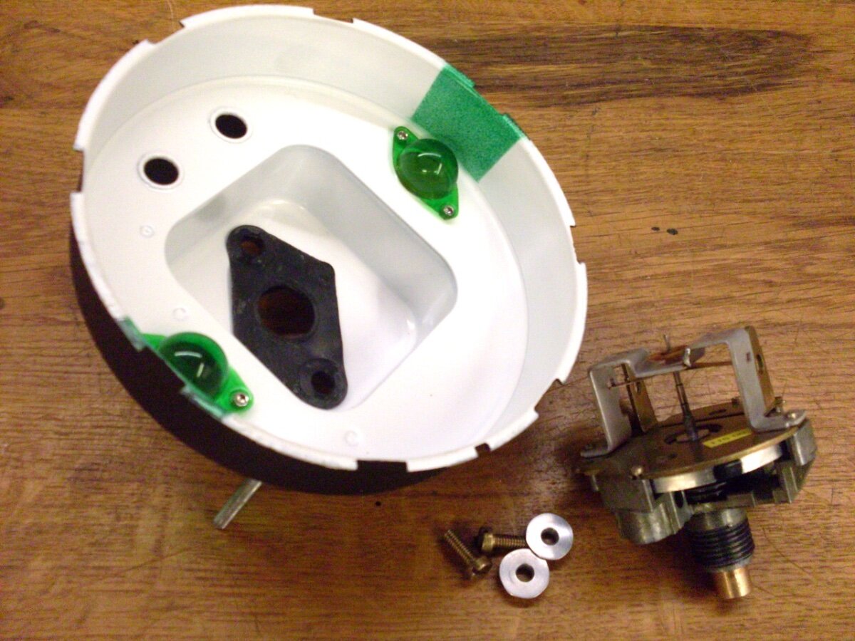

Kenrow Posted February 27 Report Posted February 27 The later year TR6s (green tint) had a green diffuser around the whole inside of the gauge and I slightly different paint scheme. Quote
PodOne Posted February 27 Report Posted February 27 On 2/25/2026 at 10:28 PM, zzzzdave said: Did early TR6 CP have blue jewels colourng the lamps, im wondering whether i may have some TR6 gauges? would it work if i opened the gauges and took the blue Jewels out and made them all white ? thoughts appreciated . My early 1969 TR6 was blue. Quote
