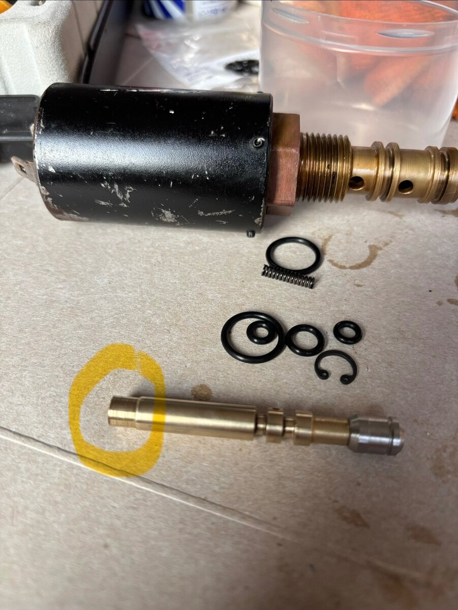

Steve Morris Posted March 1 Report Posted March 1 Just replacing the seals in my j-type overdrive solenoid and the end of the shaft has a very slight sharp lip at the inside end. Is this normal and should I dress it back to remove the edge? It feels like I should but thought best to check before reassembly. Cheers. Quote
Steve Morris Posted Monday at 07:53 PM Author Report Posted Monday at 07:53 PM Took the sharp edge off with a file and finished with 1000 grit - will report back if any issues. Quote
RobH Posted Monday at 08:16 PM Report Posted Monday at 08:16 PM That seems sensible Steve. That end of the shaft doesn't do anything except act as a travel-stop, which might be what raised the lip in the first place. Quote
Steve Morris Posted Tuesday at 12:37 PM Author Report Posted Tuesday at 12:37 PM Yes I think you’re right Rob. I thought there was a risk of the edge damaging the new o rings so in balance it was worth the punt! Quote
