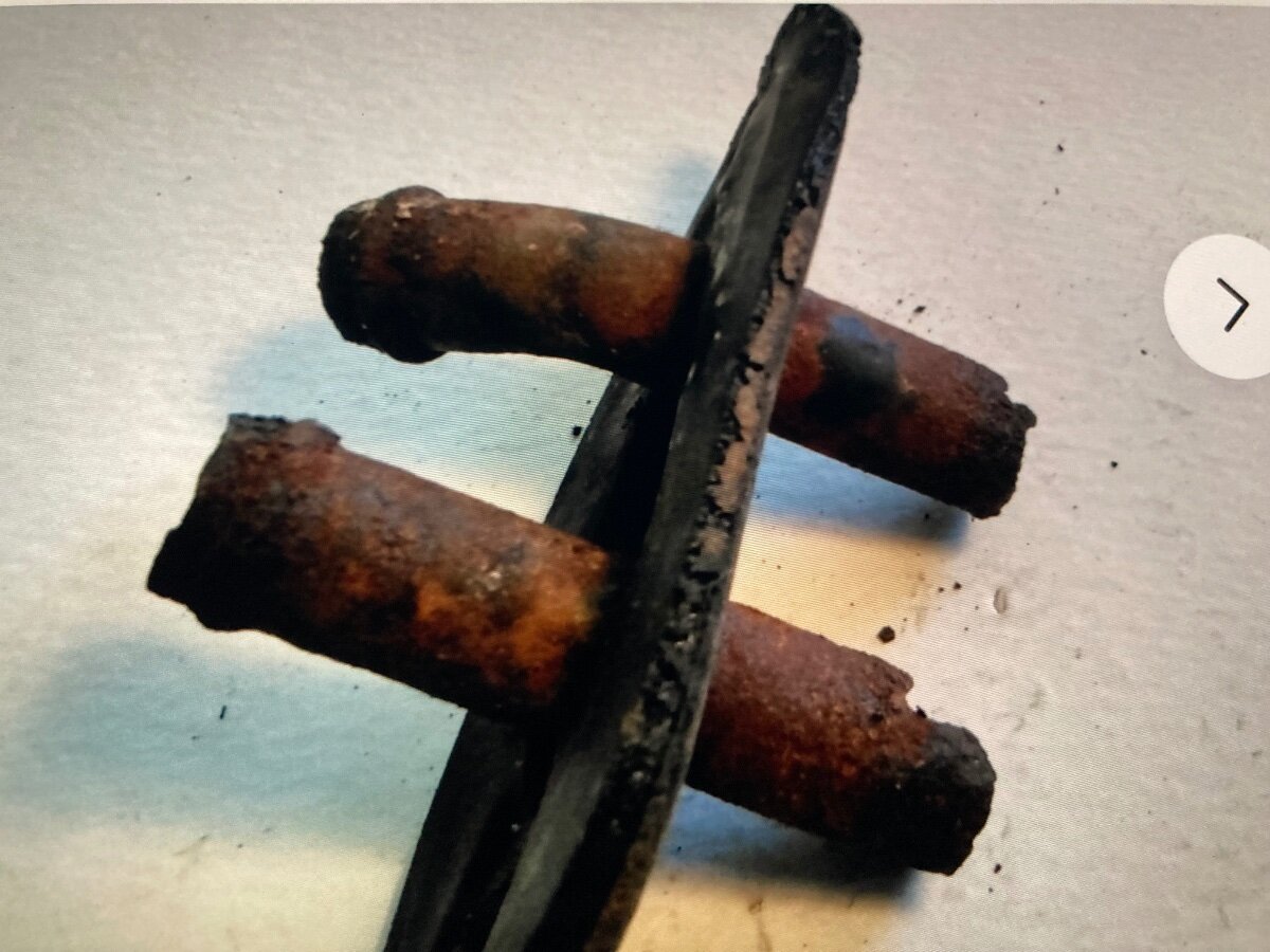

Peter V W Posted Tuesday at 04:43 PM Report Posted Tuesday at 04:43 PM (edited) Looks as if an original one is only swagged at one end. Picture from eBay advert. Edited Tuesday at 04:44 PM by Peter V W E Quote
stuart Posted Tuesday at 04:58 PM Report Posted Tuesday at 04:58 PM 13 minutes ago, Peter V W said: Looks as if an original one is only swagged at one end. Picture from eBay advert. Thats correct they were only swaged on one side and being in mild steel they rot for a past time. Stuart. Quote
Ernest Posted Tuesday at 08:08 PM Author Report Posted Tuesday at 08:08 PM Blimey Peter that does look like it has seen a bit of service! Mine is shiny and new looking - and hence very slippery. I have just sent for the clips that Roger suggested and am hoping these might hold the hose on. Failing this I am at loss. Superglue? Ernest Quote
Z320 Posted Tuesday at 08:30 PM Report Posted Tuesday at 08:30 PM (edited) 13 hours ago, Peter V W said: Looks as if an original one is only swagged at one end. Picture from eBay advert. Hi Peter, thank you for having doubt too and posting the photo. I'm pretty sure this is obvious considering how this "unit" must be produced to be cheap: cut the pipes, press the ridge end in one side, bend the pipes, stick them through with the therefore not ridged end, weld them in position... And now the unit is too complicated and to fragile to hold and press a ridge on the other end of the pipes and keep them low price. And there are other connections on our TRs without a ridge end too: - TR2-4 water pump housing, bypass connection - TR2-4 thermostat housing, bypass connection - petrol hose to steel pipes and petrol hose to float chamber lid The most important issue to get a hose connection sealed is the tight fit on the pipe without a clip. If this is not the case the clip will not seal the connection. Guess why I know. Ciao, Marco Edited Wednesday at 06:38 AM by Z320 Quote
