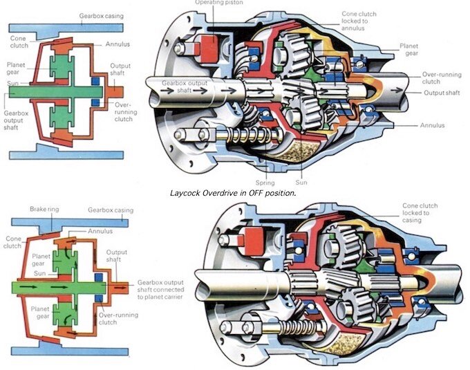

RobH Posted Tuesday at 07:59 PM Report Posted Tuesday at 07:59 PM (edited) The OD internal clutch works in two directions. When OFF it locks the annulus of the sun & planet gears to the sun gear, so the sun and planets cannot move and the input and output shafts rotate together. That bit sounds to be working. When ON it releases the annulus and locks the sun gear to the OD case so it cannot rotate, which makes the drive go from the input shaft through the planet gears to the annulus and output shaft. It sounds to me as though the annulus is being released but the outer brake doesn't bite, so the sun and planet gears are both rotating freely instead of driving the annulus, meaning no drive is transmitted to the output shaft. Edited Tuesday at 07:59 PM by RobH Quote
Lebro Posted Tuesday at 10:41 PM Report Posted Tuesday at 10:41 PM Yes, but as pointed out above, the one way clutch should prevent the output shaft rotating slower than the input shaft. Bob Quote
