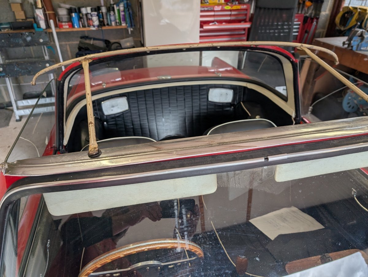

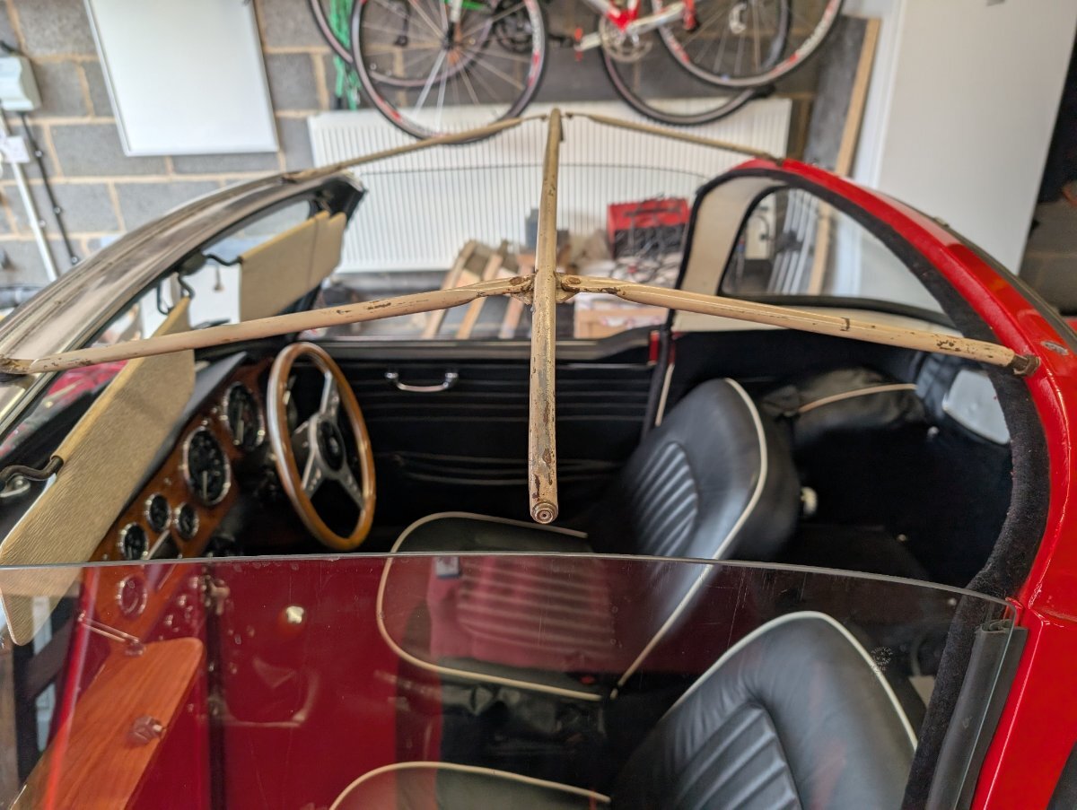

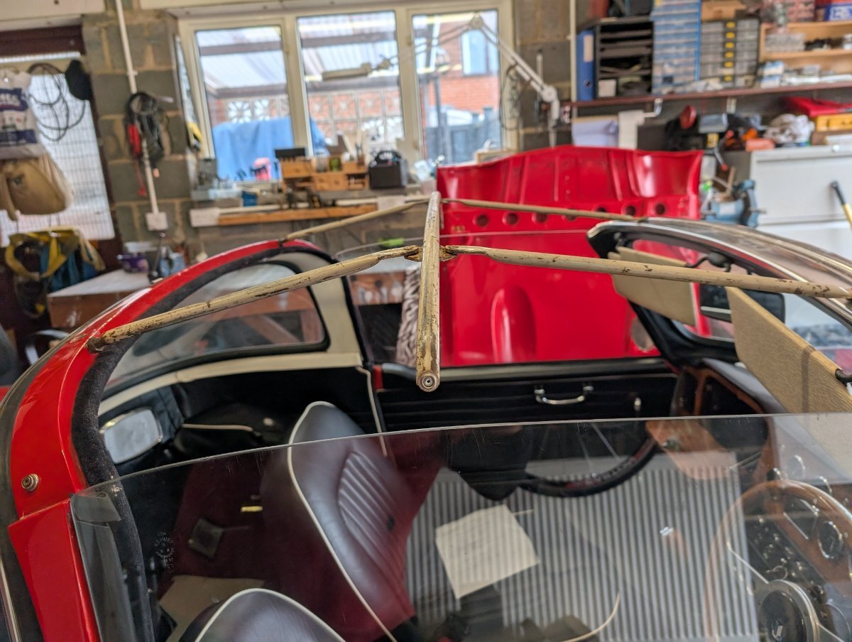

GaryW Posted April 3 Author Report Posted April 3 Stuart, Thinking of taking your advice and getting a vinyl hood. I spent some time today fiddling with the old frame and hood. The hood has had it but I think the frame is salvagable, what do you think is the shape roughly what you would expect (rear poppers are knackerd and wont fix in position) Incidentally I emailed Heritage 3 days ago no response yet maybe better to call them I am thinking. Cheers Gary Quote
stuart Posted April 3 Report Posted April 3 21 minutes ago, GaryW said: Stuart, Thinking of taking your advice and getting a vinyl hood. I spent some time today fiddling with the old frame and hood. The hood has had it but I think the frame is salvagable, what do you think is the shape roughly what you would expect (rear poppers are knackerd and wont fix in position) Incidentally I emailed Heritage 3 days ago no response yet maybe better to call them I am thinking. Cheers Gary Looks a little low passenger side as you can see in the centre where the popper is the gutter edge just sits down too far over the window, undo the nut on the left rear leg till the distance of the end of the frame middle bars to the top of the glass is the same as the drivers side and it will be a better fit, poppers are easily replaced on the frame and the frame could go a repaint but other than that I would save your money and just refurb what you have in the way of a frame and get a vinyl soft section. The rivets where the front and rear bars meet the centre bar often need a subtle belt with a hammer and punch to tighten them up a bit but dont overdo it. The vinyl is easier to live with especially as most of the time it`ll more than likely be rolled up in the boot. Stuart. Quote
