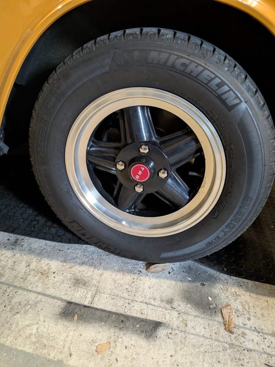

Mike Morris Posted April 4 Report Posted April 4 My car has revolution wheels with 205/60 R15 Michelin tyres which although have plenty of tread and feel soft enough, are coming up to 10yrs old. We are going to do a road trip around Northumberland in July so will probably change them after then. On full left lock - no problems but on full right lock, the nearside tyre rubs on the frame/antiroll bar. Which tyres would you suggest which would minimise any rubbing on full lock? Car just been fitted with electric power steering (great by the way) so heaviness at slow speed not an issue. Quote
John Morrison Posted April 4 Report Posted April 4 A) Personally I wouldn’t be looking to change tyres simply because they are coming up to ten years old. Far more important is their condition and how they have been looked after. Replacement size would be governed by rim width but certainly 205 are in my humble opinion far too wide. John Quote
Hamish Posted April 4 Report Posted April 4 If it only rubs on one lock I’d be looking at adjusting the steering lock stop on the trunnion. I’m sure the 6 has this like the earlier TR’s Quote
Kenrow Posted April 4 Report Posted April 4 You could replace your steering stop with one of Revington's oversized stops (check to see if your current one has an eccentric hole (also avail from Revington)).. Revington Steering Stop Quote
TRTOM2498PI Posted April 5 Report Posted April 5 Are these wheels 15x6j ? You will probably find a 195/65/15, the best all-round sized tyre for this rim. Alternatively, a wheel spacer should help here. I did run 15X6 Revolutions around 12 years ago, with 195/65/15 tyres, and wheel spacers (from memory), on my TR6. Cheers. Quote

johnw Posted April 5 Report Posted April 5 When I had a similar problem some years ago I used some thin wall tubing slightly smaller in diameter. Split it with a hacksaw and slide over the existing stop. Worked a treat. Quote

Hamish Posted April 5 Report Posted April 5 You could try a stack of bigger washers to see if it works before spending money Quote
