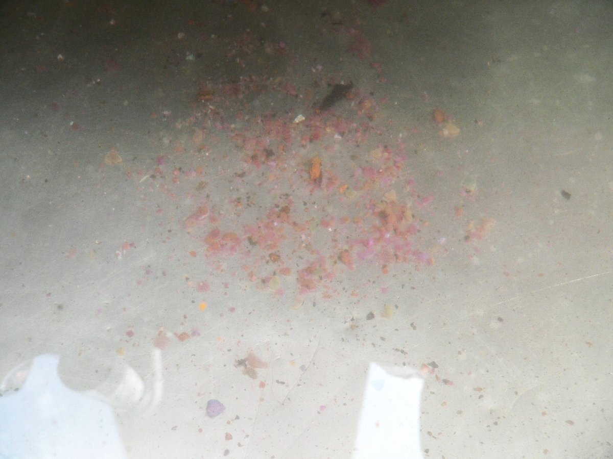

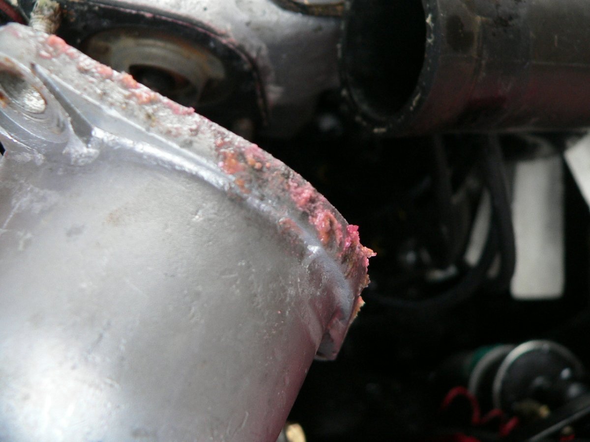

There was also pink crystalline particles around the thermostat gasket. . .
I've also noted the thermostat's gasket face is corroded away. . .Being the new owner-mechanic I don't know whether that corrosion is related, but the gasket face now needs redressing smooth and flat.

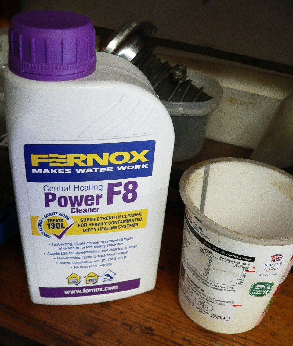

The instructions on the pot, for domestic central heating, recommends circulating it for up to a week, before draining down and flushing the system thoroughly.  Do you recall how exactly you used it ?
fernox-f8-super-strength-cleaner-boiler-central-heating-sludge-remover-500ml.thumb.jpg.cfda39672499414e15baf41de85f7b3a.jpg

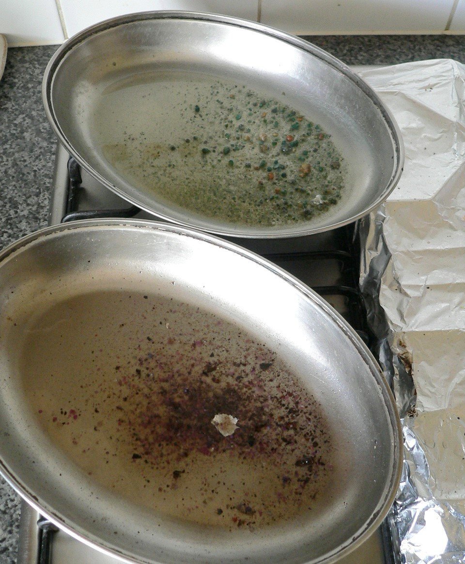

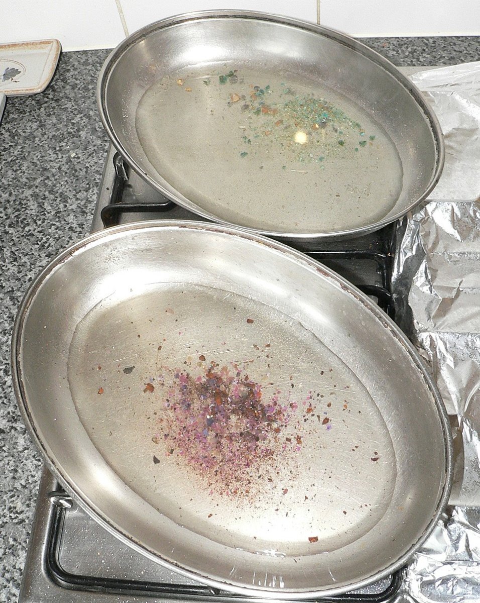

Time for a science experiment
Take some of your sludge and put it in a series of bowls then add the various suggestions to a bowl each, 1 with lemon juice, 1 with  fernox, 1 with white vinegar and so on

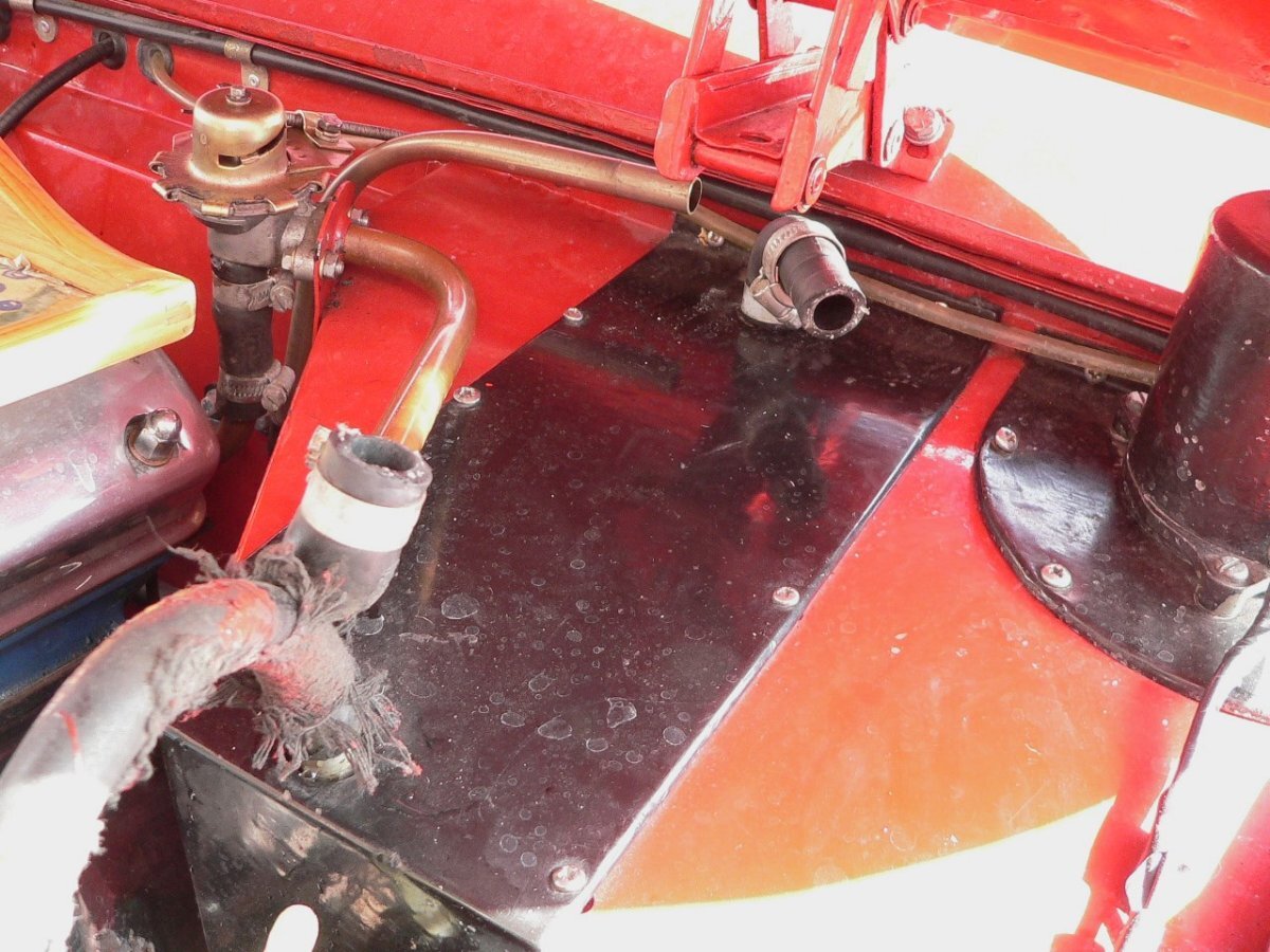

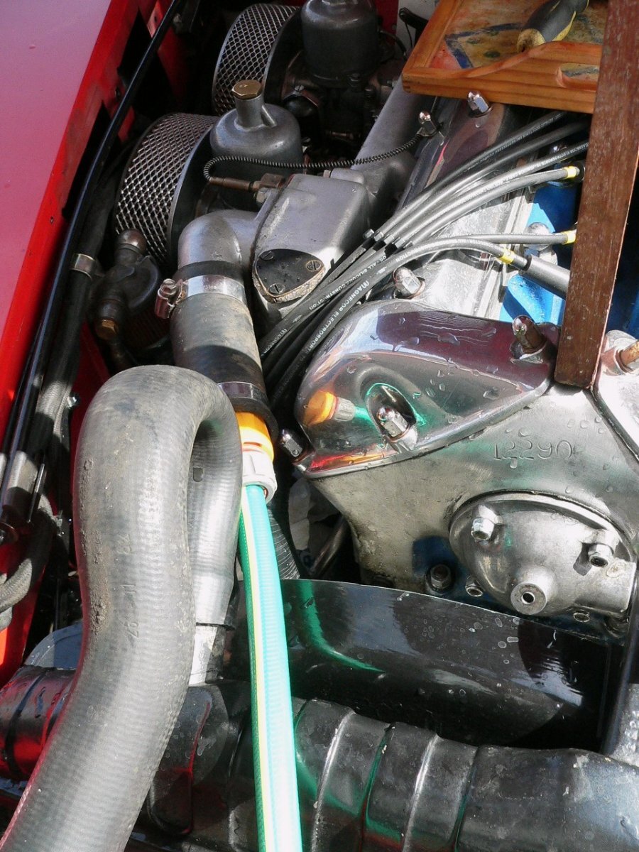

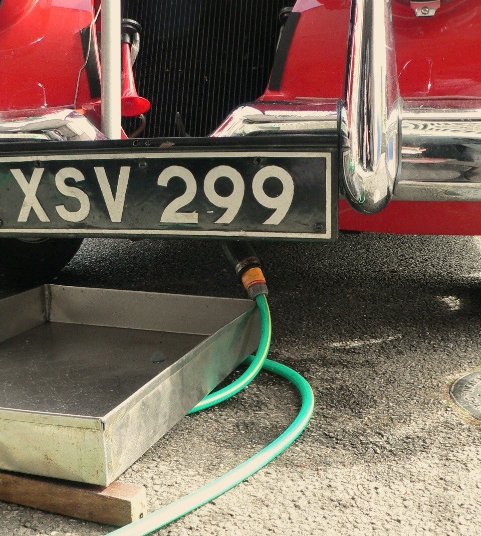

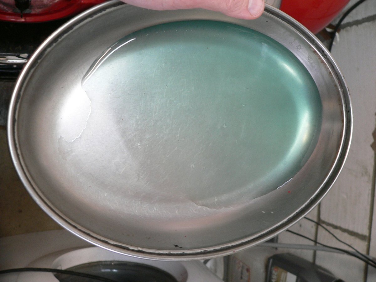

P1070635.thumb.JPG.53ef4a0c777e15325fc0f01a276f2a4b.JPG    P1070636.thumb.JPG.8176479b7e8145ddcb84cea826822d1f.JPG    P1070637.thumb.JPG.be2f86edb4e22ccd63638594e3b68947.JPG

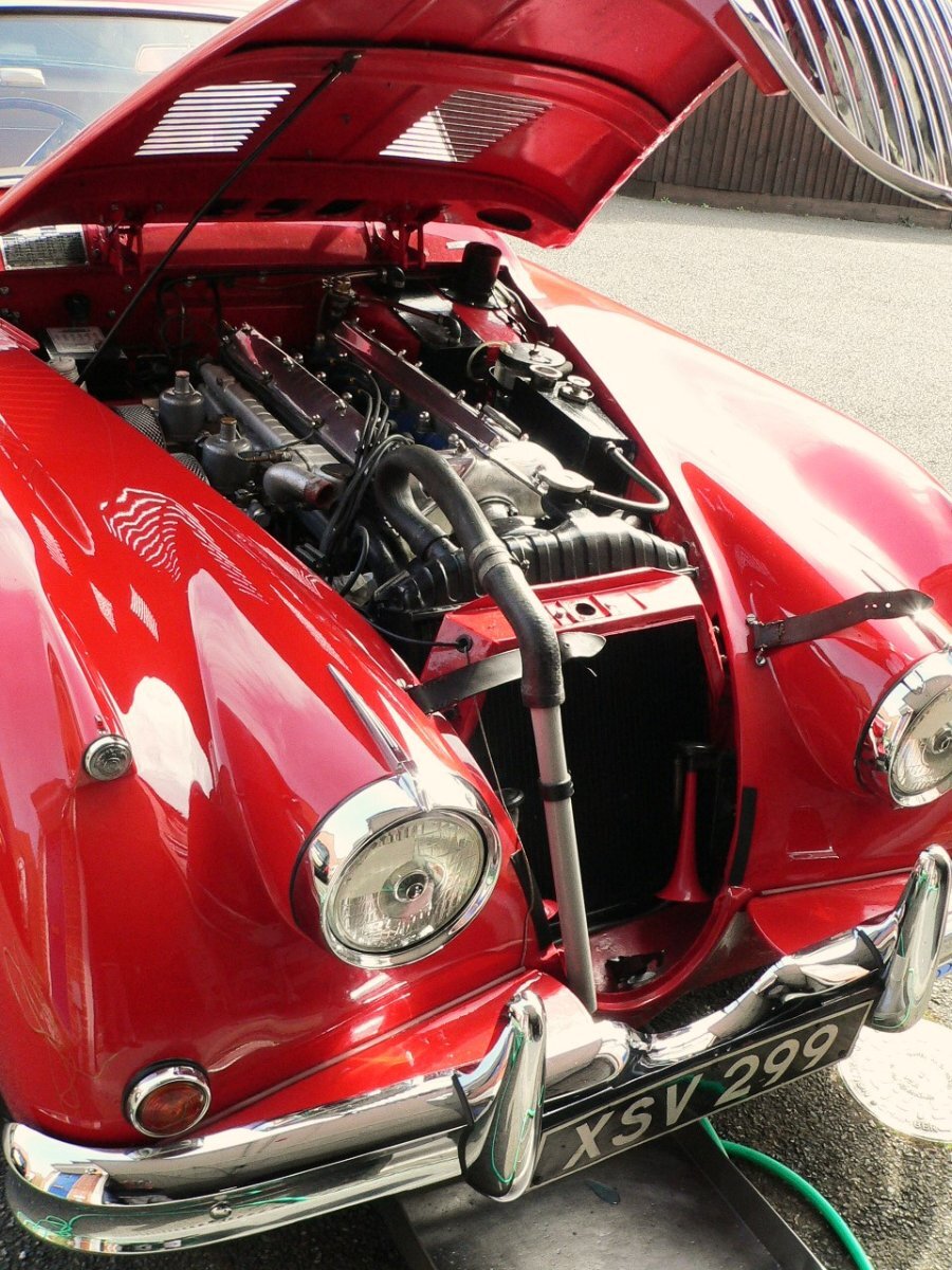

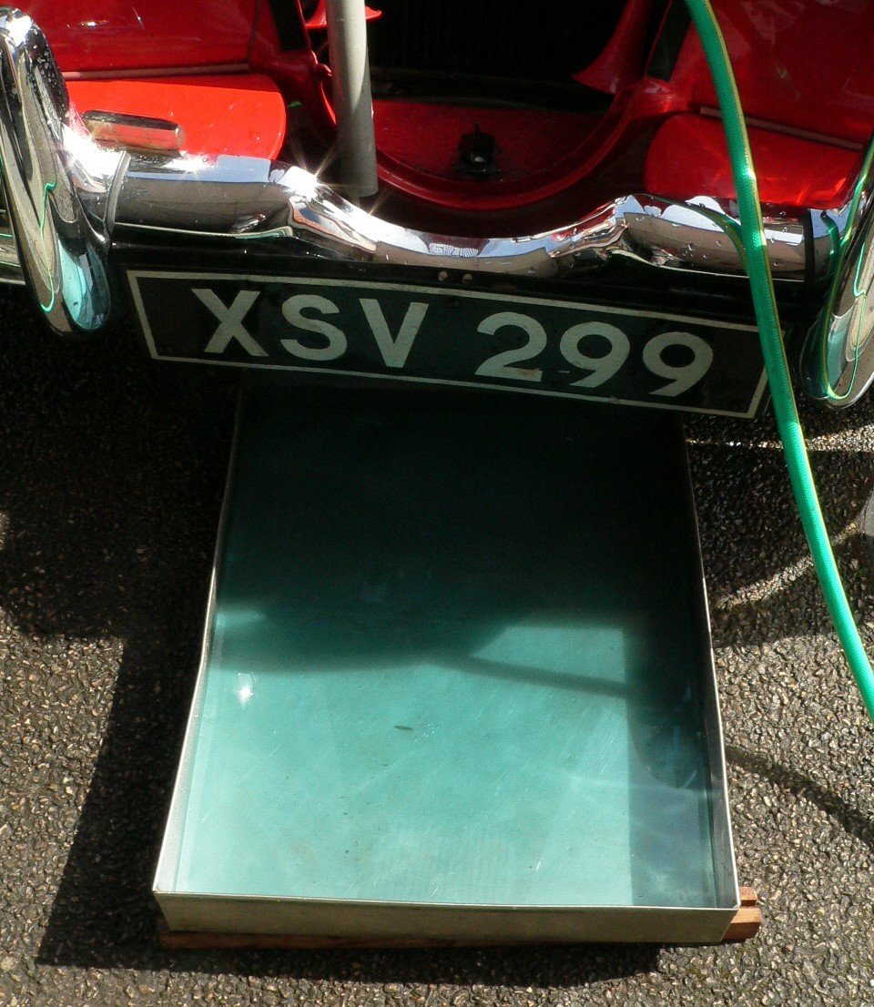

^ After draining down the blue antifreeze, which I had used last week, I twisted the radiator's bottom hose around and connected the garden hose pipe to it, using the hose pipe's clamp to gently clamp it in place.  The radiators top hose I temporarily replaced with an old bottom hose I'd taken off Katie's (my TR4A) engine (which I'd replaced with stainless steel between the rubber hoses).  The end of Katie's hose I simply extended with a length of vacuum cleaner pipe ..so water would be directed into the catch tray.  Btw., the distributor, which is situated under the top hose, was cover with plastic bags to avoid too much moisture pouring over its electrics.
^ Back flushing (garden hose in the bottom on full pressure) I thought might have lifted some of any contaminates out of the radiator, but in fact very little came out.

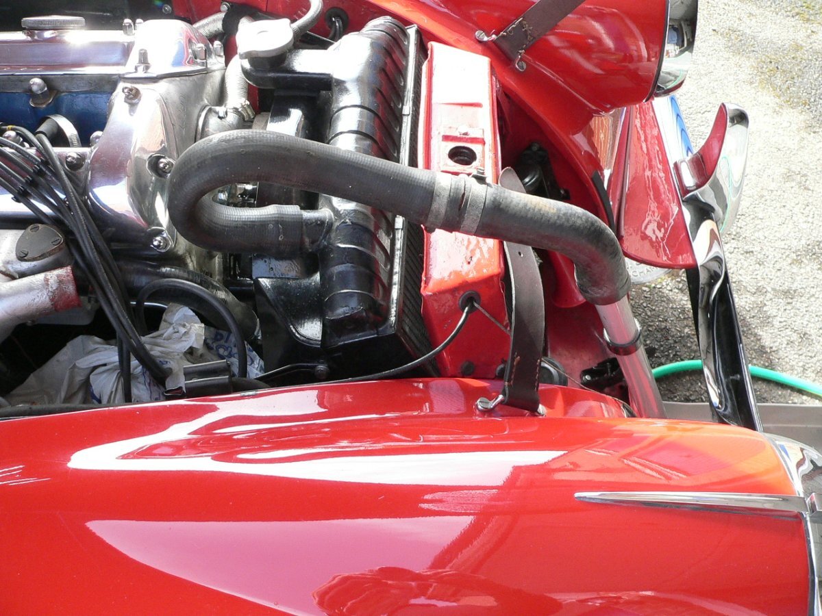

P1070656.thumb.JPG.c09312a9da4f20ed2759306717cd90ba.JPG    P1070651.thumb.JPG.17480ad5d49d2361c31440b4421dd209.JPG
^ Having drained the radiator, by removing the engine's bottom coolant hose, I hadn't expected much to be inside the engine itself.  But back flushing into the thermostat housing (with thermostat itself removed) issued a pool of clear blue antifreeze in the catch tray,  But for just a few very small blobs of purple gel, it was again free of debris and contaminates.
This however was a lesson for me .. because I hadn't back-flushed the block last week, when I switched from the pink (HOAT) antifreeze to the blue (IAT). . . I might assume the prior-owner or mechanic likewise hadn't when he drained down the radiator and refilled it with the pink antifreeze.  The blue antifreeze within the engine's water jacket hadn't been flushed out - which in turn led to the chemical reaction (gelling) between the two different types of antifreeze.

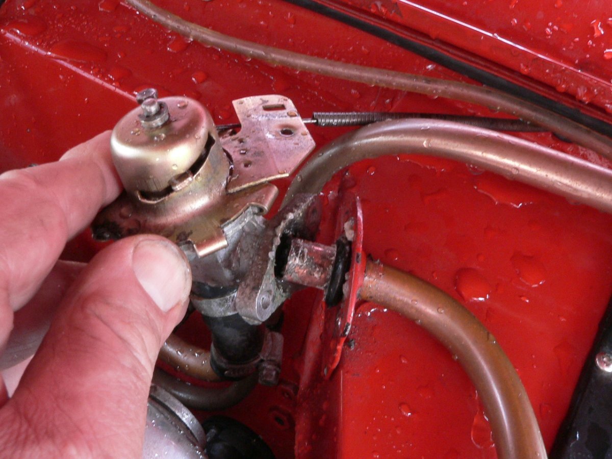

^ Next up I wanted to check the car's heater matrix, as it's likely that it too hadn't been individually flushed out.  I was right.  I'd disconnected the heater's hose connections and replaced the feed pipe with the length of petrol tank breather pipe I'd not long ago replaced.  Again, the piece of vacuum cleaner drain-pipe directed the flush down passed the exhaust manifolds and chassis into the catch tray.  Aside from just a few larger gelatine blobs, back-flushing the heater-matrix issued this green-yellow coloured coolant of gel slime particles. There was nothing hard nor very big but I've never been a fan of pea soup, and who knows what it might congeal into . . .
Neither pipe to the heater matrix would flush.

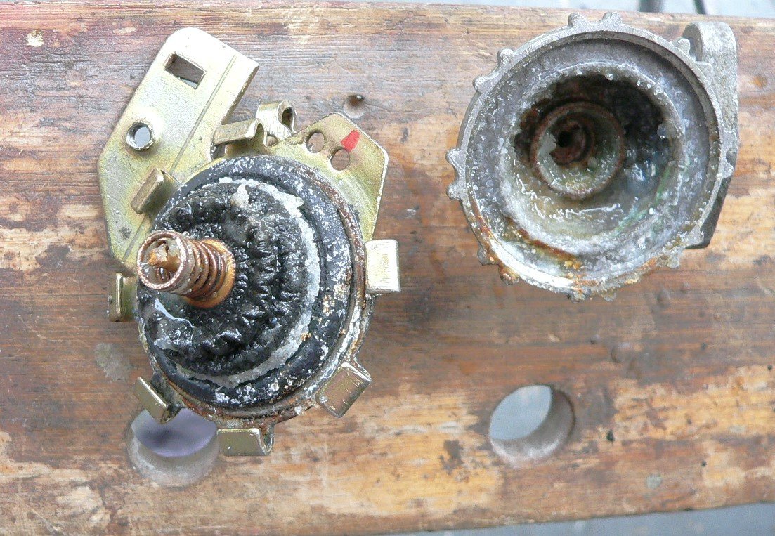

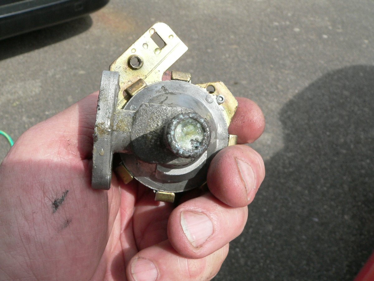

P1070665.thumb.JPG.2a4f163989c153a0b556c7f8bb308e14.JPG   P1070666.thumb.JPG.9afe1664366bf8ba59fa794b9e90bca8.JPG   P1070668.thumb.JPG.723d794187a9204bfc54f53f858a3a47.JPG

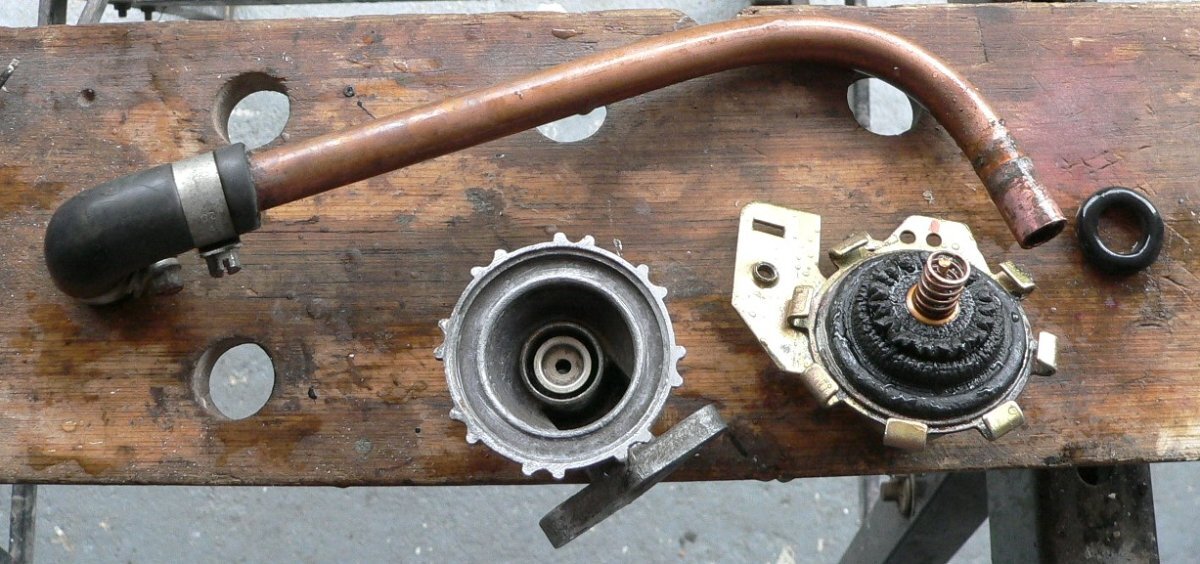

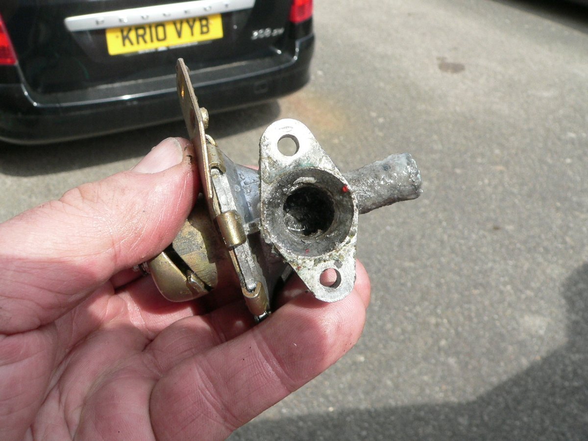

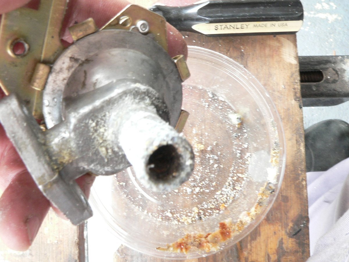

 ^ I pulled the heater valve and it was blocked.  Now I know the answer to  "I've never been a fan of pea soup, and who knows what it might congeal into ".
P1070671.thumb.JPG.9f6fc154ac9077a7ae42d8519e8b75cd.JPG   P1070675.thumb.JPG.515704b5a7158ecee7d176a299795fcd.JPG
^ I first tried cleaning the pipe out with a screwdriver. The crud in there was hard and dry.  I know.. it's hard to believe that the car's heater didn't work !   The rivet seen at the top of this photo was drilled out, and then the two halves of the body twisted, to open the valve up.  Only then could I clean out its insides.  The valve's rubber diaphragm will need replacing as it's all shrivelled, but for the time being it appears to work and so the crystalline deposit was carefully cleaned off but otherwise it was left untouched.
P1070679.thumb.JPG.7bb2ef40c3302f73906ccdef322f80d7.JPG    P1070681.thumb.JPG.8e1e7dfb630b6b6dfb489ea249281fd0.JPG
^ It took a good while but the valve cleaned up fine (aside from the aforementioned shrivelled diaphragm), but the copper pipe was also solidly blocked. Full garden hose pressure didn't shift it, but the screwdriver did.
The other pipe, from the water pump, to the heater matrix also appeared to be blocked, but once I disconnected the bottom connection of that pipe from the pump it flushed through easily.  Even so, when reconnected, I still couldn't back flush though the water pump.  I don't know if that's usual or whether there's a blockage there.  As the pump will be changed next week, I left it alone and reassembled the cooling system's plumbing and refilled it with fresh tap water.

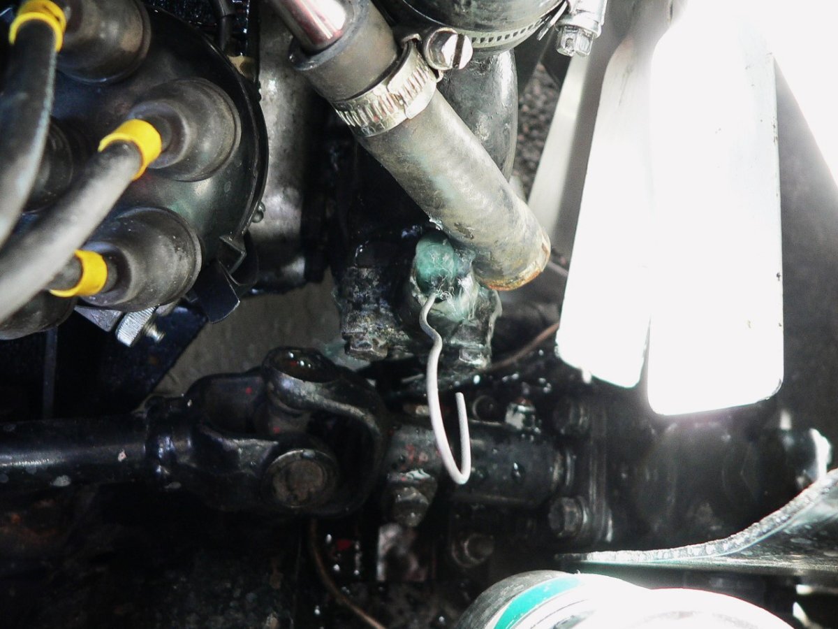

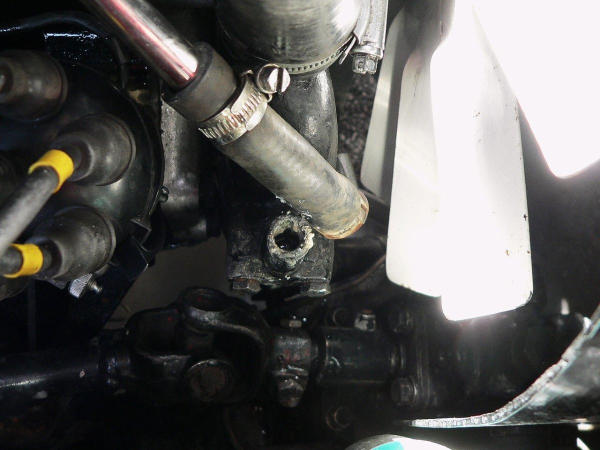

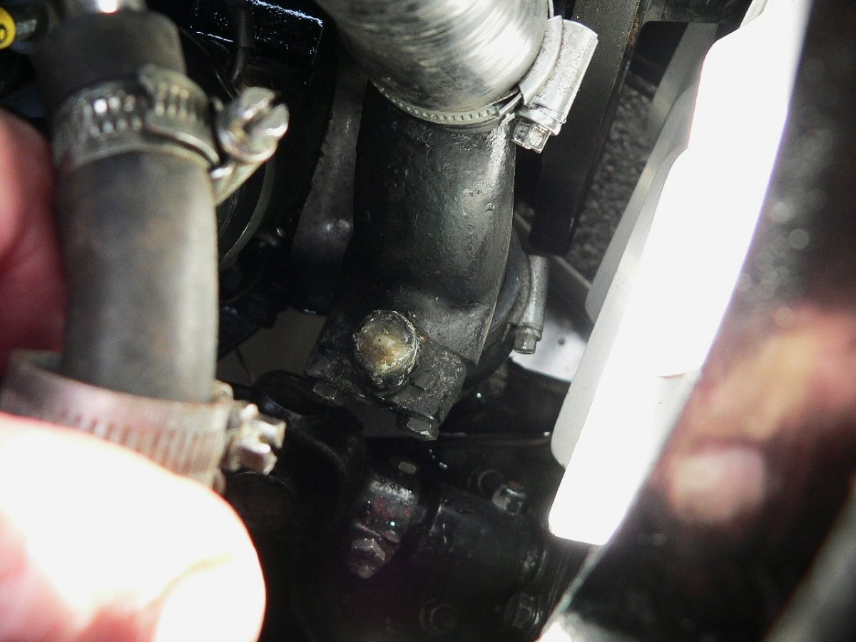

P1070695.thumb.JPG.f64af2484a24ee91aa376bd6fabc6ee3.JPG     P1070696.thumb.JPG.7e157fd48e4dbe0e19eca8e2a887576b.JPG

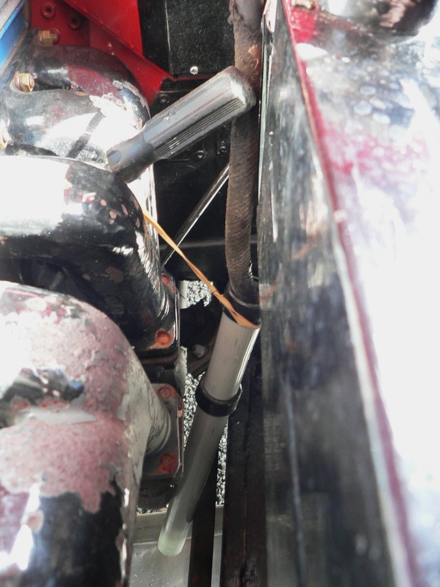

^ I removed the hose connection, of the heater pipe, on the water pump ..and although the rubber tube was clear - the spigot into the water pump was blocked hard with crystalline whatever.  Using a flat bladed screwdriver I got a lot of it out and although I could see wet in the bottom, no coolant was flowing out, despite the head of water of a filled radiator, filled top hose , etc.    I was going to undo the connector into the side of the water pump, but when I discovered the bolt's head sizes were different I thought better than to tamper with it.
P1070697.thumb.JPG.3adca82af862b9cb206b0b48e4f0ac8e.JPG     P1070698.thumb.JPG.8ecb0734a97907b07d80d0792a166693.JPG
^ However poking around with a piece of stiff wire broke through the incrustation and coolant flowed out freely.  I poked around as it was doing so to dislodge Klingons, before refitting the rubber hose to the heater.   Odd thing is that the coolant came out blue, despite my having flushed, and back-flushed the radiator and the block, and heater, and its pipes ..after which I've only refilled with tap water.  So, where was the blue antifreeze hiding ?
In topping up again ; I now added Fernox F8 to the water.  The manufacturer's instructions says the half-litre contents of this bottle is good for a central heating system of 130 ltrs.  My car's coolant system is 13.5 litres so logically 1/10th of the contents should do the job. Instead I measured 2/5th (200ml) into the car's water.

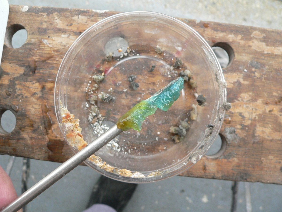

^ I also added a squirt of the stuff to the small catch trays with the bits in it. The blue bits are from the heater valve, the pink bits are from the radiator flush.  I've stirred the Fernox in (it has an orange tint to it like strong pee) and have gently heated each on the cooker ..to simulate a central heating system or the car's cooling system. I'll now monitor those over the next couple of days to see if I can see any breakdown of those bits.
I've just driven an 18 mile, round trip, to the boat and the car's heater now works ;)   I stopped for a leisurely coffee ..to allow the car's water-fernox coolant to settle again.  And then I stopped for groceries on the way back ..to sit in four o'clock Friday afternoon commercial / industrial estate traffic.

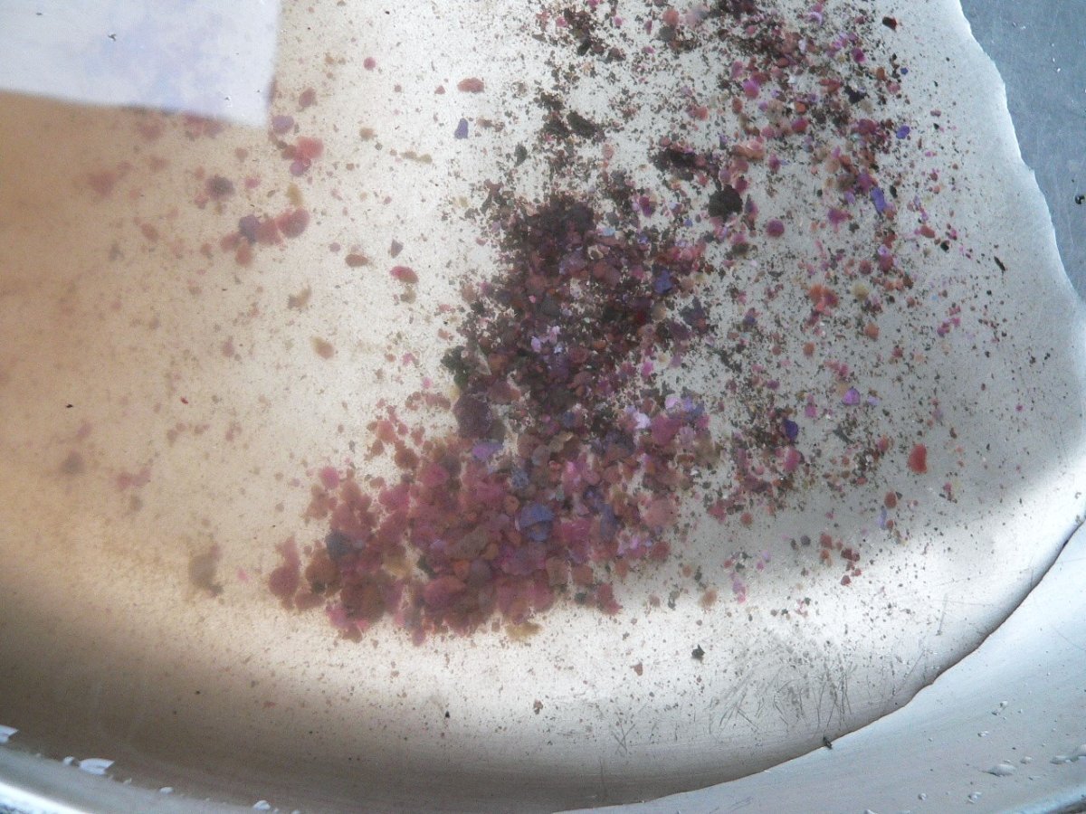

After flushing and back flushing both the radiator and engine block, and then also the heater circuit separately (removing specific pipes) - I'd refilled the car's 13 ltr cooling system with 200ml of Fernox F8, to help clean it out..  As recorded, I also added a squirt of the stuff to my stainless steel catch trays with the bits of the antifreeze contaminates in it. Additionally I added a spatter of fresh solder to each tray, because I reasoned that's probably the softest metal in the cooling system ..and if that showed visual or tactile signs of deterioration then I'd be wise to quickly flush the Fernox out.    After seven days of occasional heating and light agitation of the water in the trays - this is what I have. . .

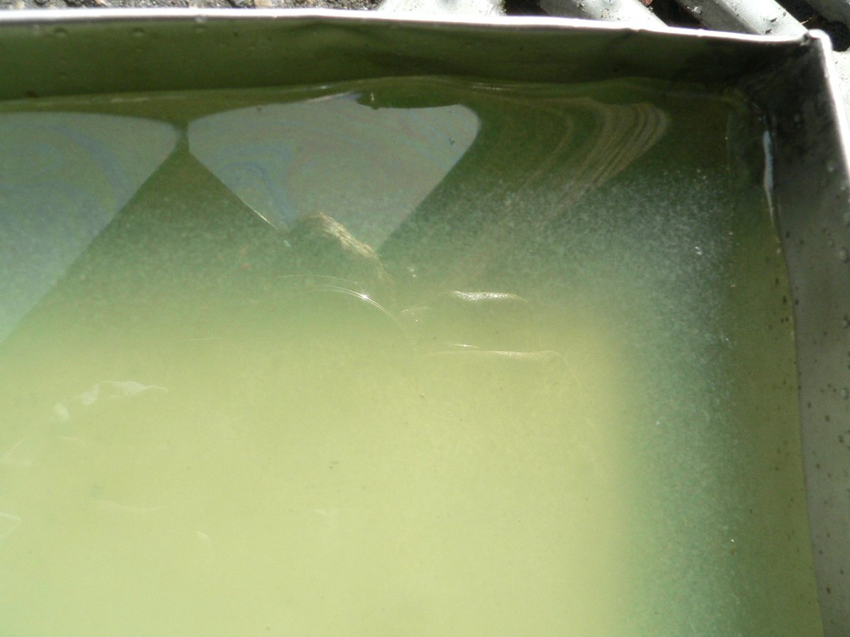

P1070702.thumb.JPG.e2e91e2f3d7c4fa65f82bf7883522f04.JPG    P1070756.thumb.JPG.de1ac695970e1468c825530f2c81bea8.JPG
^ Before and After 7 days in the Fernox-water mix.   It's really difficult to take comparable photographs without exactly the same lighting through the kitchen window, but still ; I hope you can see that in each tray (the pink antifreeze contaminates in the foremost tray, and the blue antifreeze contaminates in the tray behind) is colouring what was perfectly clear water. The bits in each appear to be less gritty, but really the process is happening very slowly indeed.
Good news is that I cannot see, nor feel, any deterioration of (even any less sheen from) the thin splatters of solder that I'd added to the mix.  Accordingly I'm feeling confident that the radiator and heater cores are not being damaged.
^ I've just taken a sample from the header tank of the car's cooling system (into yet another stainless steel dish) and you can see that despite repeatedly flushing a week ago, and having driven 160 miles since, according to the odometer - the water has lightly coloured to the blue antifreeze.
I'm a little surprised that it's not in the slightest rust tinted, but on the other hand I'm happy that its so clear and clean.  According to the box of invoices that came with the car, this engine may have been rebuilt as recently as 300 miles ago, so perhaps the block's coolant jacket was chemically cleaned out at that time - who knows ?

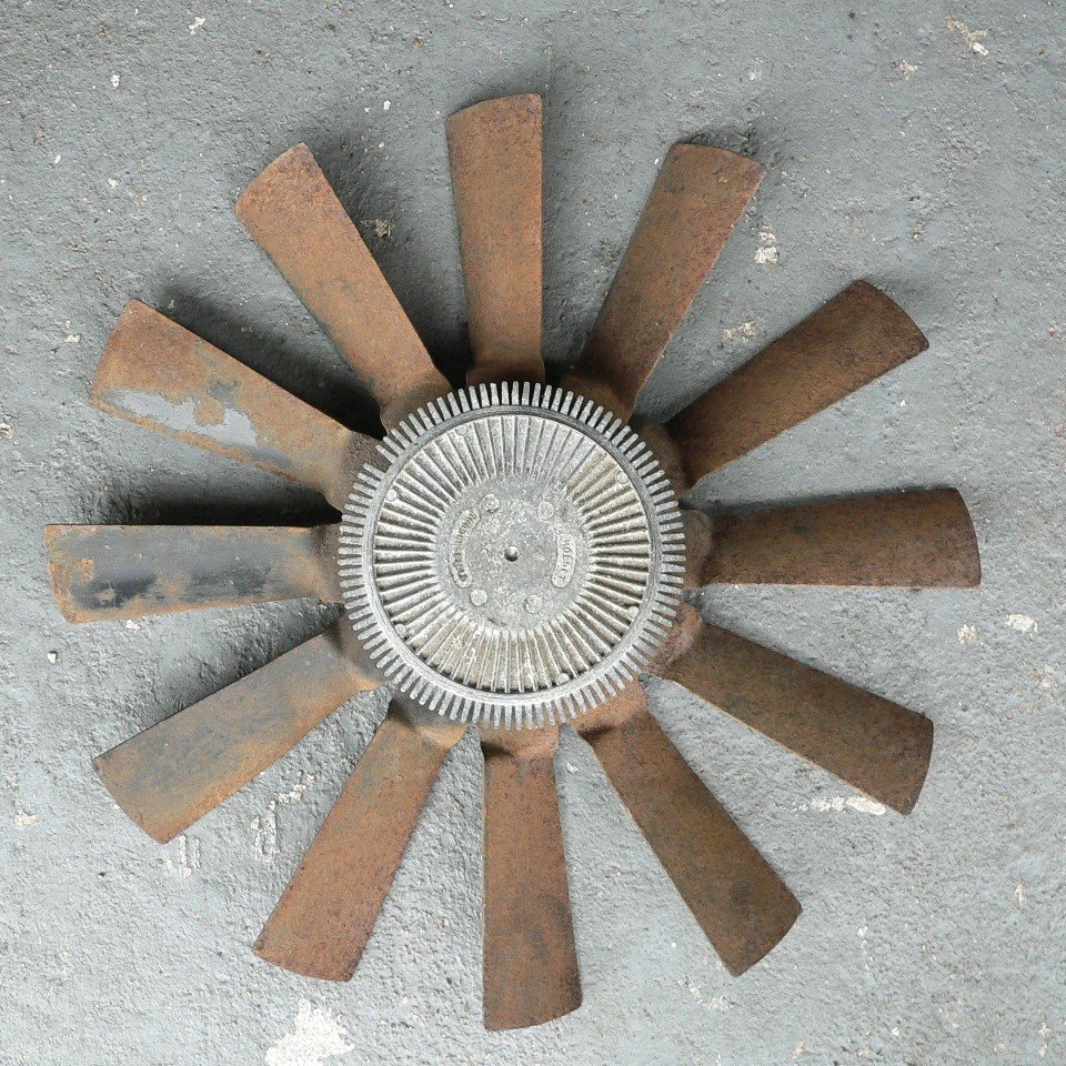

I also want to see if I can adapt a different cooling fan . . .

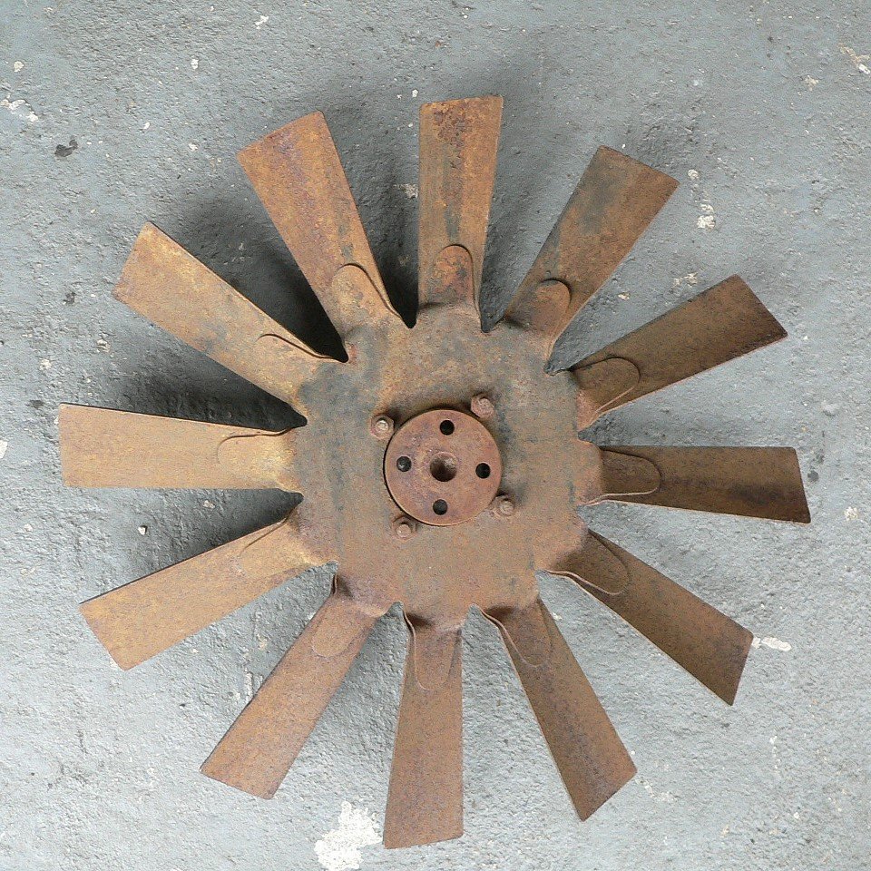

P1070727.thumb.JPG.1920d49b941d1278e9719ee56867ad3c.JPG    P1070728.thumb.JPG.099b632f7a6e2267bbb9f2e9167a1bc5.JPG
^ I've just bought this Holset of Huddersfield cooling fan ..from a Jaguar XJ6 - Series 1, off of ebay for £30 incl p&p, in the hope that with it being off a 1960's Jaguar ..its bolt pattern might fit.   It's a 12-blade steel 17" dia fan whereas the original (the fan presently fitted) is a 12-blade steel 16" dia.  But I do have a pair of tin snips.!
The existing XK150 cooling fan works very well indeed, regarding moving air at tickover speeds, but its blades are flat, whereas these have been pressed radially (along their length) to add aerofoil camber to their profile.  The camber stiffens the blades considerably, and then the root of each blade is supported by the doubler-plate (which the original XK fan doesn't have). The much improved stiffness will lessen blade flutter (very inefficient vibration) as well as well stabilising their tip clearance ..away from the fan's cowling.
At the moment I don't know if the viscous coupling will fit onto the XK150 crankshaft, but this fan's bearings seem to be smooth running and so naturally I'm hoping it will.  I had a viscous fan on my Daimler 250 and, previous to that, on the '66 Jaguar S-type - both worked well as cooling fans, and each was quiet through the range of normal engine revs.
From what I've read there are various sorts of fan couplings..  each with the objective of allowing the fan to freewheel when the engine is cold &/or as the car passes through the air ..whereby the airflow through the radiator is already there.  Some couplings are mechanical friction between surfaces, while others use a viscous fluid between surfaces or galleries to achieve the same.  A later development of this was, and still is, to use a thermocouple (sensitive to radiator and ambient air temperatures) to control the flow of that viscous fluid, to give more fan cooling when the engine is hot and very little during cold start and warming.  Later still of course the thermocouple switches an electric fan ..and no friction of viscous fan coupling is used.
Pertinent to each type of fan coupling ; According to Holset's US patent application " the torque required to drive a fan increases as a square function of the input rpm."

The reason I'm exploring this - is to lessen fan noise,  As wind noise through door and window seals is noticeable above 50mph ..I might only assume that, although difficult to define while driving along, fan noise is undoubtedly there.   Anyway..  it's fun to play around.
Pete
NB. from inside the engine bay you'll not be able to see the viscous coupling, as it's between the fan and radiator, so things will look close to standard.  Whereas an electric fan would not.
1 hour ago, BlueTR3A-5EKT said:
Is that viscous coupling a good one?
How do you tell without fitting and trying it. ?
If it were one of the thermocouple type then it should spin more freely when cold, and as I heat it up - I'd see if the couple between input and fan appeared tighter.  But, as far as I can tell, this one is the earlier type which has resistance in the coupling, of the viscous fluid, which remains (mostly) temperature stable / resistance unaltered until the torque overcomes the air friction at high rpm's ..beyond which it starts to slip.
I have also looked for signs of fluid leak, there is no indication that the coupling is now empty of fluid or otherwise has air bubbles within.
Perhaps the fluid within may also be somewhat non-Newtonian (aka Oobleck ..according to Dr.Seuss) whereby its resistance is greater at a faster (than hand turning) coupling speed.
I have heated this one, by wafting over its coupling with a blowtorch, and the viscosity / resistance within that coupling is then slightly less (as felt by hand), but I think that is to be expected and likely to be acceptable.  Although I've no prior experienced to judge - I'd anticipate that, even when hot, this coupling has resistance enough to not free-spin at lower engine speeds, when maximum cooling is required.
Without a proper test rig it's not easy to set things up .. to heat the coupling and at the same time to drive the fan up to the equivalent of 30 or 40 mph.
I've seen on the internet that you can test it by fitting the fan onto the vehicle, heating the cooling system and then shoving a rolled up newspaper or magazine into the blades to see if the fan stops.  That sounds like a rather dangerous idea to me.   So my only option is to fit it, try it,  and watch the temperature gauge after a run and is then sitting at idle ..to see if the gauge reflects the fan not pulling air through the radiator.    Do you agree ?
Edited by Bfg
If thats from a Series 1 XJ6 than they werent that reliable but often the default failure was for the viscous coupling to seize or they would just break off with subsequent rad damage.
Thanks Stuart, that's worrying.   I'd not heard of such issues befalling the Series 1.  Surely though that must have been a very tiny percentage ..and those which were prone to fail would have done so long before now ?
Agree with Stuart.  A common failure is seized,  I’ve never seen one sheer though.   TR7 Spitfire and other later Triumphs had viscous coupled cooling fans,.  The other common failure of the coupling was spinning free, identified by the fan not speeding up when the engine is revved. (Your newspaper test)
