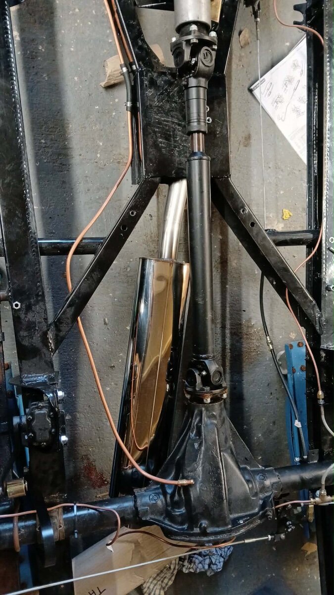

I am trying to fit a new stainless steel exhaust system to my restoration project. As loosely fitted the back end of the first silencer is fouling the rear axle tube, n/ s.

Where did the system come from, that is a regular occurrence with some of them, the first long silencer is just too long and the pipe to it from the front isnt quite long enough either, whats the fit like at the side of the gear box as well?
Hi Stuart,
I bought the complete system from Holdens, twelve months ago in readiness for the rebuild.
Here is a picture of the loosely fitted exhaust. It like as you said the silencer is either to long or fitted in the wrong place on the pipe.att.aR4y_EJEkRgOhC_hNK_JdftfcFTQysuE95UPwCNrLoU.png.thumb.jpeg.730b2836625d49d9dc7d8c3068fdaff7.jpeg
The fit by the gearbox seems ok but as yet I haven’t tightened up any fixings.
Graham
Graham
i think you have the box the wrong way around , a original mild steel one is a tight fit , so anything incorrectly made on a replacement will require modifications .
graham
I wondered if it was reversed. The front end of the box should be almost touching the chassis member.
Bob
I had a similar problem with an exhaust on an Italia, took a bit of careful moving around but got the clearance from the axle in the end though it was tight. There was no way it would fit the other way round either.
