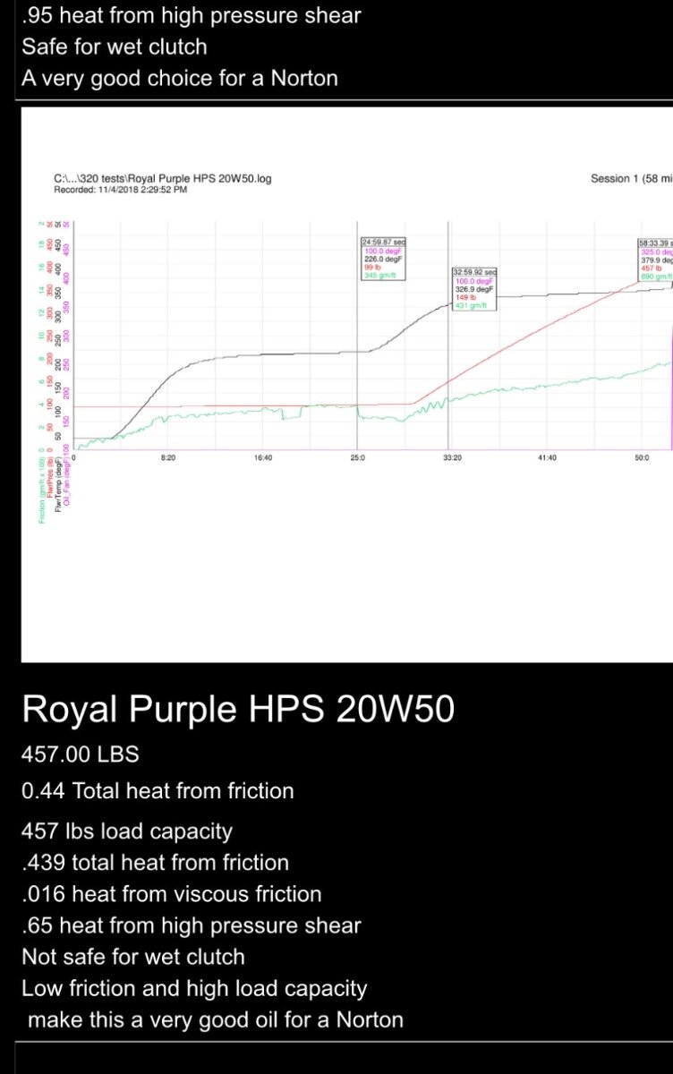

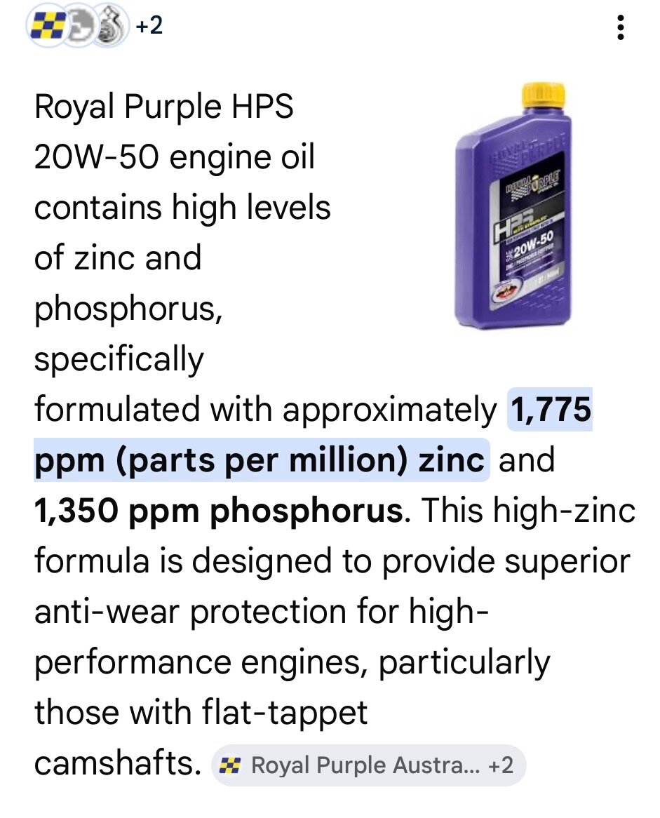

PriceLes Posted April 11 Report Posted April 11 (edited) Once my new engine (which got 4 packs of Penrite Classic in 12 months, whereabouts unknown) is run in it will get Royal Purple HPS 20/50. Although not an air cooled engine it performed well in Jim Comstock’s scar tests some years ago so should perform well in the TR if not better being water cooled. Edited April 15 by PriceLes Quote
