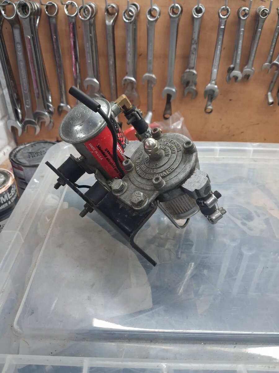

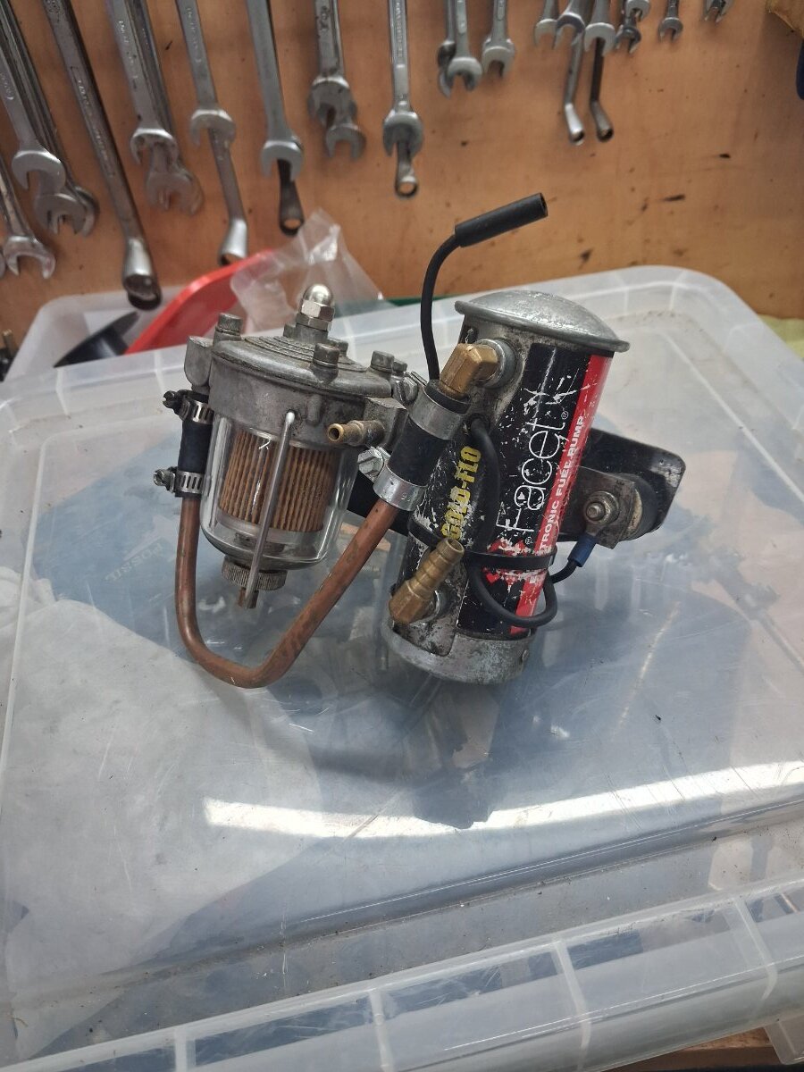

harlequin Posted April 13 Report Posted April 13 (edited) This is what I have used for 5 or 6 years, it's a Facet gold with a Malpassi regulator. It was mounted under the bonnet but I now intend to move it to either under the tank or under the rear near side wing. The pump is mounted on rubber thimbles and I've never had a noise issue. Stuart is spot on with his recommendation of the Malpassi regulator as its been faultless unlike the universal one it replaced. I have wired the pump through a Ford Focus impact switch from a scrap yard George Edit: It's been on the car from long before Covid so at least 10 years of daily use. Edited April 13 by harlequin Quote
