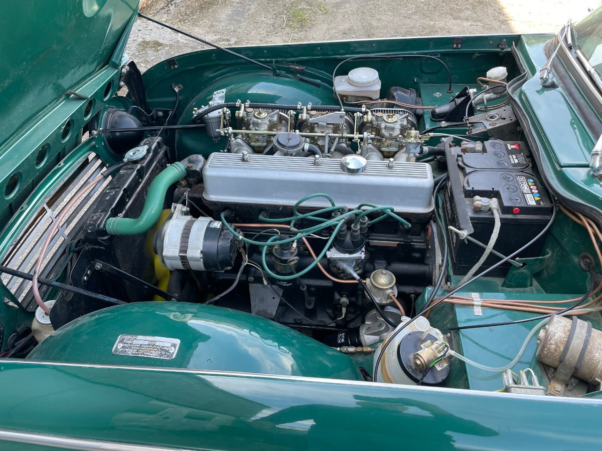

Yes Stuart, regulator fitted set to 3psi. Just see in in the photo.
Mesh filters are back on although guess that doesn't completely cancel out the hazard.

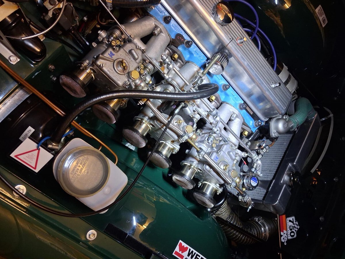

TBH I think thats the wrong place to mount that regulator as the engine vibration wont help for a start and those Sytec regulators arent as good as they used to be, I think you`d be better of with a Malpassi type bolted to the wheel arch like I had on my 250. See picture below. FWIW I do have a brand new one in stock.
Stuart

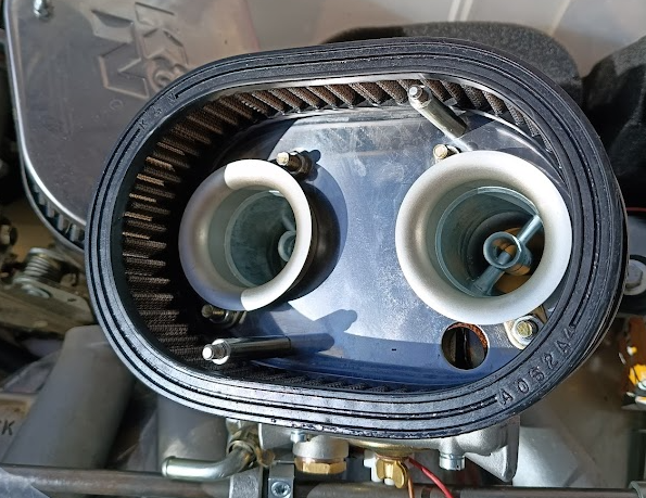

I notice you have the K&N ? air filters fitted on your set up. Have you installed them with the short trumpets?
If so does it make much difference to the airflow vs Bobs long trumpet install?

IIRC there wasnt any fitted, it still went like stink, cars long gone now and I believe the new owner took them off and put a pair of SU on instead ☹️

I run 12mm trumpets inside the K&N's on my DCOE 40's fitted to my GT6 without any issues, the car produces 192bhp & 165 ftlbs torque from its 2.5 lump, the fuelling must be ok 😀
