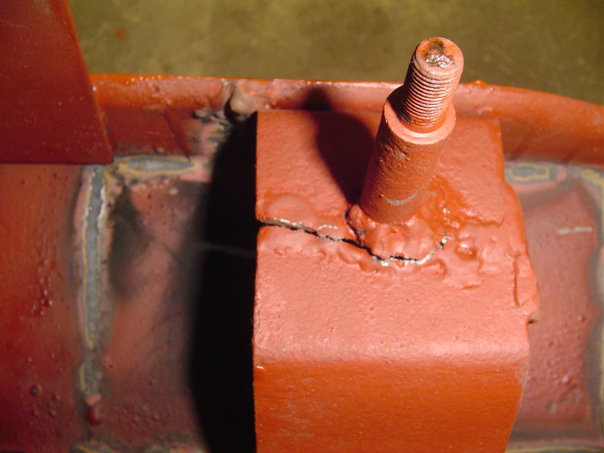

Phil Read Posted April 15 Report Posted April 15 The os rear front top suspension mounting has cracked. Is there a reinforcing kit you can buy or is it a DIY job? Quote

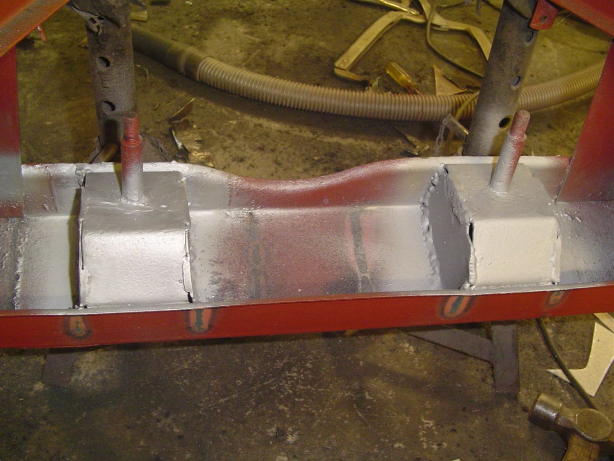

dave bailey Posted April 16 Report Posted April 16 Is this the bit you mean? Easy enough to fabricate some reinforcing plates. Dave. Quote

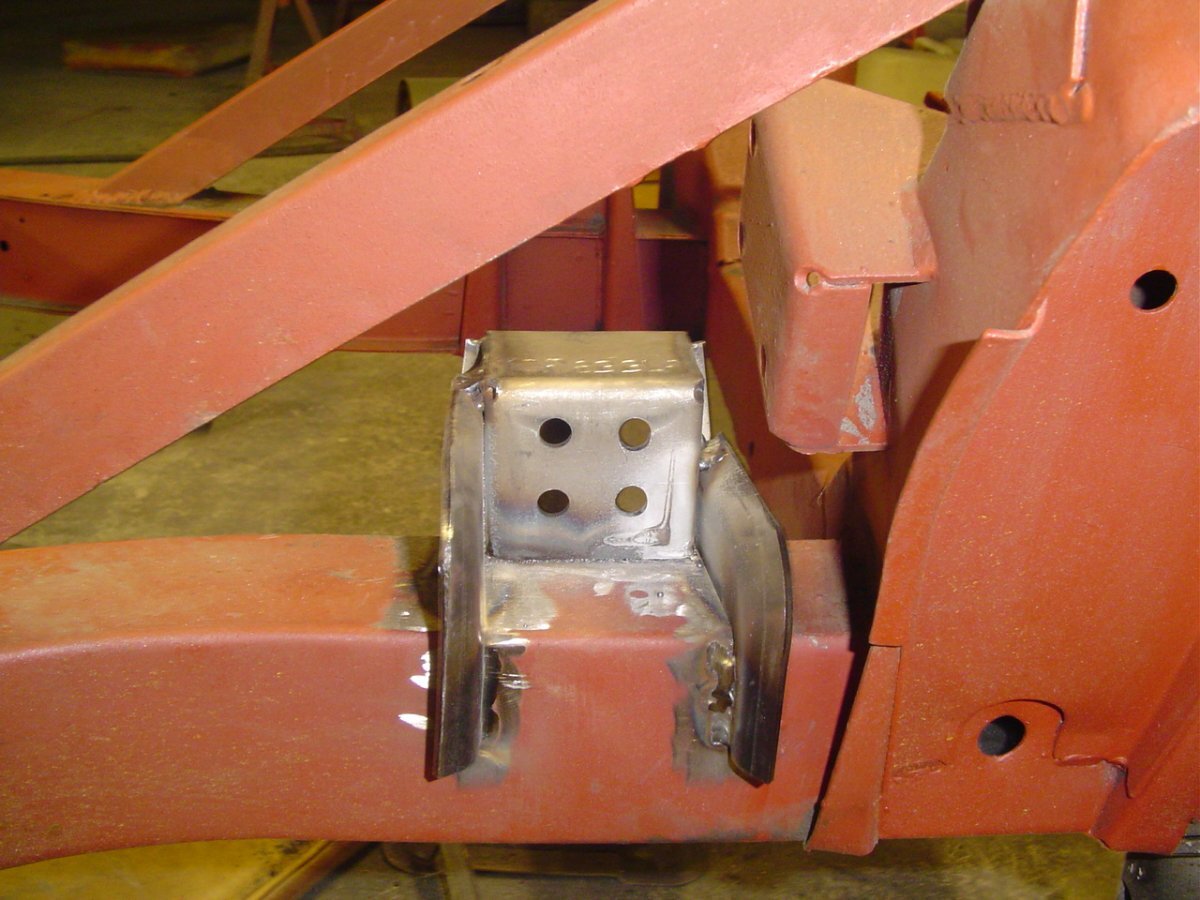

stuart Posted April 16 Report Posted April 16 I suspect it maybe either of these when they do this. Stuart. Quote

stuart Posted April 16 Report Posted April 16 19 minutes ago, Peter V W said: I think this is the part in question. Peter Fitted like this Stuart. Quote
Z320 Posted April 16 Report Posted April 16 I‘m on the front, this is the direction of driving (mostly)? There on the rear side of the coil turett, where the falcrum pin is bolted on? Quote
RogerH Posted April 16 Report Posted April 16 39 minutes ago, Z320 said: I‘m on the front, this is the direction of driving (mostly)? There on the rear side of the coil turett, where the falcrum pin is bolted on? Yes - the lower rear wish bone Roger Quote

Phil Read Posted April 16 Author Report Posted April 16 2 hours ago, RogerH said: I thought the PO was posting about the front suspension. Roger It was. Quote
Phil Read Posted April 16 Author Report Posted April 16 1 hour ago, Peter V W said: I think this is the part in question. Peter Thats the part, but I want to strengthen one in position rather than replace it. I have seen these from Rimmers, https://rimmerbros.com/Item--i-RR1422RH are they any good. Quote
stuart Posted April 16 Report Posted April 16 5 minutes ago, Phil Read said: Thats the part, but I want to strengthen one in position rather than replace it. I have seen these from Rimmers, https://rimmerbros.com/Item--i-RR1422RH are they any good. They are but not that easy to fit on a built car. Stuart. Quote

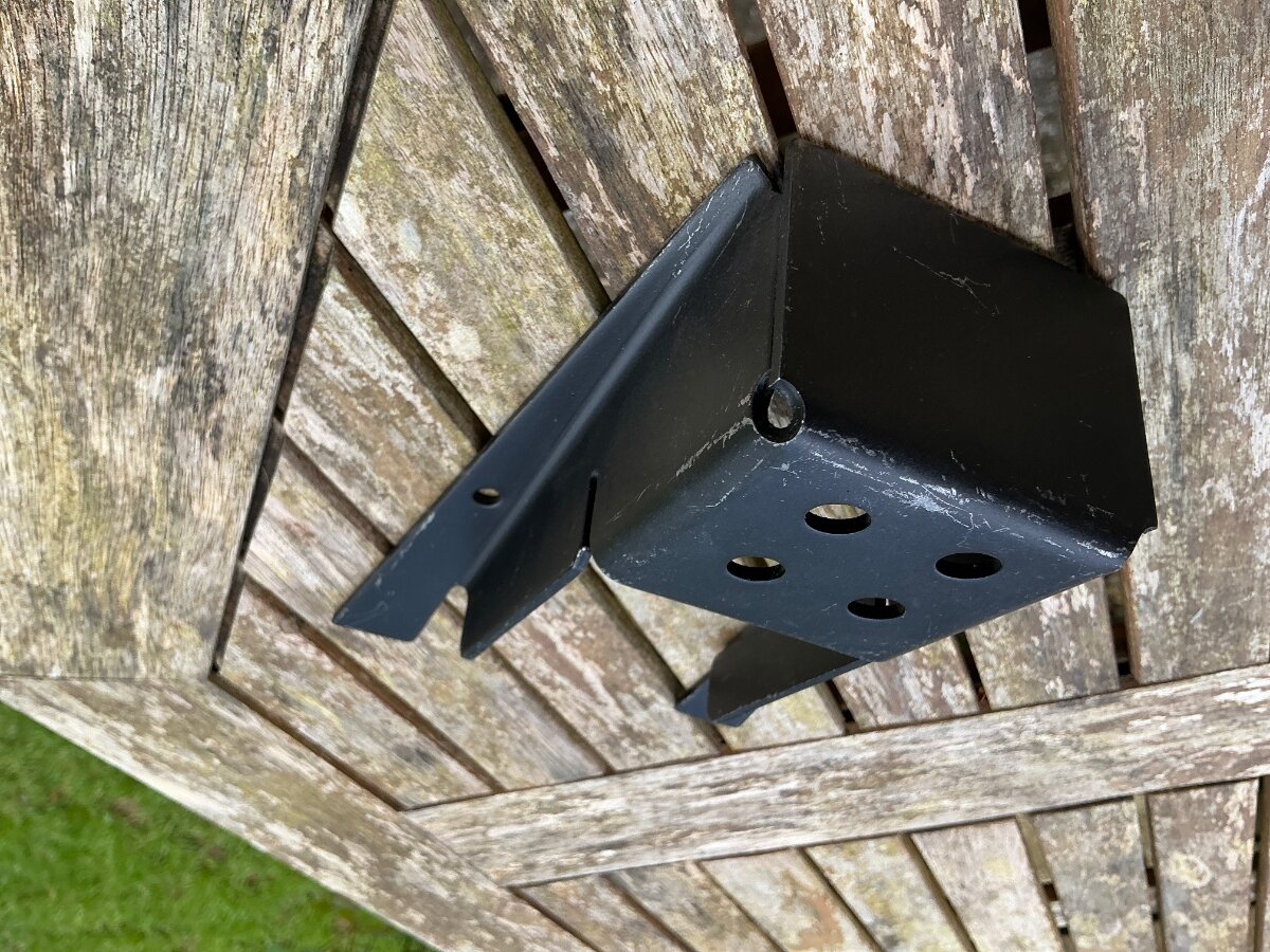

BlueTR3A-5EKT Posted May 3 Report Posted May 3 (edited) Kit of 3 plates per side or sold individually. Kit is a TT 3259 number with L or R suffix to suit left or right as you sit in the car. They are Standard Triumph factory reinforcements for 139580 the bracket photographed earlier in this thread. There is a factory drawing of where and how they fit somewhere I can’t find it in my ‘tech notes and bulletins’ at present. https://www.moss-europe.co.uk/en-gb/chassis-frame-tr5-6-1967-76-tr56--11--08--01 PS. I’d buy the Moss ones as they don’t look rusty unlike the Rimmmers ones linked to earlier. Edited May 3 by BlueTR3A-5EKT Quote
