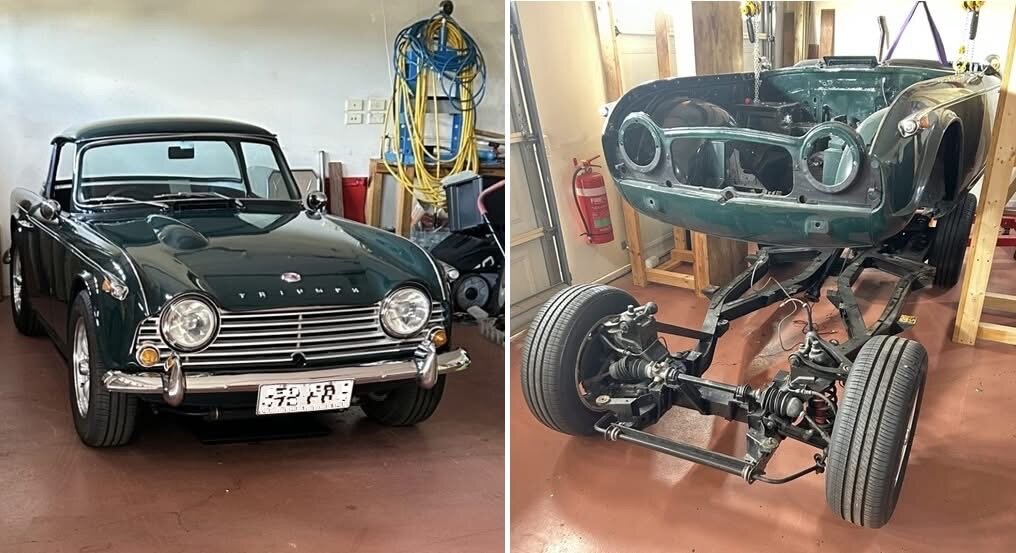

Z320 Posted April 19 Report Posted April 19 (edited) Interesting to see how you fitted the anti roll bar through the towing eye - and you have them on both sides? Edited April 19 by Z320 Quote
PriceLes Posted April 19 Report Posted April 19 1 hour ago, Z320 said: Interesting to see how you fitted the anti roll bar through the towing eye - and you have them on both sides? That is how the car came to me.It handles OK at speed but of course a horse and cart compared to my Mk5 GTI. I will make a new radiator guard to mount the bigger Good Parts front anti roll and also top hat insert the chassis rails for the GP rear anti roll bar. Quote
Z320 Posted April 19 Report Posted April 19 (edited) Interesting issue to get it in - or out again…? Edited April 19 by Z320 Quote
PriceLes Posted April 19 Report Posted April 19 I recall no problem removing it, perhaps the plates were bolted to the chassis (I am at work 5000km from home so can’t look) They will go in a plastic bin with all the other discarded stock parts. Quote
