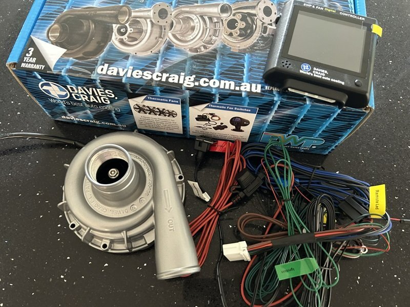

PriceLes Posted April 23 Report Posted April 23 Since the carburation is going, I thought I might as well add a digitally controlled Davies Craig electric water pump along with their electric fan. Of course, there is the chassis front tube brace to contend with which is in the location of the pump destination (The lower radiator hose) With all the added power needs (including a new sound system) the alternator will need upgrading. Quote

PriceLes Posted April 29 Report Posted April 29 (edited) I bought the EWP115 pump iirc and partly due to also getting a 89mm (2288cc) piston and sleeve kit, are the running hot rumours true is an unknown. Not much chance of cold weather in QLD having seen up to 39.5C on the cabin temperature gauge. Edited April 29 by PriceLes 39.5 not 30.5! Quote

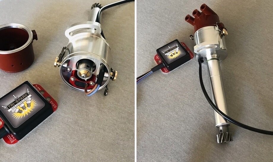

PriceLes Posted April 29 Report Posted April 29 (edited) I got the PM ECU controlled ignition option so will machine a new distributor body as I did for my 1973 Moto Guzzi to hide a digital ignition inside. (The cap was only for visual from a distance) For the Triumph it will be to simplify the body and separate the pick up and rotor to two compartments. Edited April 29 by PriceLes Quote
